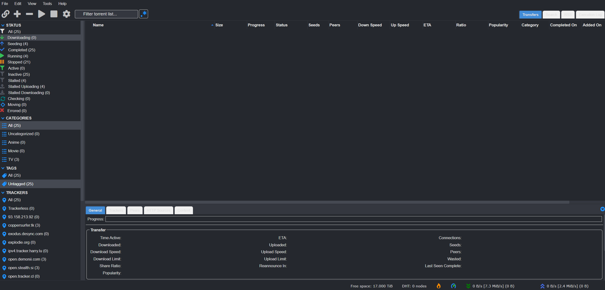

2 hours ago, aku_pod said:
i rly have no idea, i double checked my user/pw and the forwarded ports. I'm rly confused what could suddenly have changed.
If you can access the webUI then you are connected via the vpn.
Can you post a screenshot of what you are seeing in the webUI?
At this point using it is rly slow. Im note getting any nodes and the connection is marked as "firewalled" (flame icon) which confuses me even more.
Afraid I’m out of ideas.
all good, still thanks alot for your help!!! I kinda had a feeling from the begining, that ill have to go for a fresh setup.
