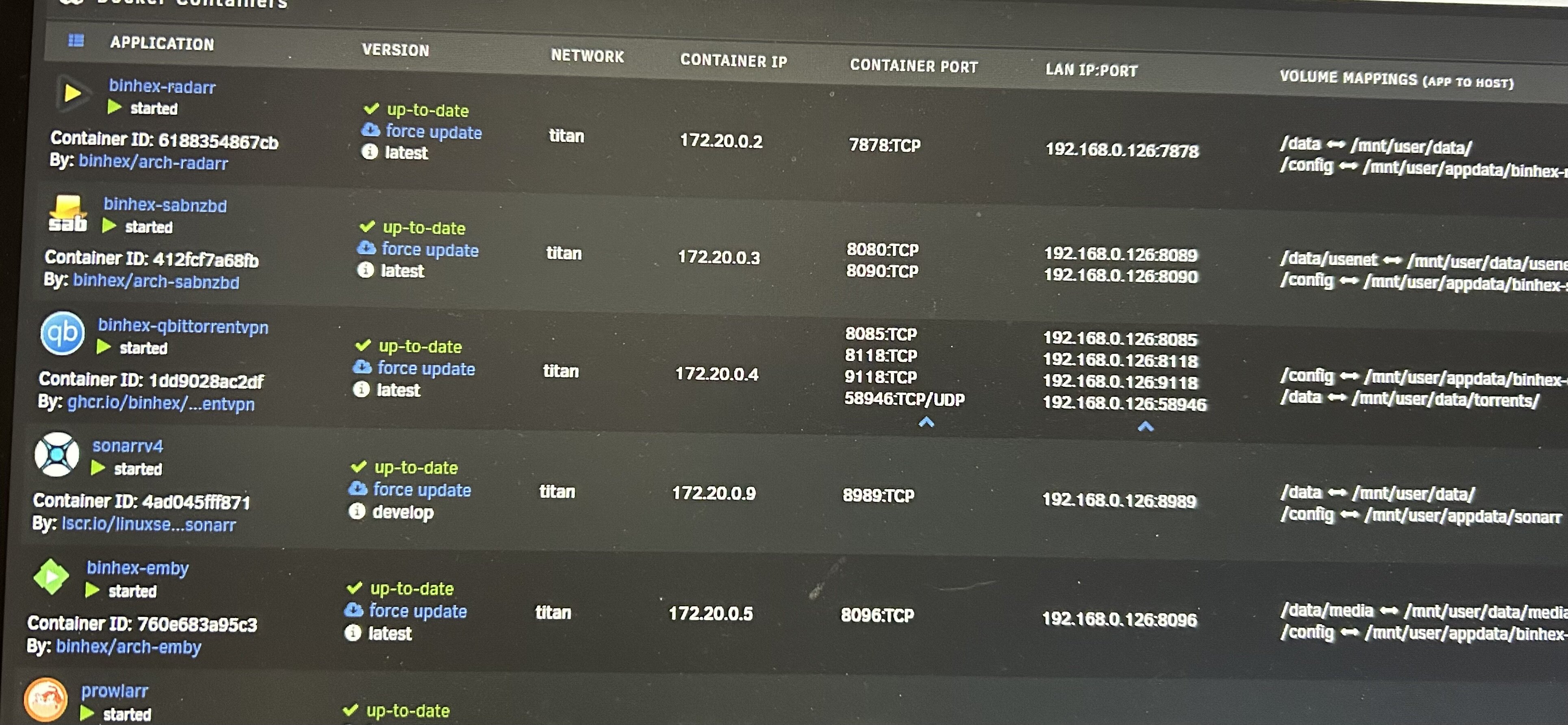

    Hello! I have been using wireguard successfully for a long time with this container, today though when the container restarted I got the following error: 2025-06-27 10:35:26,490 DEBG 'start-script'
Unable to connect
Firefox can’t establish a connection to the server at 192.168.0.126:8085.
I followed the instructions in 4th question of the qBittorrentVPN Docker FAQ
Please help!
Command_execution.txt supervisord.log
Edited by socbutter
revised Command_execution
15 minutes ago, socbutter said:
Unable to connect
Please help!
supervisord.qbittorent Command_execution.txt
Check Q4 sections 4 and 5 again. I don’t think you created port 8085:8085 tcp. I don’t see it in the run command.
Please review the updated files.
supervisord.log Command_execution.txt
Is your browser connecting to the webUI now?
The connection has timed out
The server at 192.168.0.126 is taking too long to respond.
And you are connecting from another machine on the same LAN?
My UNRAID ip is 192.168.0.126
My desktop ip is 192.168.0.105
Is this what you ask?

Hey! I've installed qbittorrent-vpn, and I can't reach the WebUI to even see if everything is configured properly.
Tried to disable the VPN, but no change. Logs looks okay, no particular warning, and the FAQ on Github didn't help.
Is there anything that I could try to have at least some insights on what I could try to get some informations on why I never can land on the WebUI? Thanks!
You’re going to need to at least post your supervisord log and docker run command so others can see what you’ve got happening. Be sure to redact users/passwords.

1 hour ago, Lacouenne said:
-p '8180:8080/tcp'
Just took a quick look but this may be your issue. I think you meant to map host port 8180 to container port 8180.
Everything seemed to be set to 8180 in my Unraid config page for this docker, so I just went the other route, changed another container that was already using 8080, and then set 8080 on qbit, I can get to the login page of qbit now 😅
Not really the way that I like to fix things, but I have so little time to focus on this that I'll take it as a win. Thanks, and maybe see you soon when I'll run into the next issue!
