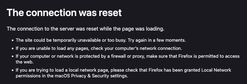

    Hello! I have been using wireguard successfully for a long time with this container, today though when the container restarted I got the following error: 2025-06-27 10:35:26,490 DEBG 'start-script'
Whelp, here I am again after enabling the VPN. Again, I can't access the WebUI at all.
I had a "the gateway does not support nat-pmp" at first, I recreated a wireguard conf as recommended on another post. And I can't seem to find an error in the log. Is there anything out of the ordinary?

The webpage isn't loading at all
And you are accessing from LAN?
Yes, from my home network. Same as I was testing when VPN was off
If you can access the GUI with VPN set to Off but not when it’s On that usually suggests that either the LAN Network is misconfigured in the docker or you are connecting from something other than LAN (guest network, WiFi network, IoT network, etc). What is the IP you are connecting from?
Oh ok so how it looks exactly:
Internet router --LAN--> Unraid server
Internet router --LAN--> EERO Wifi AP --WiFi--> Laptop
I'm trying to connect through my laptop. Which IP do you need? Local? Of which device?
Edited by Lacouenne
The laptop IP.
Local is inet 192.168.4.85
That’s the right network. Afraid I’m out of ideas.

I am flummoxed. I cannot figure out what I do that fixed a problem that seems to be happening when I restart my server or complete a firmware update. Both scenarios. Here's what I have...
UNRAID v.7.2.2
Running binhex-qbittorrentvpn with PIA and Privoxy enabled (has worked, does work most of the time)
I am unable to access the WebGUI with vpn enabled after restarting the server with our without a firmware update. Logs do not show any errors. I get the usually connections and resolutions I would expect. But GUI no Loady.
When I deactivate the VPN and set enabled to No, I can log in just fine as expected. I have restarted the Server, my PC, the network. No joy. I know I have fixed this before, and most recently it was last week it "fixed itself". But I have no idea why it is happening on restarts, what I am doing to fix it, or how to prevent it going forward.
I tried removing the images, and using their templates.
I replaced the ovpn files with new ones from PIA.
Using port 8210 and have a WebUI_Port Variable setup and the Web Interface Port configured as well.
Have the Lan_Network set to 192.168.0.0/22
HAve this in Extra Parameters: --sysctl="net.ipv4.conf.all.src_valid_mark=1"
No Input Or Output ports listed either.
Debug set to true
At a loss on this and could use some assistance. What other information can I provide for anyone to see what I am not?
Maybe something to do with Tailscale? Using local IP to access qbittorrent while local PC as part of Tailnet? How would rebooting and firmware changes affect both devices on the same Tailnet? Currently both IPs (local IP and Tailnet IP with the port work to access the WebGUI. But I have no idea what I did to make it work.
Also, updated the container to pull the :latest image. Running qBittorrent v5.1.4 WebUI (64-bit)
Edited by danimal_0119
Created by...

Can't access WebUI. PIA VPN. Long time user of an older container which started having the issue, installed this newer binhex version to troubleshoot and have the same issue. WebUI works when VPN_ENABLED='no', which makes me think it's a VPN connection issue.
Changed VPN password, verified credentials on other devices, changed OpenVPN files. Looking for options here. Thanks!
supervisord.logdocker run.txt
EDIT: I am using Tailscale on the server but not in the container. I keep getting an activity timeout from the VPN server every minute, and the process seems to restart:
I just had the same issue. The VPN was not connecting or connecting inconsistently. Are you running Tailscale? I found it I had an advertised route that was messing things up.
