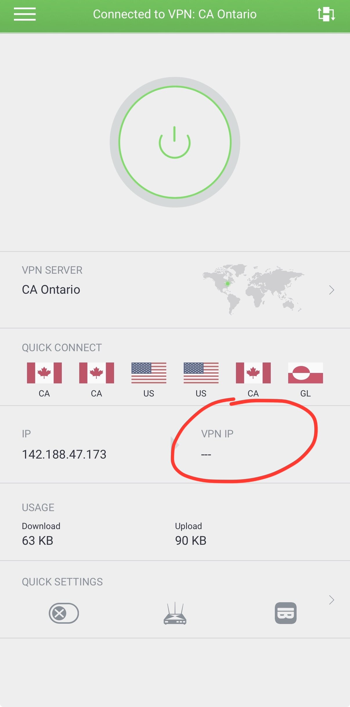

I noticed that on my iOS app, I can connect but I don’t gat a VPN IP displayed on screen:
Does supervisord.log show an error with vpn set to on?
