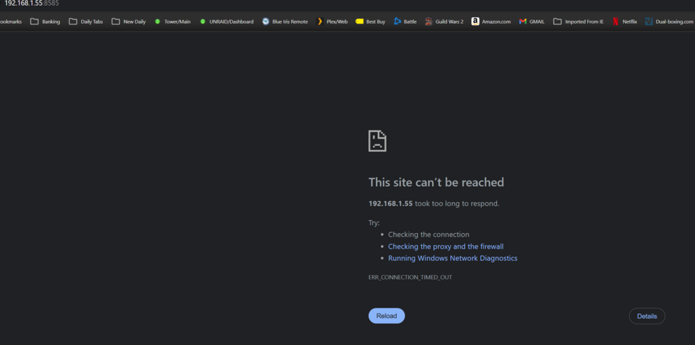

But I am getting the error below, shoudl I not be able to get to the web-ui regardless?
If you have VPN enabled then the qbit app will not start until it connects to the endpoint. Without any logs or a docker run command it’s hard for others to know what’s going on.
below is from the log, I am using the most recent docker, I changed the qBittorent IP in the log to 99.99.99.99 for privacy:
[debug] VPN IP is 99.99.99.99
[debug] qBittorrent IP is 99.99.99.99
That doesn't look right.
And no as mentioned the webui will not come up if your VPN connection fails.
the IP shown is what I updated, the correct IP for the VPN shows correctly in the log.
I too am unable to see the webgui, unraid has not been touched for weeks. The VPN/proxivy connection still works here as far as I can see/test, but the webgui is not showing up?
well I finally got the WebUI working, but only with the VPN turned off. I use Private Internet Access, I have downloaded the OpenVPN files from their site and put them in the OpenVPN folder and from the logs it looks like it connected and was assigned an IP, but the WebUI still gives a page not found error.
Thoughts? What should I be checking on the VPN side to make sure everything is working?
Are you accessing the webUI from LAN?
Attach your supervisord log and docker run command to your next post. Be sure to redact any users/passwords.
I finally got it working, I changed Variable: LAN_NETWORK: setting to my network range and now it works, default was 192.168.1.0/24, I updated it to 192.168.1.2/24 .
That is the only thing that got it working for the WebUI.
Meaning that it should be 192.168.1.0/24, not 192.168.1.2/24. But it probably fixes it in the background.
With 192.168.1.0/24 the WebUI was getting page not found, whereas changing it to 192.168.1.2/24 fixed the issue and WebUI works. I am not sure of the reason why, only that it works now. Could it be that my gateway is 192.168.1.1 and so the router did not like having it's IP address included in the IP range?

On 3/11/2026 at 12:12 AM, wgstarks said:
I don’t use Proton so perhaps someone who does could give you better info but this jumped out at me from your log-
[info] ProtonVPN username 'unused' does not contain the suffix '+pmp' and therefore is not enabled for port forwarding, skipping port forward assignment...
If you have force port forwarding set and it fails then the qbit app doesn’t start IIRC.
Thanks, after disabling strict port forward I'm able to access the web UI. Unfortunately, the default login/password does not seem to be admin/adminadmin and I can't see any default password in the logs :(
