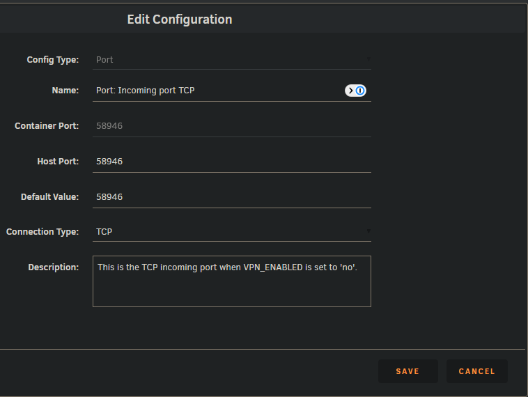

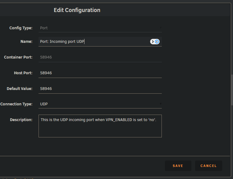

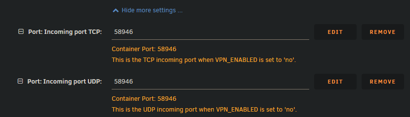

On 5/1/2026 at 3:23 AM, Tethgar said:
After updating to 7.2.5 the template no longer works for me, and throws this error:
docker: Error response from daemon: invalid port specification: "0/tcp"
presumably because of the docker update to version 29
I've narrowed this issue down to the port mapping for 58946/tcp, the broken configuration shows "-p '58946:000/tcp'" based on the error logs.
While troubleshooting I some how managed to remove mine completely, after I added it back in via "Community Applications" now when expanding the "more settings" no longer have 58946 showing the "000" ports and its now running again on 7.2.5. Hope this helps someone!
