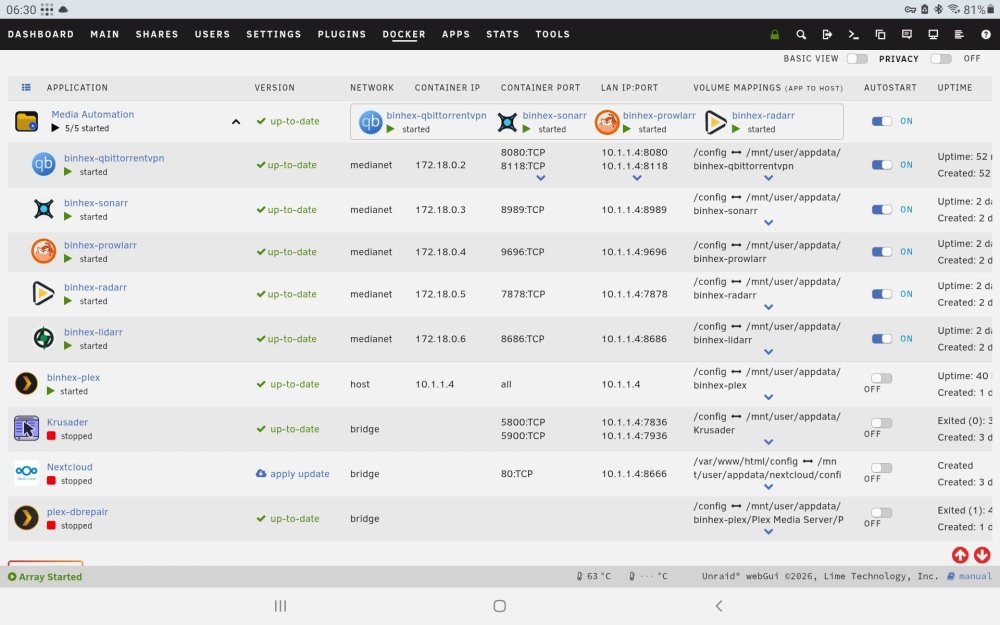

Problem
Can no longer get into qbittorrect via the GUI with the VPN enabled. Unraid shows it as running fine.
If I turn off the VPN (via the settings in qbittorrent) , i can then log straight in, and everything is working away, sans VPN.
Switch VPN back on - locked out of the Webgui from Unraid.

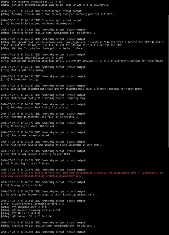

Attached is the most recent log screenshots from qbitorrent- but it all seems fine to me.
The error that throws is apparently a normal error code that doesn't impact anything.

I have also changed the network to bridge now
1 - The reason its in a separate docker network was on the advice following the Trash Guides setup to allow the arr stack and qbitorrentvpn to talk to each other better.
2 - Changing to bridge hasnt helped yet. - Just get the loading circle of death before it eventually times out

Your log show that qbit keeps trying to connect to PIA over and over. I suspect that it’s not getting a successful connection due to some problem with your wg0.conf file. I would try downloading a new one from PIA. That usually fixes this.
What I think you're referring to in his logs is actually normal. It's just the watchdog script checking if the connection is up/down, checking if the port has changed, and checking that DNS and iptables are working. You don't see it actually disconnect and reconnect in his log. So the vpn tunnel seems to be working fine, at least from what I can tell.

The log shows a successful start. How are you attempting to access the webUI?
this is the strange part - im no expert, but when i looked at the log, it all seemed fine to me also.
I suspect that everything is working fine including the arr stack ive setup.
Im accessing from the unraid dashboard, click on the icon, and select webGUI from the menu that pops up.
For some reason though, it is still defaulting to port 8080 when selecting the webgui from the unraid dashboard, howver, manually changing that to use port 8085 ends the same way (the loading circle fo death) which eventually times out .

How about if you try http://<hostIP>:<portnumber>
Edited by wgstarks
nope - no dice.
the most annoying part is that it worked before! on the standard port settings. then it didnt.
I have also rechecked that i can get to the webgui of my other apps - everythign else works - just not qbitorrent.
6 minutes ago, dolphinspanker said:
nope - no dice.
Afraid I’m out of ideas. Usually when people have this sort of issue it’s because they’re trying to login from outside the configured LAN network.
