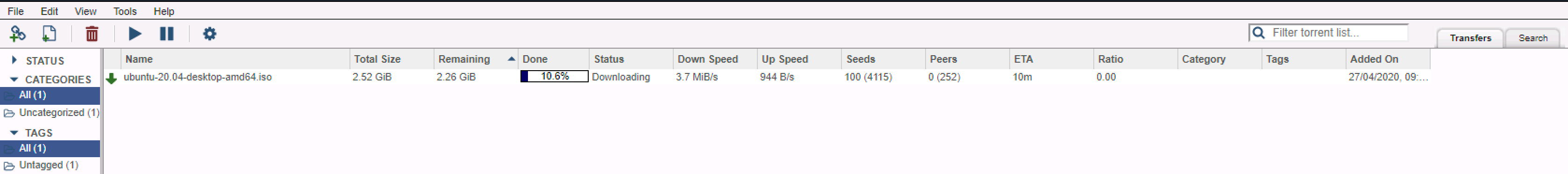

you guys have a configuration issue and/or vpn provider issue, just tested the image and getting a steady download rate, no stalling for me so im confident the issue is not related to the image, proof, my line maxes out at around 4.0 MB/s so this is pretty good considering vpn overhead:-
edit - download of the ubuntu iso finished no problems, total time active for 2.52GB iso - 12 minutes, speed dipped to around 3.0MB/s at points but always climbed back up. one last thing to say, this is running 'latest' image from a clean configuration, only things i changed was the incomplete and completed folders of course, im assuming you guys are doing this right?.
Edited by binhex

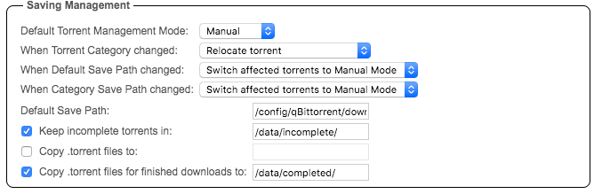

so to confirm what are your docker side settings, do you have a volume named /data and what path is this set to on the host side?
9 minutes ago, binhex said:
container data will only be whats stored in /config, the docker image itself (ideally up to date) will be exactly the same, its immutable so no way to pollute or corrupt it with user data.
I was in the middle of uploading several screenshots when I saw that the container volume mapping was /data/ (as it had been), but the within qbittorrent the /data/ location had changed to /downloads/.  After changing it back to /data and restarting it, it now works!
When or how did those settings get changed within qbittorrent?  I definitely didn't touch any of those settings.
i would suspect flip flopping between my image and the other qbittorrentvpn image and/or trying to fix issues with sonarr/radarr/etc not post processing correctly lead you to change it, i can confirm there is NO automation from my side of things, as i previously mentioned i do not set this, glad to see its the usual suspect of incorrect path or not configured path for incomplete and/or completed.

Hello @binhex and others,
I have been successfully using Sonarr+Radarr+Deluge for a while now, but for a variety of reasons I recently tried to switch from Deluge to qBittorrent. I have qBittorrent installed and can access it, download, etc successfully. However when I try to add as a Download Client in Sonarr or Radarr (or presumably Lidarr) I get the error "Unknown exception: Failed to connect to qBittorrent, check your settings." This is no doubt an issue with my configuration of qBittorrent because Deluge worked without issue previously, but I cannot figure this out. Could someone provide guidance?
Thank you!
