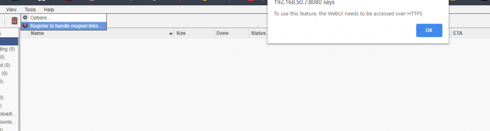

On 5/2/2020 at 11:17 AM, Highbird said:
Morning Everyone,
I've just setup binxhex-qbittorrentvpn using PIA and I'm able to access the web GUI and download torrents, however, if any of the links are magnet links, I can't access them, it refuses to even put them into the Transfers area. When I try to do "register to handle magnet links..." from the 'Tools' drop-down, I get the "To use this feature, the WebUI needs to be accessed over HTTPS" dialogue.
I've read through the entire FAQ, searched the forum and only found one person with a sort of similar issue and their fix was to add their subnet/hostnet to the whitelist under 'Authentication' in the 'Web UI' settings and I did that with no change. This is driving me absolutely mad and I feel like I'm missing something super simple.
Any assistance would be appreciated. Thank you!
Additional info: I am able to use the search, right click -> go to description page -> copy the magnet link and add it via file -> add torrent URL and it will start downloading. If I right click and choose download, I get the box to confirm to start but when I hit download, nothing will happen...but only on certain torrents.
Were you able to figure this out? Trying to get this working with a docker container on my PR2100
Nope, I still have to open the site, copy the magnet link, and paste it into the 'add torrent link.'

I have this container running, but everytime I try and access the webui, I get the plaintext of the website instead of the right MIME type, any idea what I did wrong?
<!DOCTYPE html> <html lang="${LANG}"> <head> <meta charset="UTF-8" /> <title>qBittorrent QBT_TR(Web UI)QBT_TR[CONTEXT=OptionsDialog]</title> <link rel="icon" type="image/png" href="images/skin/qbittorrent32.png" /> <link rel="icon" type="image/svg+xml" href="images/skin/qbittorrent-tray.svg" /> <link rel="stylesheet" type="text/css" href="css/login.css?v=${CACHEID}" /> <noscript> <link rel="stylesheet" type="text/css" href="css/noscript.css?v=${CACHEID}" /> </noscript> <script src="scripts/login.js?locale=${LANG}&v=${CACHEID}"></script> </head> <body> <noscript id="noscript"> <h1>QBT_TR(JavaScript Required! You must enable JavaScript for the Web UI to work properly)QBT_TR[CONTEXT=HttpServer]</h1> </noscript> <div id="main"> <h1>qBittorrent QBT_TR(Web UI)QBT_TR[CONTEXT=OptionsDialog]</h1> <div id="logo" class="col"> <img src="images/skin/qbittorrent-tray.svg" alt="qBittorrent logo" /> </div> <div id="formplace" class="col"> <form id="loginform" method="post" onsubmit="submitLoginForm();"> <div class="row"> <label for="username">QBT_TR(Username)QBT_TR[CONTEXT=HttpServer]</label><br /> <input type="text" id="username" name="username" autocomplete="username" /></div> <div class="row"> <label for="password">QBT_TR(Password)QBT_TR[CONTEXT=HttpServer]</label><br /> <input type="password" id="password" name="password" autocomplete="current-password" /></div> <div class="row"> <input type="submit" id="login" value="QBT_TR(Login)QBT_TR[CONTEXT=HttpServer]" /> </div> </form> </div> <div id="error_msg"></div> </div> </body> </html>
probably a incompatible browser or perhaps an addon, try chrome or firefox and make sure all script blocking addons are disabled.
