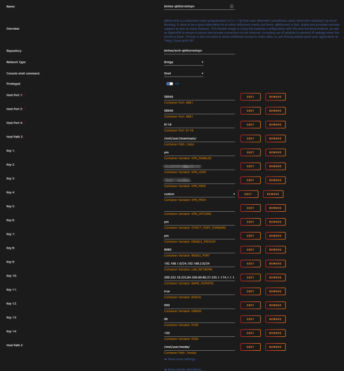

Hey Binhex,
First of all, massive fan of your containers, I use many of then successfully 99% of the time :)
The 1% is the reason I am now here. Like other users, I cant seem to access the webui as of a recent update. I have tried with
VPN_ENABLED set to no, and still no access.
Please find my supervisord.log attached.
Cheers
supervisord.log
1 minute ago, benneb2 said:
Hey Binhex,
Cheers
thats a successful start, what is the ip address of the machine running the web browser?
This is the PC im testing it from.
However, id like to also access it from PCs on the 192.168.2.0/24 (over a site of a site to site VPN) Can I add another subnet to LAN_NETWORK?
yes simply add it with a comma to separate, e.g.:-
192.168.1.0/24,192.168.2.0/24
going back to your original issue, try another browser, it could be an extension blocking the ui, also note this:-
Due to issues with CSRF and port mapping, should you require to alter the port for the webui you need to change both sides of the -p 8080 switch AND set the WEBUI_PORT variable to the new port.
For example, to set the port to 8090 you need to set -p 8090:8090 and -e WEBUI_PORT=8090
Thanks for clarification on extra LAN networks.
Have tried another browser in private mode (no extensions) and still no dice.
I do recall attmepting to change the webui port a while back, but thought id changed all the settings back to 8080.
Pardon my ignorance, but what do you mean by 'change both sides of the -p 8080 switch'. How do I go about doing that?
Thanks for your help!!
i mean you need to change the host port and the container port to both be 8080 (assuming you defined webui_port as 8080), left click and select 'edit' and then screenshot all settings from this screen if you want to confirm is set correctly.

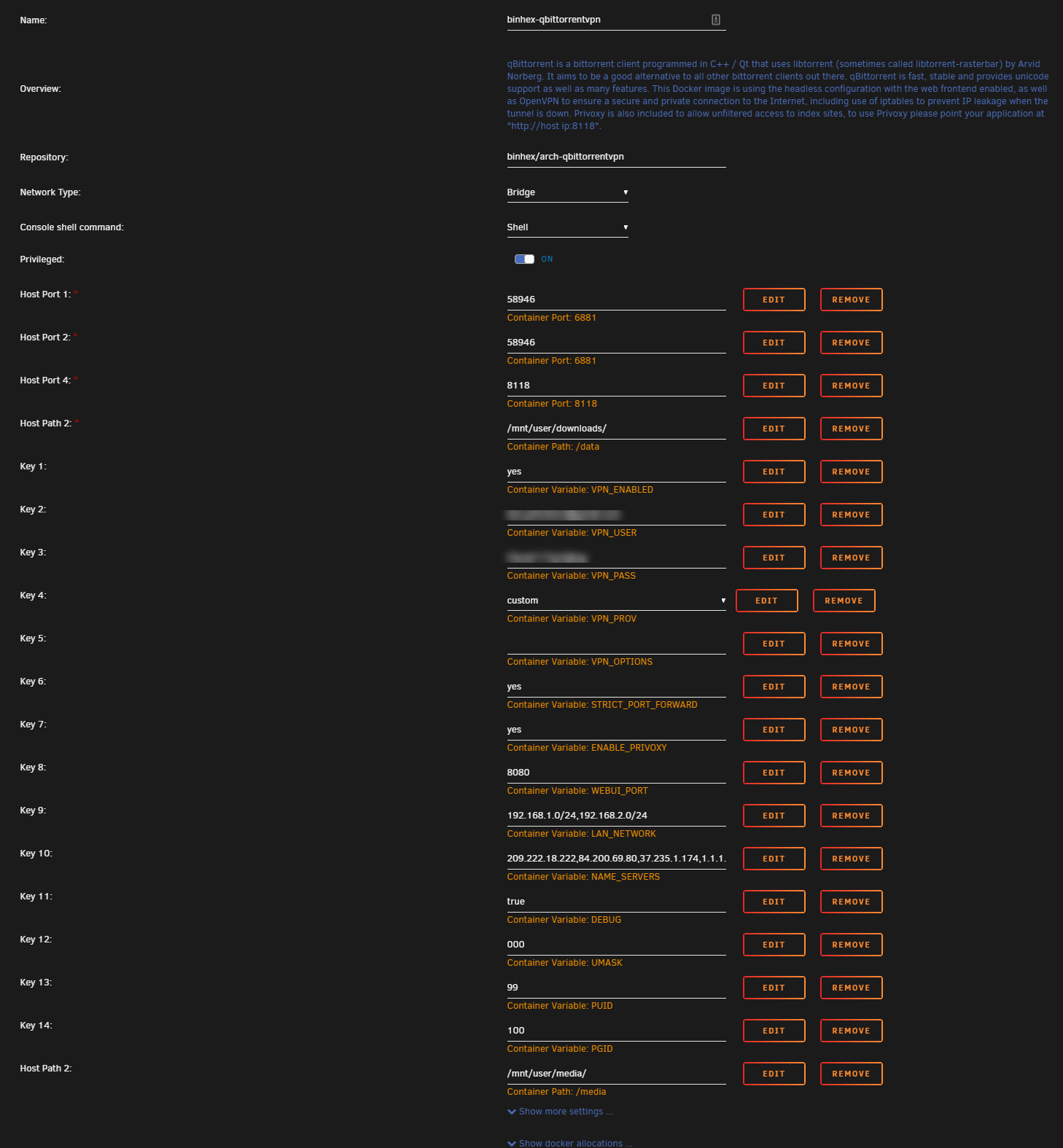

ah ok. Please see attached screenshot (should have included in original post, apologies)
yeah you dont have port 8080 defined, you must of removed it (its in the template by default), you need to have that port added in order to connect to it, click on 'Add another Path, Port, Variable, Label or Device' and select 'port' from the dropdown, set container port to 8080 and host port to 8080, click on add and then apply on the main edit screen, wait a minute or two for it to start and attempt web ui connect on port 8080.
Thanks for that - thought i was missing something!
Have some weird behaviour now. The webui loads after about 5 mins, then when attempting to login, it loads forever.
Any ideas?
