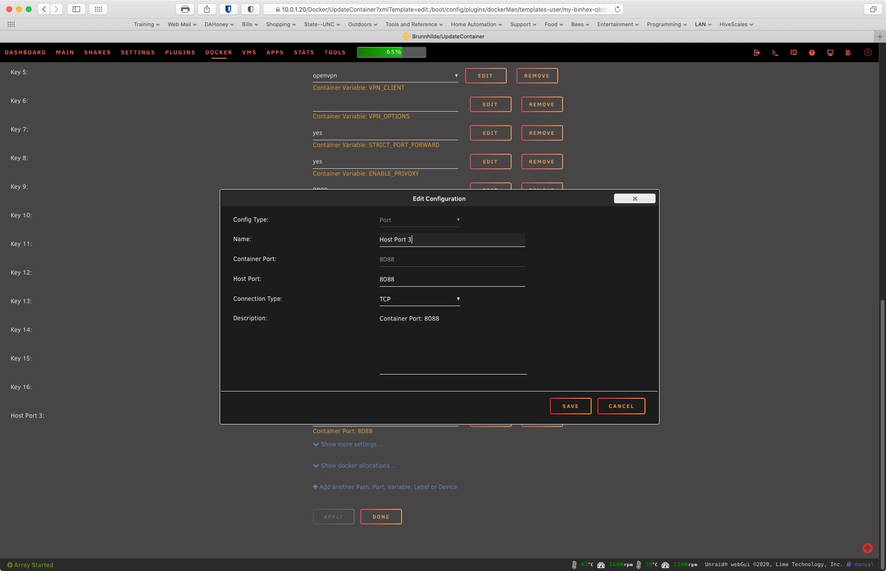

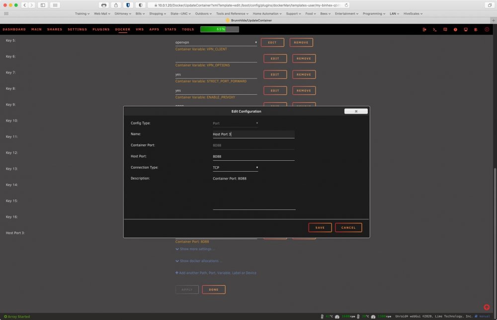

also says server error and port 8080 already in use?
Some other docker is already using 8080. You’ll need to edit the 8080 port and webUI port. Change both host path and container path to some unused port (I used 8088:8088). Change the webUI port setting to match.
well that allowed it to install and create Openvpn folder, put the 3 files in it, restarted but just continually goes to Problem loading page and the GUI never shows

I'm not the best at troubleshooting from the logs but I see this in your log-
[warn] Password contains characters which could cause authentication issues, please consider changing this if possible
Also, just to be sure you're using the correct credentials, it's the ones you use when you log in to the PIA website right?
yes user and password just as use to log into PIA website and app.
You might try changing the password so that it has no special characters and see if that helps. You can also set strict port forwarding to "No" which will work as a temporary work-around although you might suffer from slower transfer speeds. @droopie reported the same issue earlier today https://forums.unraid.net/topic/75539-support-binhex-qbittorrentvpn/?do=findComment&comment=907356. Sorry but I don't really know the answer for sure. Perhaps someone else will chime in soon.
21 hours ago, droopie said:
in the Key 10  config for the container, should i change 192.168.1.0/24 to 192.168.1.1/24 since 192.168.1.1 is my gateway?
No. 192.168.1.0/24 looks like the correct network type. Your gateway address would absolutely be wrong for this variable.
Thanks so much at least it gets 99% of the way
may have found issue how do you change p 8080:8088  to  p8088:8088
as in doc
Due to issues with CSRF and port mapping, should you require to alter the port for the webui you need to change both sides of the -p 8080 switch AND set the WEBUI_PORT variable to the new port.
For example, to set the port to 8090 you need to set -p 8090:8090 and -e WEBUI_PORT=8090
as in doc
You'll need to open the container configurations and remove the existing path setting for 8080. unraid won't allow you to edit it on the container side. Once you have remove the old path scroll to the bottom of the page and select “Add anther path, port, variable or device”. Use these settings if you want to change the port to 8088-
Name and description aren't important but the rest need to match.
Substitute 8090 for 8080 in the example. Be sure to set webui to the same port.
