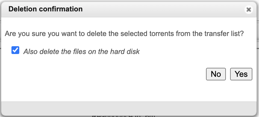

I'm doing some testing with qBit, Sonarr and Jacket (all Binhex). When downloading a torrent (<100%) and then choosing to delete it and have qBit also delete the files on the hard disk, it deletes the whole /data/incomplete folder. The folder will be recreated by qBit when I start a new torrent. Strange behaviour, I have the same settings on my desktop qBit and that keeps the /incomplete folder. Ideas?
Also, I'm using this script in qBit:
unrar x "%F/.r" "%F/"
to automatically unpack .rar files that is being picked up on a private tracker by Sonarr/Radarr. It works, but after the seeding limits are met and Sonarr is deleting the files it doesn't delete the unpacked file. Anyone have any idea on how to modify the script to delete the unpacked file after Sonarr have copied it to the array?

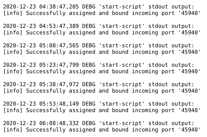

Anyone else seeing this every 15 minutes in their log?
I'm not sure if it's a health check or a warning.
If it's bound though it shouldn't need to re-bind...
its a requirement from PIA, you need to rebind every 15 mins in order to keep the port assigned, otherwise it will be removed and re-assigned to the pool.

2020-12-23 13:40:52,572 DEBG 'start-script' stdout output:
[info] Successfully assigned and bound incoming port '43857'
2020-12-23 13:40:53,053 DEBG 'watchdog-script' stdout output:
[info] qBittorrent listening interface IP 0.0.0.0 and VPN provider IP 10.56.240.113 different, marking for reconfigure
2020-12-23 13:40:53,058 DEBG 'watchdog-script' stdout output:
[info] qBittorrent not running
[info] qBittorrent incoming port 6881 and VPN incoming port 43857 different, marking for reconfigure
2020-12-23 13:40:53,059 DEBG 'watchdog-script' stdout output:
[info] Removing session lock file (if it exists)...
2020-12-23 13:40:53,061 DEBG 'watchdog-script' stdout output:
[info] Attempting to start qBittorrent...
2020-12-23 13:40:53,077 DEBG 'watchdog-script' stdout output:
[info] qBittorrent process started
[info] Waiting for qBittorrent process to start listening on port 8088...
2020-12-23 13:40:53,194 DEBG 'watchdog-script' stdout output:
[info] qBittorrent process listening on port 8088
