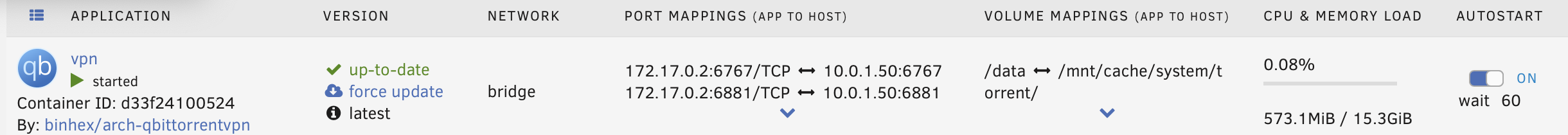

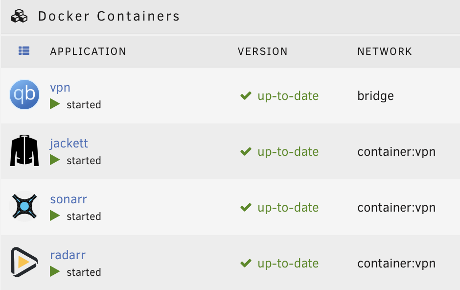

Using this container (which I've renamed vpn) I create a new network with the following command and route all related containers through it:
docker network create container:vpn
It's straightforward and (from what I can tell) works reliably, no issues with the latest update.
Many seem to use proxies instead - are there advantages to that method?
2 hours ago, Oogbal said:
Can confirm that with this latest update Sonarr/Radarr can't connect to qBittorrent if you're using Privoxy. I disabled the proxy settings on both Sonarr and Radarr and it immediately was able to connect to qBittorrent again. If it matters, I'm using both Binhex Radarr and Sonarr and all of it is on the same custom network type.
Q26:- https://github.com/binhex/documentation/blob/master/docker/faq/vpn.md
the only advantage over what you are doing is that with a proxy you dont have to care about start order, whereas you do have to ensure the 'VPN' starts first, thats pretty much it though, personally i prefer what you are doing, its a lot easier to understand and manage than multiple connections to a proxy server, but i allow people to choose the method that suits them.
Thanks, thought maybe I missed something.
I should also mention I set an autostart delay (to give it time to establish the connection.)490352661_ScreenShot2021-02-26at10_13_25AM.thumb.png.212c51724c7377fba4c8f8a3e23e5736.png
