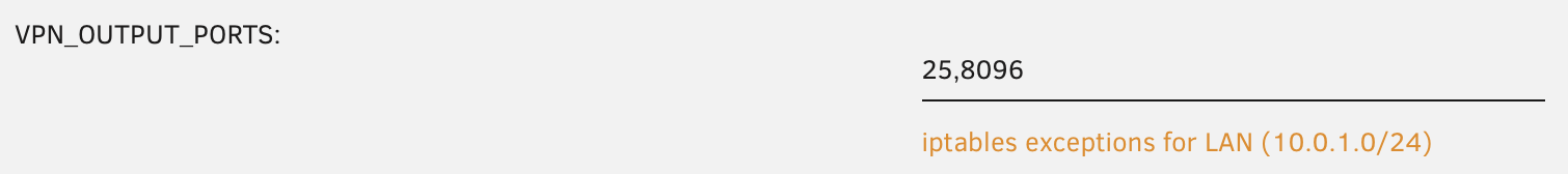

I noticed none of the containers I have routed through this one could communicate with services on LAN IPs.
I found the solution in A27 of the FAQ:
Adding a variable VPN_OUTPUT_PORTS with a list of port exceptions (mine are Emby and SMTP)
362418861_ScreenShot2021-03-19at12_17_39PM.thumb.png.bdc988594c85596acc1c621b7ddc8b7e.png
I didn't see this mentioned here (maybe it's new) so I thought I'd mention it.

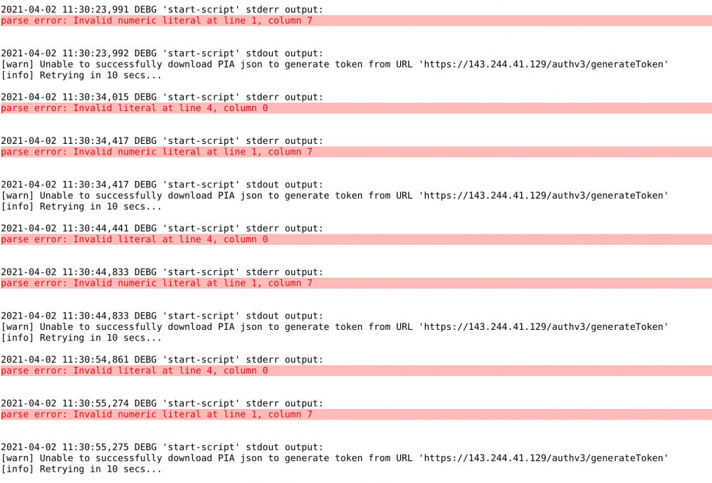

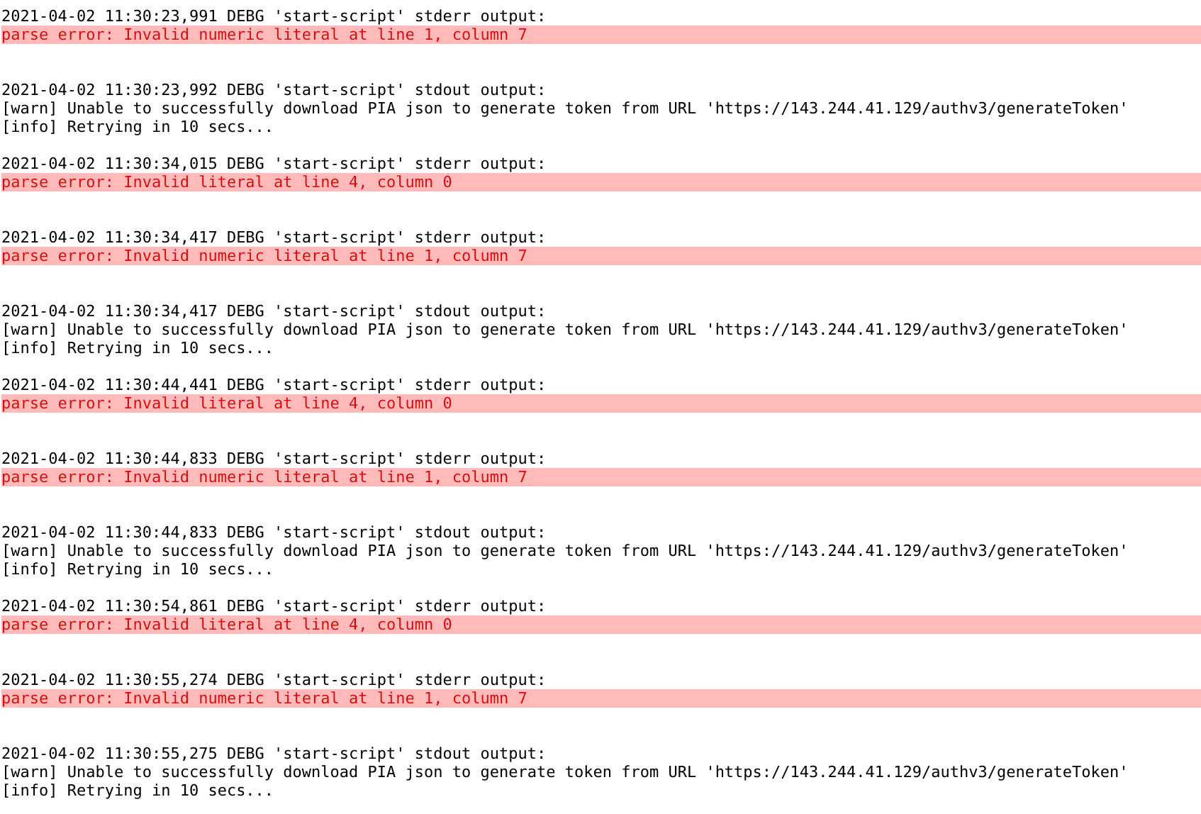

Getting a new issue with qbittorrent.  Was working fine yesterday.  Using PIA with Wireguard.238996247_ScreenShot2021-04-02at11_30_59AM.thumb.png.6be35ddaeaa1ae2f06600676b84dd069.png
Same error here.
A bunch of:
2021-04-03 15:55:59,590 DEBG 'start-script' stderr output:
[#] ip link add wg0 type wireguard
2021-04-03 15:55:59,592 DEBG 'start-script' stderr output:
[#] wg setconf wg0 /dev/fd/63
Line unrecognized: `PublicKey='
Configuration parsing error
2021-04-03 15:55:59,594 DEBG 'start-script' stderr output:
[#] ip link delete dev wg0
2021-04-03 15:55:59,629 DEBG 'start-script' stdout output:
[warn] WireGuard interface failed to come 'up', exit code is '1'
Was working till some hour ago...
