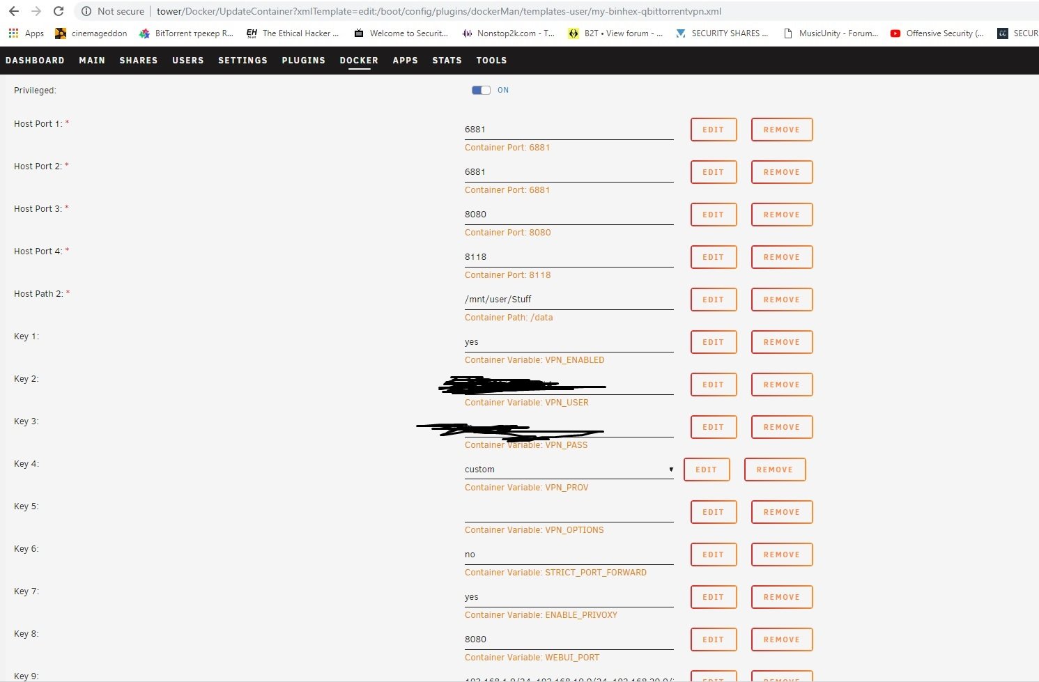

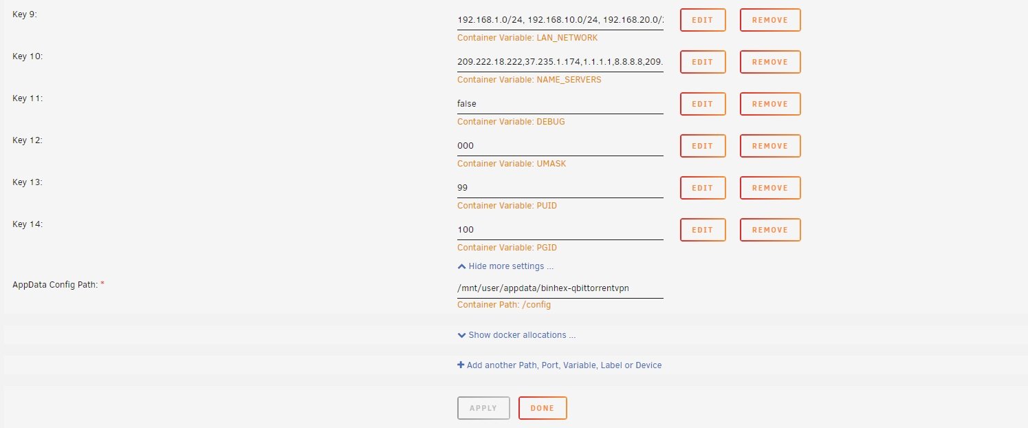

can you also post a screenshot showing the configuration for the container.

so onto the issue then, so you say you cant login to the web ui, but you can see the initial login screen correct?, just when you enter in username admin (all lower case) and password adminadmin (all lower case) then it doesnt let you login right?

try toggling privileged mode off then back on again and see if that fixes it as your symptom is normally related to privileged mode being off

tried that did not help
