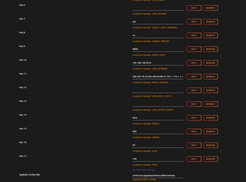

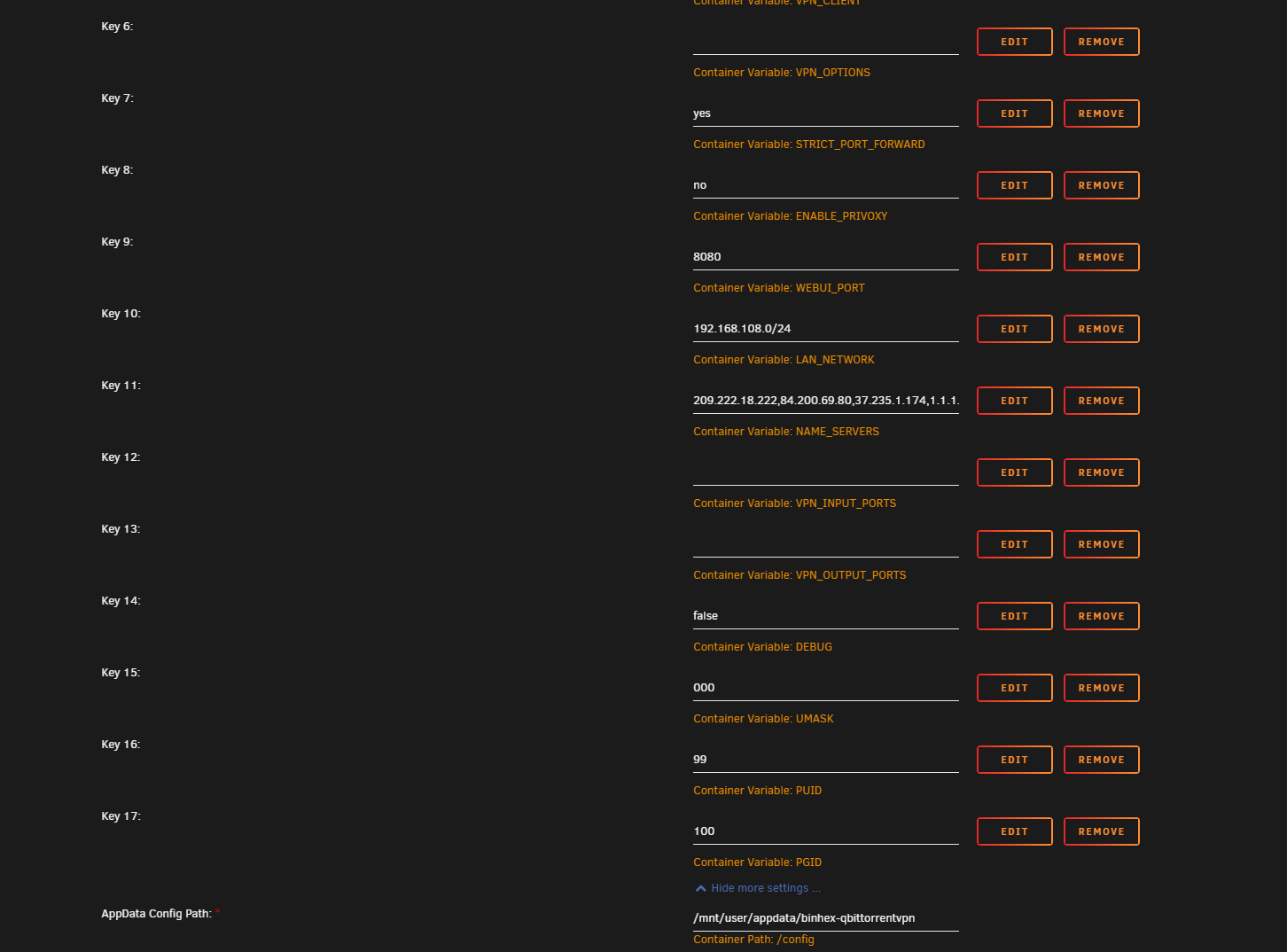

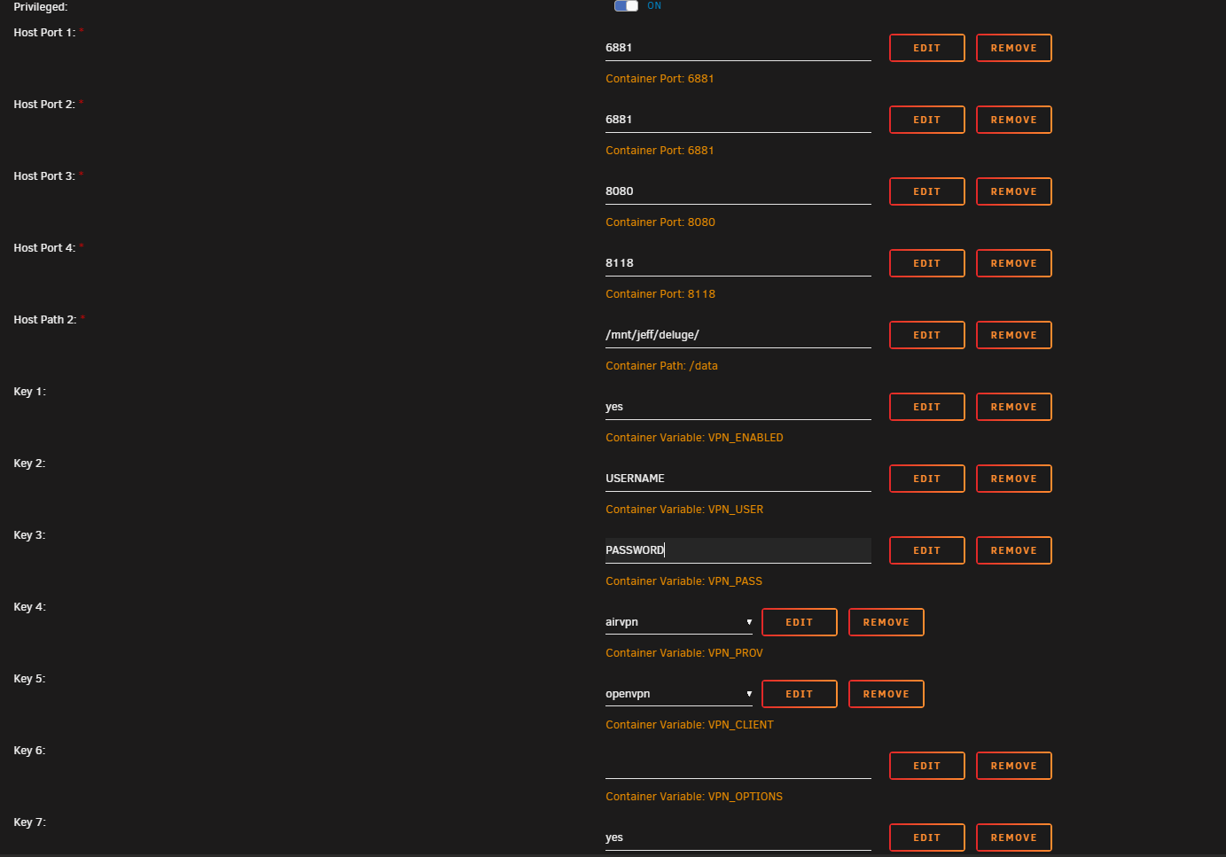

I'm using airvpn with 0 changes otherwise and I can not get the webui to load while the vpn connection is turned on. Is there something I am missing? I have gone through the faq and even though there was not a message about iptables I enabled the iptable_mangle with no change. I did try to update the webui via the docker and the qbittorrent client itself when the vpn is off but no change. 1386926385_unraid1.thumb.PNG.2f5fb3a50cb6b0afc14326d6aaf7820a.PNG1175487040_unraid2.thumb.PNG.b49a1e7b8dbc4a6d61fde2a6d45df392.PNG
https://pastebin.com/pYyFWyU6
supervisord.log
