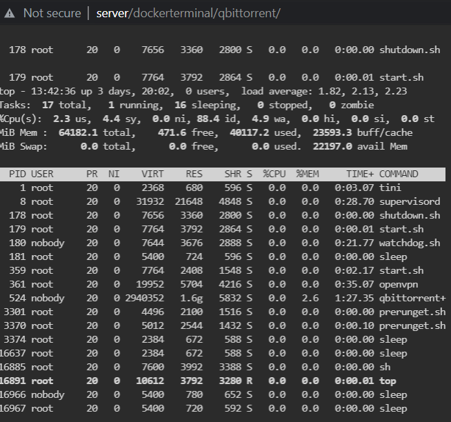

Hey Guys, I've noticed qbittorrent has been holding on to exactly 1.6gb of RAM even when sitting idle, absolutely 0 torrents, nothing going on in "top" from container console. If I restart the container it drops to normal usage but then creeps but up to 1.6gb again, currently on 4.3.5. Any ideas?
completely normal, this is due to the disk caching feature in qbittorrent, as i have mine set to 2048 MB my memory usage is just over 2GB right now with qbittorrent doing sweet FA, note the the highlighted field, you can crank this down but i wouldnt as it might then affect download speeds when you do have something running, TLDR:- dont worry about it.
Haha love it.
Okay cool, first time I had noticed it and thought it just seemed a bit high but this makes perfect sense.
Thanks mate.

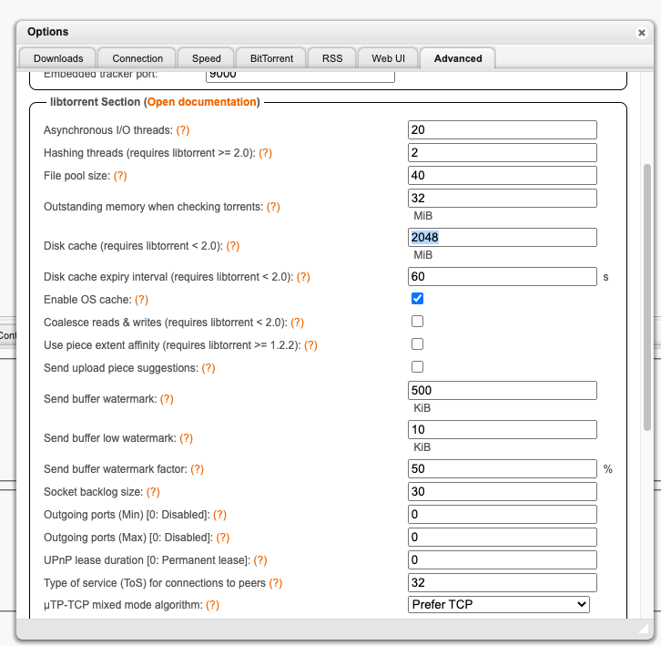

my disk cache is set to -1, this is the default setting from when I installed the docker, would you recommend me changing it?
Edited by Docshaker
2 minutes ago, Docshaker said:
my disk cache is set to -1, this is the default setting from when I installed the docker, would you recommend me changing it? For context, I have 1g up/down, around 350-400 torrents seeding, 15-20 actively seeding at any given time, 64gb of ram and utilize 15% of it at most, No VMs, only other dockers is plex and krusader, and plex doesn't use ram for transcoding.
sure, -1 is auto, so have a play and see if you get any improvements by changing it.
