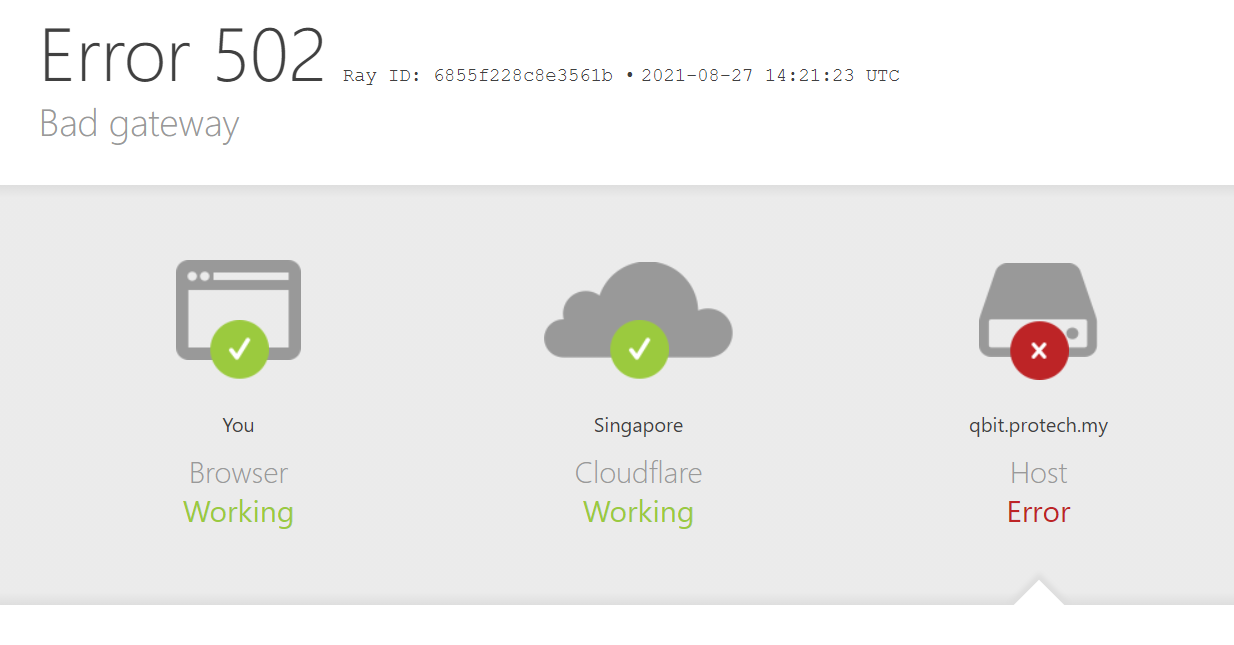

Have anyone successfully reverse proxy this docker using swag provided qbittorrent subdomain conf. file? If anyone could help me see if I did any mistake to the swag conf. file.
## Version 2021/05/18
# make sure that your dns has a cname set for qbittorrent and that your qbittorrent container is not using a base url
server {
    listen 443 ssl;
    listen [::]:443 ssl;
    server_name qbit.*;
    include /config/nginx/ssl.conf;
    client_max_body_size 0;
    # enable for ldap auth, fill in ldap details in ldap.conf
    #include /config/nginx/ldap.conf;
    # enable for Authelia
    #include /config/nginx/authelia-server.conf;
    location / {
        # enable the next two lines for http auth
        #auth_basic "Restricted";
        #auth_basic_user_file /config/nginx/.htpasswd;
        # enable the next two lines for ldap auth
        #auth_request /auth;
        #error_page 401 =200 /ldaplogin;
        #include /config/nginx/authelia-location.conf;
        include /config/nginx/proxy.conf;
        include /config/nginx/resolver.conf;
        set $upstream_app binhex-qbittorrentvpn;
        set $upstream_port 8585;
        set $upstream_proto http;
        proxy_pass $upstream_proto://$upstream_app:$upstream_port;
        proxy_set_header Referer '';
        proxy_set_header Host $upstream_app:$upstream_port;
    location ~ (/qbittorrent)?/api {
        rewrite /qbittorrent(.*) $1 break;
    location ~ (/qbittorrent)?/command {
    location ~ (/qbittorrent)?/query {
    location ~ (/qbittorrent)?/login {
    location ~ (/qbittorrent)?/sync {

I have odd issue - in bridge mode, default ports cannot access webgui (same goes for binhex deluge) but when I change from bridge to custom and give container own IP it works... Tried rebooting unraid, tried transmission vpn too and same problem, without vpn let's say transmission from linuxserver repo it's all ok on same ports. I even tried airvpn instead of nordvpn but that didn't help.
Anyone had such problems with gui recently? VPN connection is all ok so don't know how to solve this issue.
On 9/3/2021 at 2:56 PM, binhex said:
yes i did get chance to take a look and the issue is related to iptables being tightened, so right now privoxy is restricted to respond to requests only on lan side. i am loathed to change this tbh, you are literally the only person to request privoxy access from the internet, so i dont really want to open this up for a single request, sorry, you are of course free to fork and change as you see fit.
can i just ask a little bit more detail on this, why do you need to route traffic via privoxy from the internet?, is there a specific task you are trying to achieve here, maybe there is a better alternative i could suggest.
I want to be able to route web based traffic through this VPN from outside of my network. I will lock this down via my firewall to only allow traffic from a specific IP address so as to not open up a security nightmare. I also don't want to run more than one VPN. I use this for a multitude of things and it works flawlessly for everything I want except this one task but this one task is very important. Isn't there something that can just be done on my side to allow this?
F
Solution is in this thread already ->
