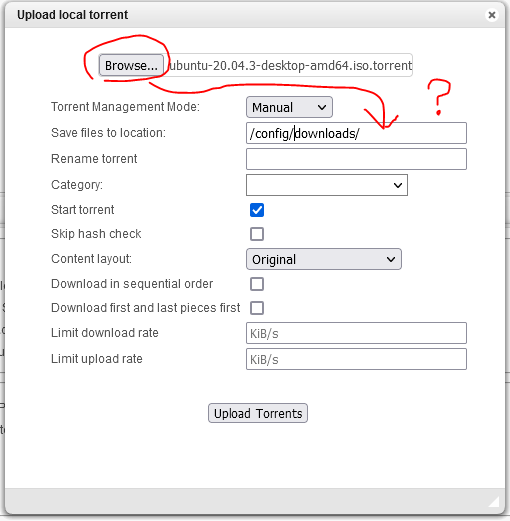

Sorry if this is a dumb question but is there some way to browse the local docker shares when adding a file? I'm not a fan of guessing manual paths and having to double check them. Also, Browse... only lets you browse the accessing system rather than local shares to the docker. Is there a way to have both be just through the docker shares directly? If it was direct control of the application rather than the web UI, this would be possible so it's a curious limitation.
you should be able to see what you call 'local shares' (bind mounts in docker talk), so going to /config should show you all files that are located on your host system (unraid) for the host path you specified, same for /data, if you REALLY want to see all unraid shares (NOT recommended), then add in a new 'path' with host path defined as '/mnt/user' and container path of say '/unraid' and then use this to browse all shares.
Just the one bind mount is sufficient but I was hoping to be able to have a browse UI for that location to choose a subfolder that way but it looks like it's just a limitation of the web UI and can't be done. Using the monitor folder options is the next best thing (adding one for each possible download location).
