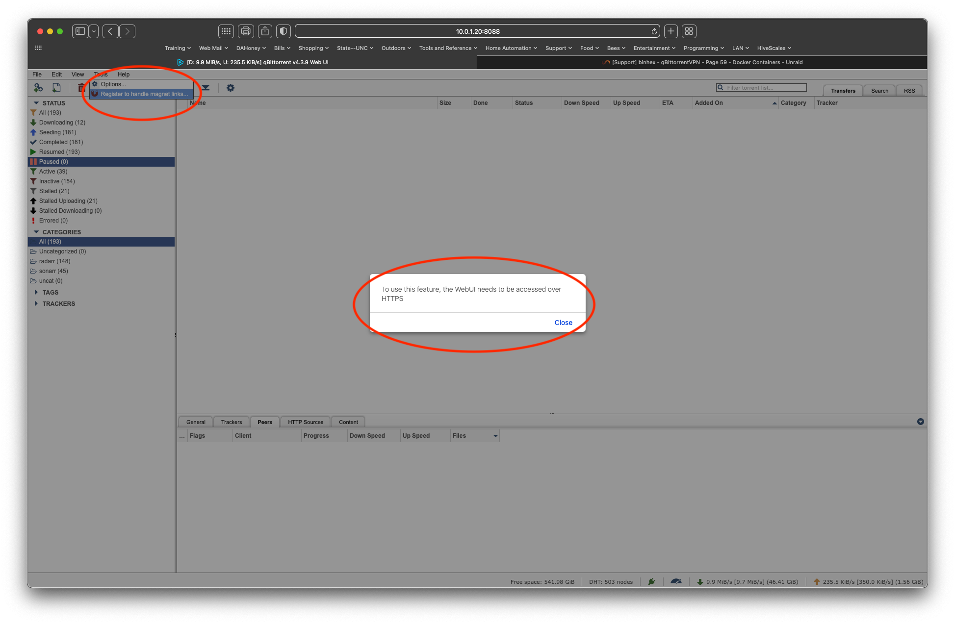

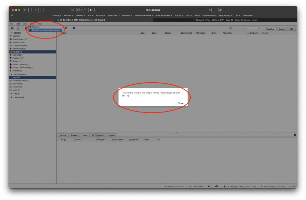

I see in the qbittorrent settings that I must enable https to be able to use magnet links. Looking at the https setting it appears that all I would need to do is add a self signed certificate to the app. Before I do this I wanted to post and see if this would effect the docker/app in any way?
im using http and magnet links with qbittorrent with no issue, what makes you think you need https for magnets?
Magnet links haven't worked for me at all.
2012733982_ScreenShot2021-11-09at8_02_04AM.thumb.png.2a8da1da40d06c66460ddee687cf7cb1.png
I noticed in the tools menu there is a setting to enable magnet links but if I select it I get a popʉp showing that https must be used.
just to be clear are you talking about registering magnet links for your web browser or simply copy and pasting magnet links via 'file/add torrent link/<paste magnet into 'Download Torrents from their URLs or Magnet links' field>' (this works every time for me).
edit - magnet links sent from prowlarr to qbittorrent also work.
This^^^
Hasnt ever worked for me, the app just ignored it, until I tested it just now of course.🤨🤨
Now it works fine.🤷🏼‍♂️🤷🏼‍♂️🤷🏼‍♂️😁
I almost never need to use it so it’s possible that it’s been working for some time and I never noticed.
16 minutes ago, wgstarks said:
This^^^
lol, glad its working now :-).

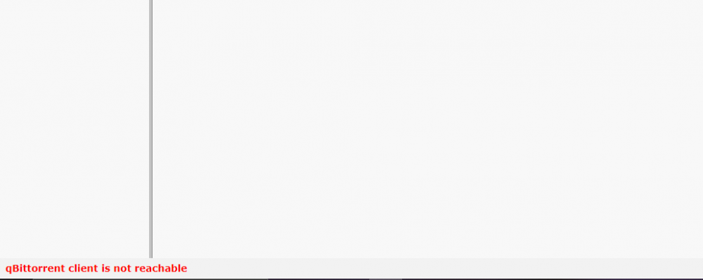

Hoping to get some help, sorry in advance for any missing details :)
As of about a month ago, my qbit vpn container loses network connectivity.
