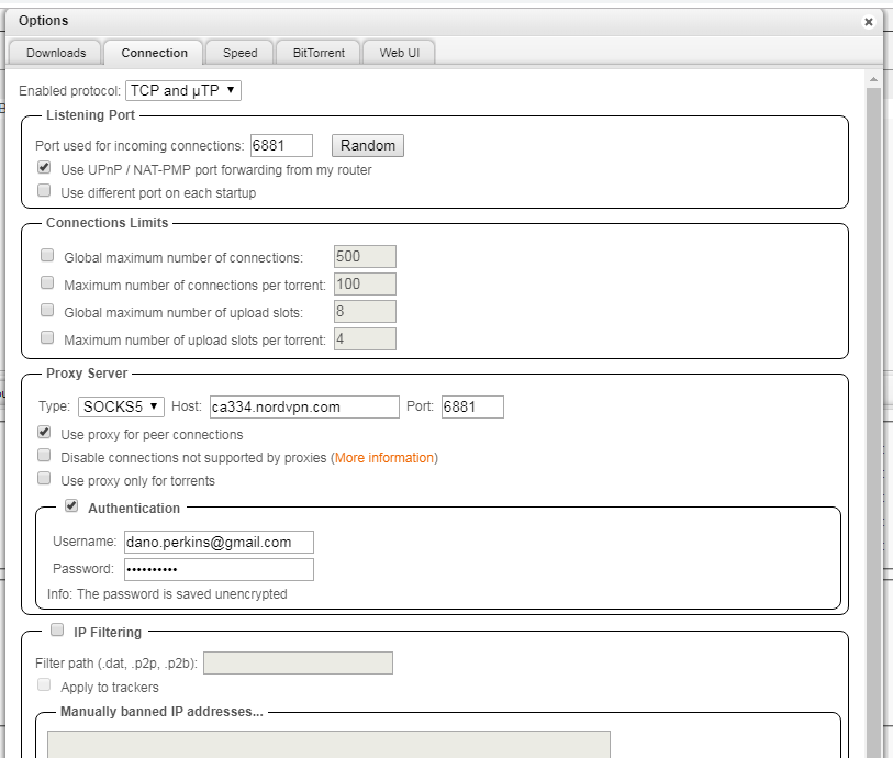

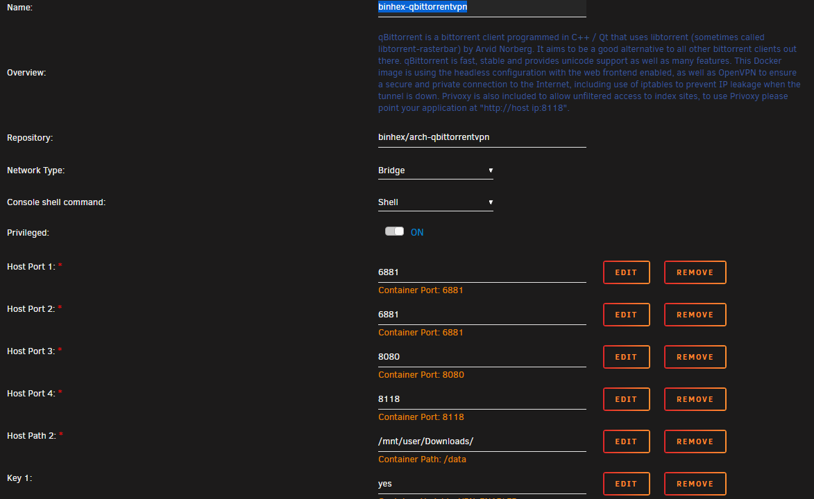

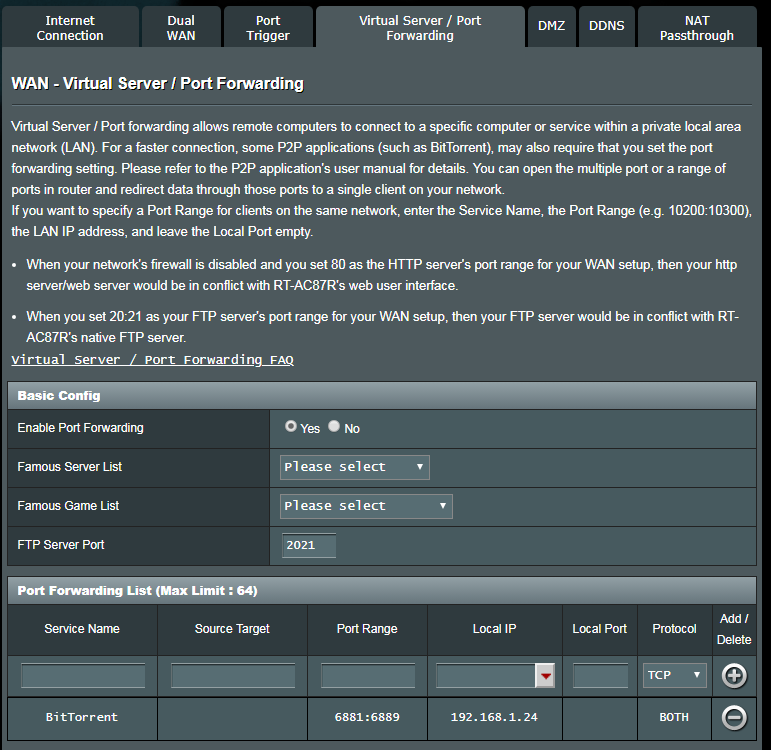

Good day all. Im Dan, hi. and im new to this. My pea brain is having a tough time. So far i got a computer and have got unraid to run. Well Spaceinvader one did I just did what he said. My only plan at this point with the computer is to #1 download torrents with nord VPN. #2 have a plex server. #3 be able to access the computer remotely from work to download torrents(yay torrentday i love you.). Im stuck on #1. im running binhex-qbittorrentvpn. I was wondering if anyone could help.
I dont know how to upload pics here. I added attachments.
I added my nord vpn files in krusader.
I can load up qbittorrent
My download speed with shaw is 300+ MBPS
A torrent will stall in Qbittorrent and will start to download at a couple bytes then stall out.
