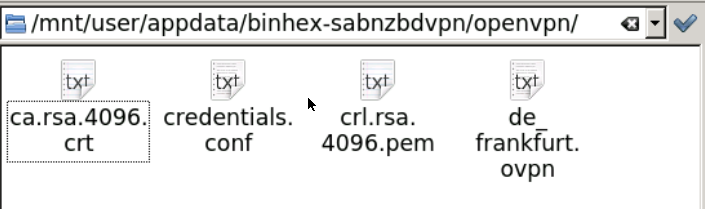

Did you also supply ovpn files to the openvpn folder in appdata?
i used these files from pia:
https://www.privateinternetaccess.com/openvpn/openvpn-strong.zip
dont forget the *.pem and *.crt file
should look like this:
this works with sabnzbd, qbittorent and deluge, but the last 2 dont portforward this way.
18.27 edited:
credentials.conf is auto generated after first run.
18:41 edited:
it appears that it doesnt work in torrenting, after it brings up the openvpn tunnel (tun0) and finishing initialization proces, where it is supposed to proceed to starting qbittorent it is starting the initialization proces of the wireguard service and same error returns:
Yeap! I originally set it up as OpenVPN So my files have been their
Well we have to wait for binhex to update this container.
