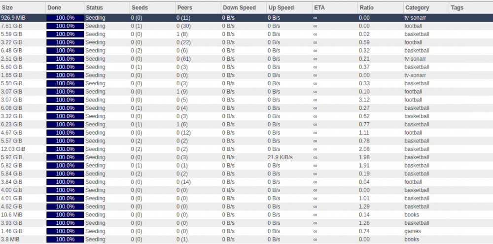

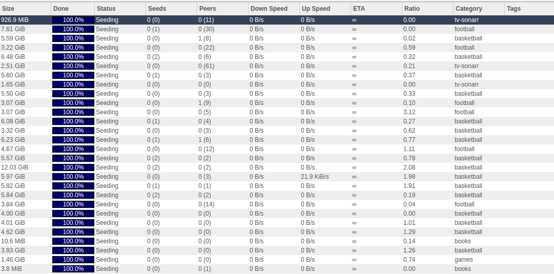

My Torrents are starting to download but then immediately go into errored state.
I have checked the docker run command that is fine, forced an update just in case.
The logs show it connects fine - it had been working at least last week it was. (no changes made by me)
I have attempted to swap the docker to Privileged also. no luck
Any ideas on this at all?
Edited by Arcau

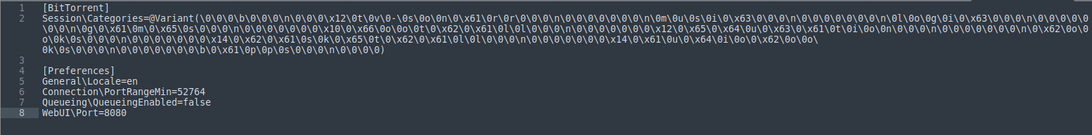

Prereq: I copied my config file over from a different qbittorrentvpn container so it would save my categories.  Everything copies over no problem.  Every thing works without issue for weeks.
  1. Today I try to login to webgui and it user/pass does not work.
  2. Go to config file.  there is nothing listed for webui or webpassword.  Restart container.
  3. try incognito mode in brave and use u: admin pw: adminadmin.  it doesnt say bad password but it doesnt take me beyond login screen
  4. I use incognito in firefox.  admin, adminadmin works, but my webui refused to update without a manual refresh.  All status on sidebar show (0).  It will show a list of my torrents but it will not manually change save paths or show me categories to pick when use drop down menu.  This is the same result when i use Chrome incognito mode.
  5. I have no idea why my user/pass stopped working, why the interface won't update, or how to remedy.  Can you please help?
1212442650_Screenshotfrom2021-11-2814-11-12.png.5467f2f33a91b2857d430238a1e6a15f.png686280789_Screenshotfrom2021-11-2814-17-02.thumb.png.28fd1c31cbafc237094524de27012c3a.pngScreenshot from 2021-11-28 14-11-35.png
Edited by RinkyDinkBear
