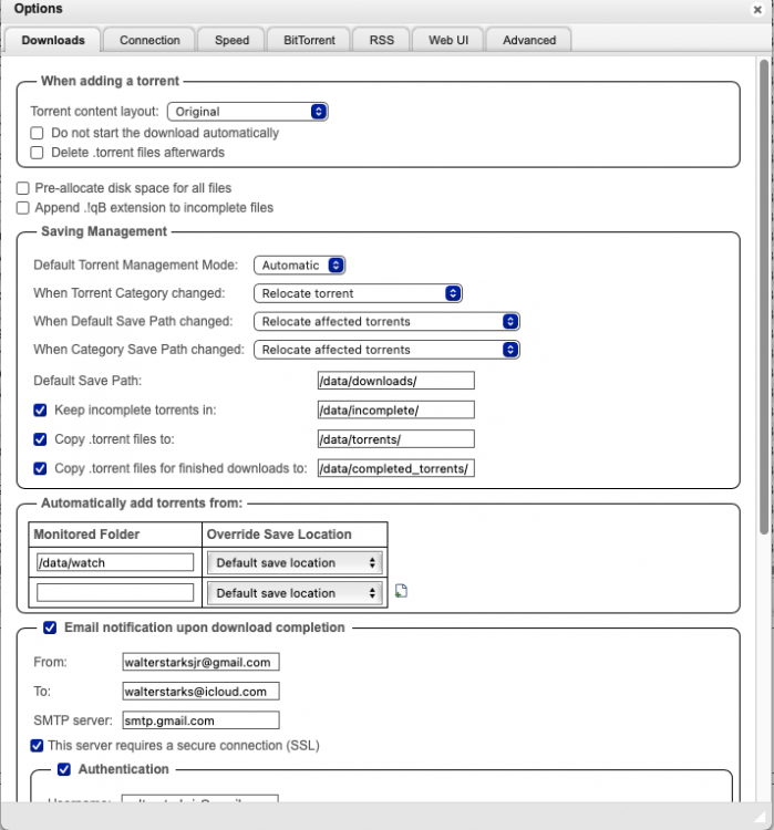

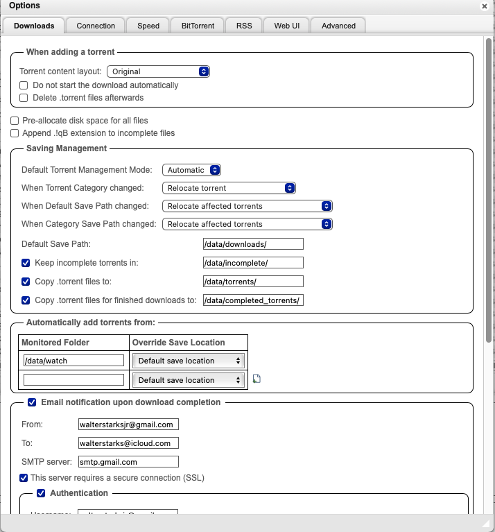

2 minutes ago, wgstarks said:

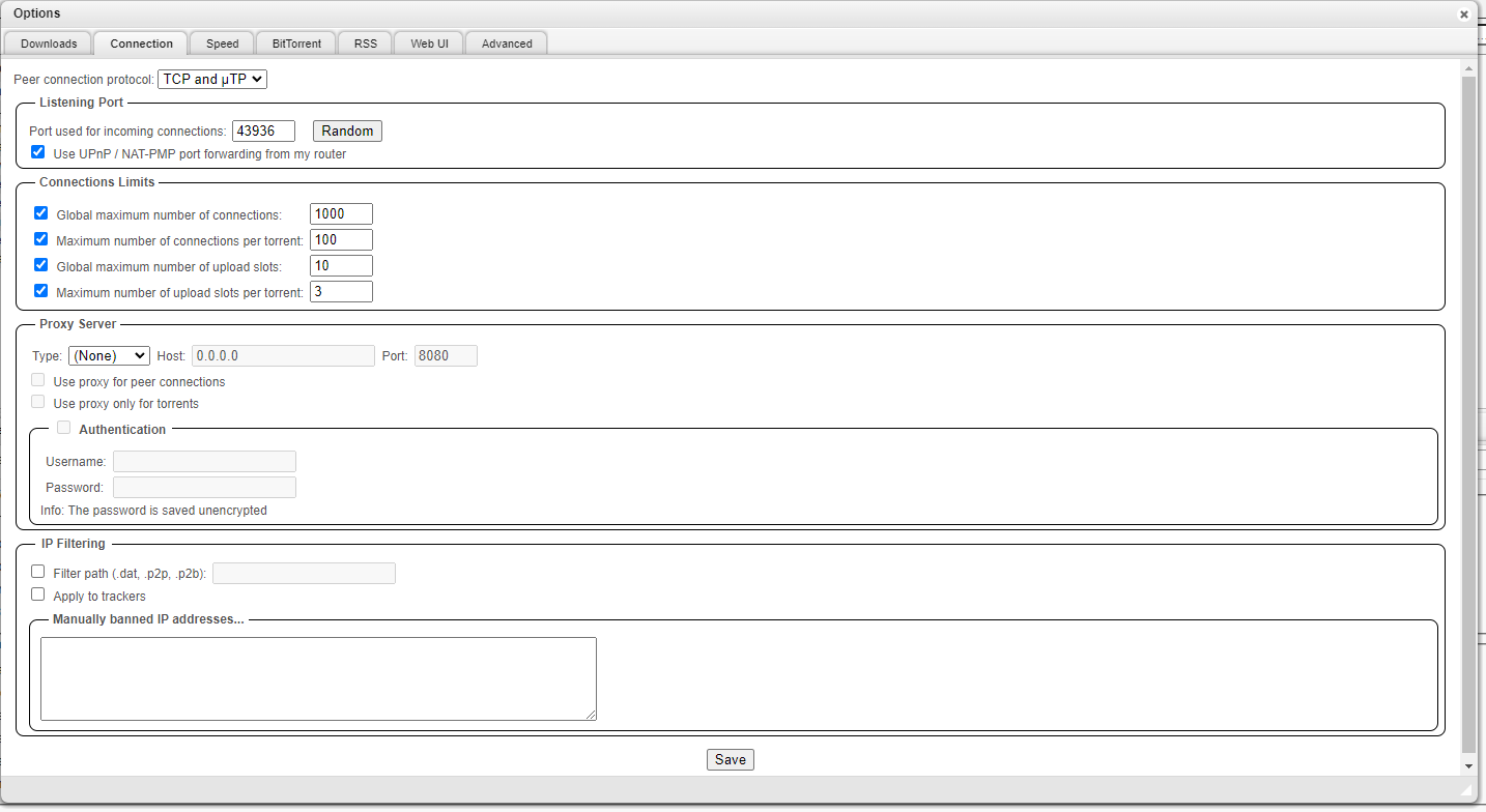

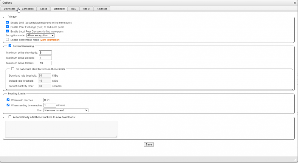

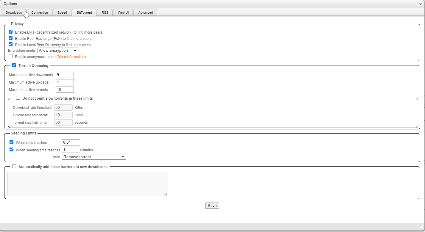

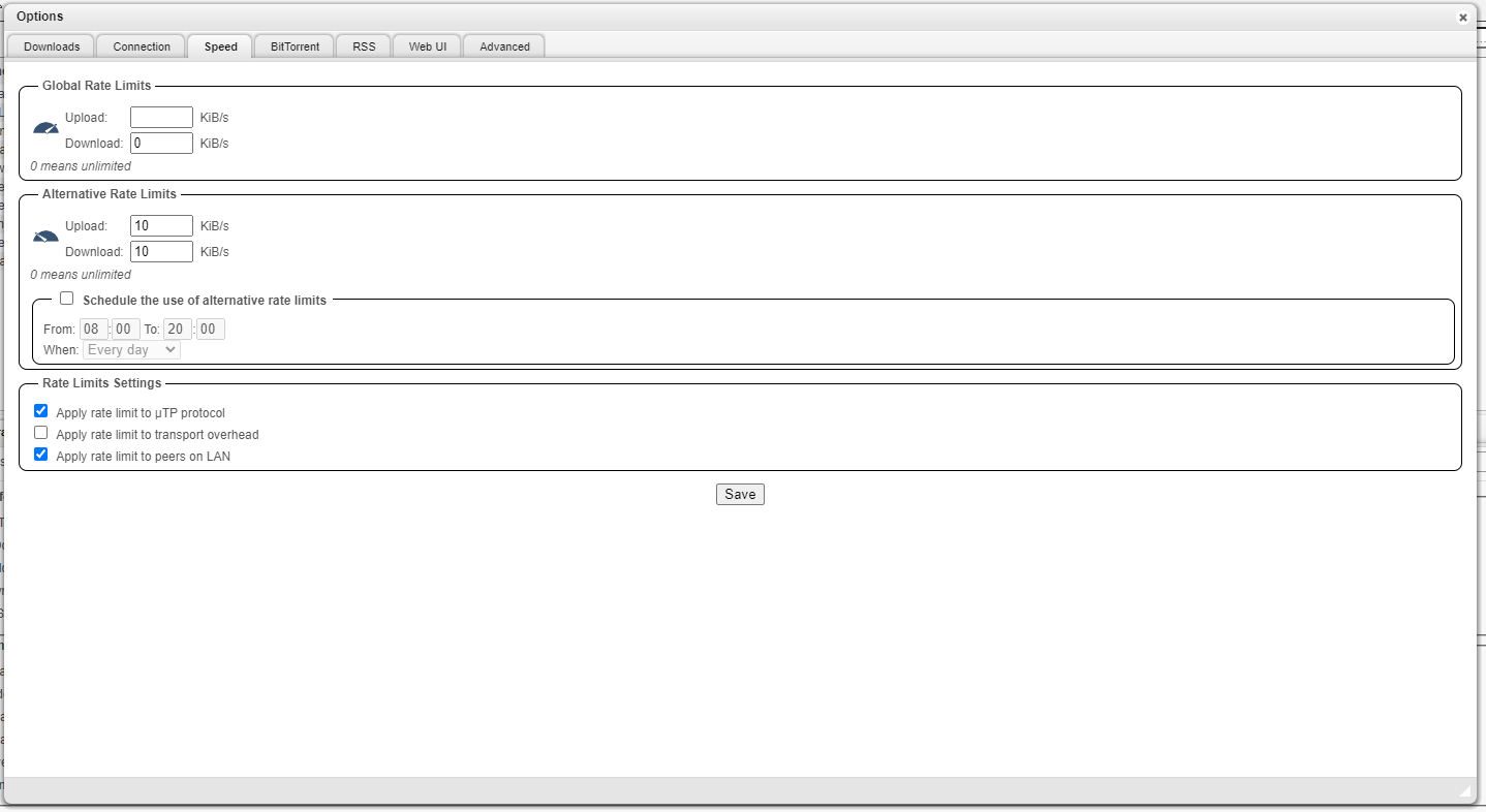

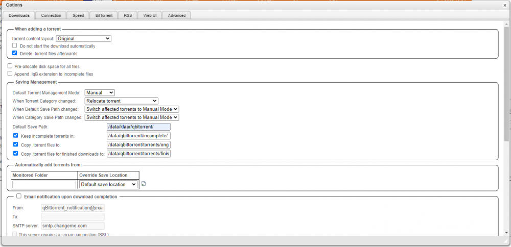

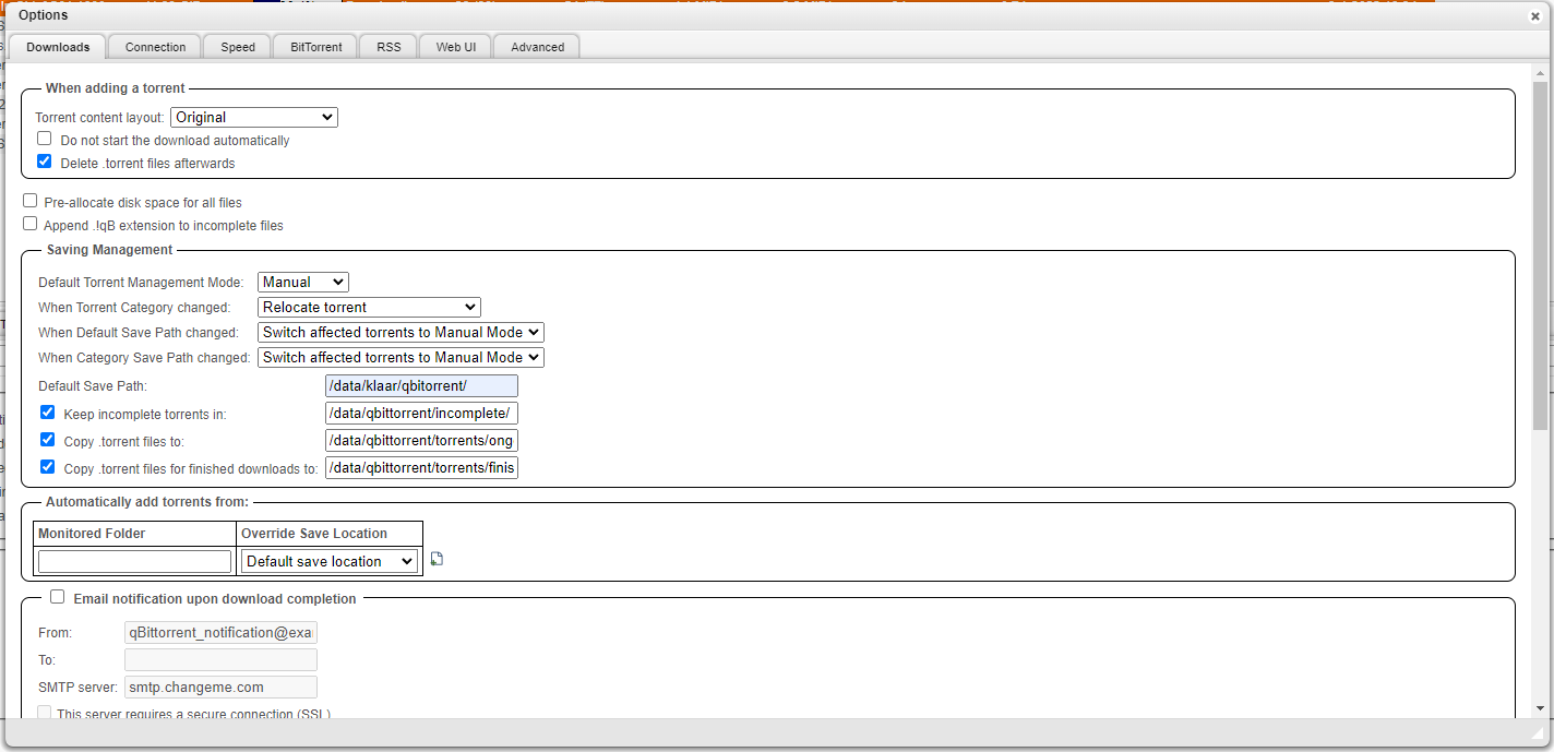

Here's a screenshot of mine (I know they work 😄). You can adjust the names if you want. The just have to start with /data.
469743845_ScreenShot2022-01-08at8_48_52PM.thumb.png.f7b9f72b3fb44cbb13ef67caca828a4f.png
Restart the docker after making changes.
