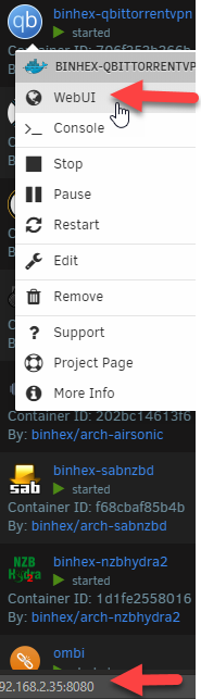

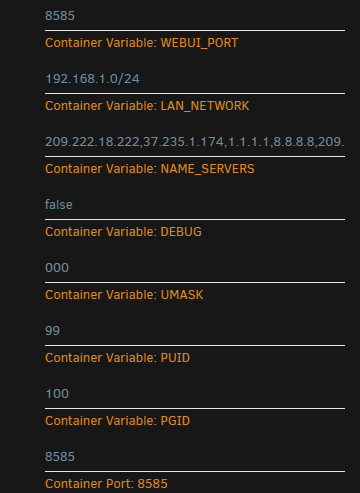

On 11/12/2018 at 3:04 PM, binhex said:
Yeah the secret sauce here is that not only do you need to change the host side port but you also have to change the container side port too to match. so this is a bit more tricky with the unraid web ui, as unraid rightly stops users doing this as you normally don't want to change the container port side but for this particular container we have to.
So in order to get around this you need to edit the container and then use the link down the bottom shown as "Add another Path, Port, Variable, Label or Device", select "config type" as "port" then put in the port number you want for both the "container port" and "host port" and then click "add".
So now you have added the additional port you can now remove the old port, as this will now clash on the host port if you have already altered it.
Remember - Make sure to set the  webui_port to the same value and then click on "apply" button to apply the changes.
Finally open up your favourite browser and point it at the http://<host ip address>:<port of your choice>
UPDATE: switched to deluge.
Is there a way to update the WebUI link to use the new port? Or I'm doing something wrong.
