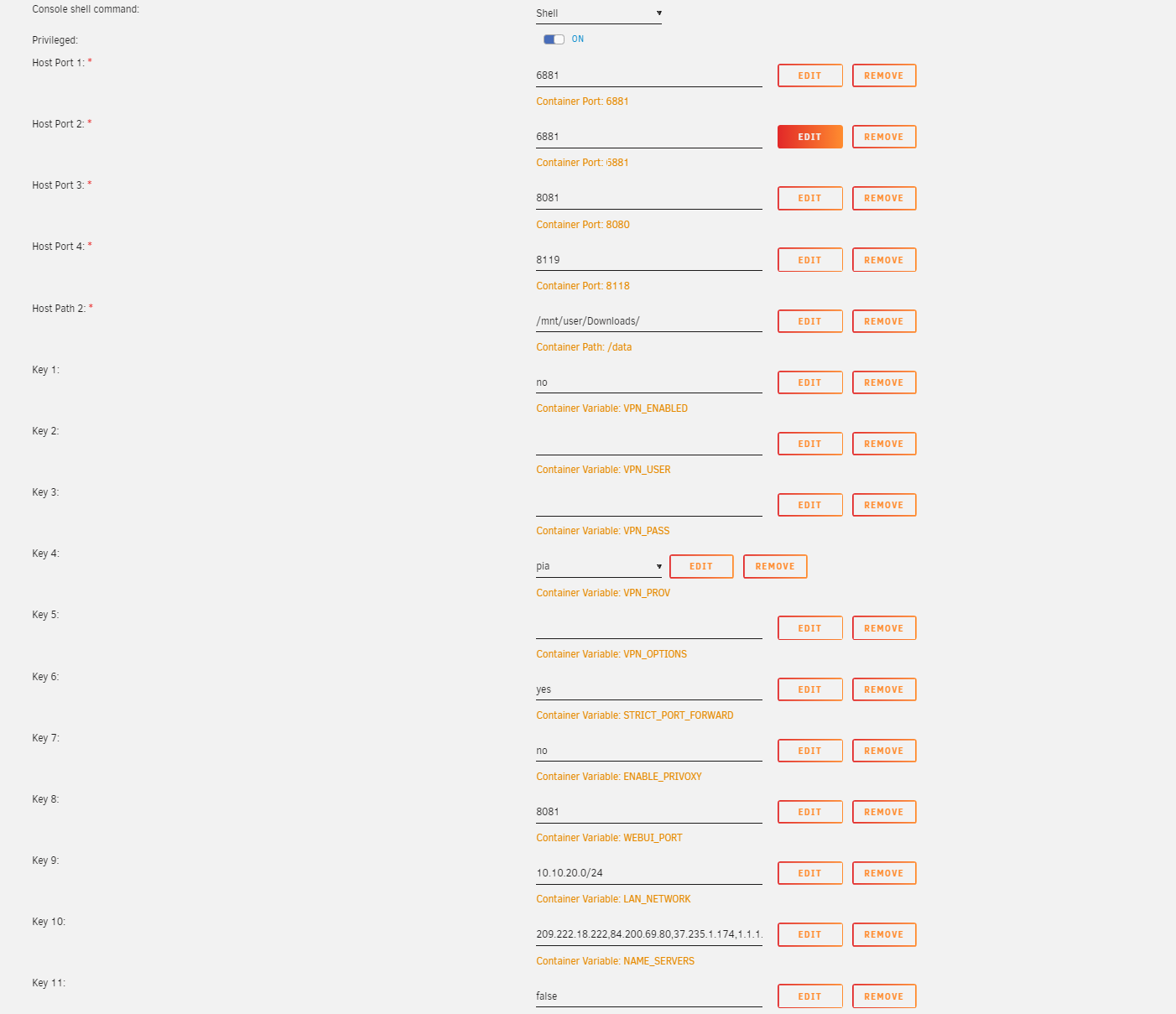

Helo guys, I've been using qBittorrentvpn docker for some time but I wanted to set up a PIA vpn up on it, but it has been a head scratcher for me
This is the setup I have right now (the username and password for my PIA account have been taken out) and I have gotten it to work by just setting the VPN_ENABLED as yes... However I have then been unable to connect to the Web UI.
I was reading https://github.com/binhex/documentation/blob/master/docker/faq/vpn.md Q24 and trying to follow that but I just don't understand what I'm supposed to be doing? I can't find the VPN_INPUT_PORTS variable in the normal setup and even if I did I am not quite sure how I supposed to set this up.
You may need to add it. You would just click the add link and add a new variable VPN_INPUT_PORTS. Set it up as described. Be sure you have advance view enabled when checking for the port though.
Do you know how much I need to do to setup everything for qbittorrent to use a PIA vpn while also being able to open the web UI?
I would first get qbittorrentvpn docker installed and running and then after your sure everything is working properly with that docker you can edit it to add other dockers to the vpn.

I have added VPN_INPUT_PORTS and VPN_OUTPUT_PORTS, I have the config file inside the container and I even have the VPN working but I can't get the Web UI to work.
Just now, ABHplex said:
Yes, I've had it running for about half a year now and now wanted to get the vpn running.
The document you linked earlier has nothing to do with getting the vpn running with this docker. It’s about using this docker’s vpn connection to route other dockers through.
If that’s what your trying to accomplish then @SpaceInvaderOne has a really good video explaining how to do it.
If that’s not what your trying to do please describe your issue.
