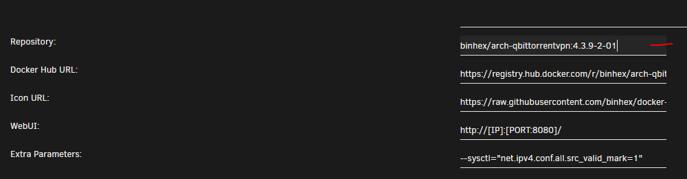

Help!
I accidentally broke my container by adding this tag to the end of the repository line:
Repository:             binhex/arch-qbittorrentvpn:4.3.9-2-01
What did I do wrong? How do I undo it? The container completely vanished after applying this.
1 minute ago, Econaut said:
Help!
On the docker page at the bottom, create a new container, then select the template drop-down and select binhex-qbittorrentvpn and it should repopulate all of your variables.
Edited by TheOgre
Some other ones are stuck in auto-rebuild and I can't actually click any buttons on the bottom. Any way to stop that?
When you say "auto-rebuild" are you saying the page keeps refreshing and the container IDs keep changing on some of the other containers?
That usually happens AFAIK when containers get names mixed up with their networking or something similar. If there are multiple containers doing it, might be best to restart the docker service and see if it continues or resolves.
Edited by TheOgre
Yeah the other ones were using this one as a network option.
Can I manually edit the original config file I screwed up somewhere?
I am pretty sure restarting docker service will result in the same. The ones auto-rebuilding weren't even started at the time.
Edited by Econaut
I'm not sure if this will work but go to http://YOURSERVER/Docker/AddContainer as a URL and see if it will let you recreate the container from there, after that the others should stop rebuilding.
Oh man... that works thanks - clever.
I did stop & restart the service though and upon restarting, the dependent rebuilding containers also vanished... I assume the same method can be used to restore them?
Very strange they vanished.... However yes, it should be the same process to get them all back if you haven't already.
Thanks - got them all back with that technique, phew...
