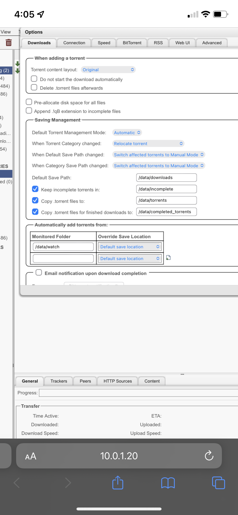

I’ve gotten several rounds of notifications of high docker image usage. Usually a warning at 90%, 91%, 92%, and then “Returned to normal”. Every time this has happened I’m always in the middle of something and don’t get a chance to investigate since the entire thing only lasts 4 or 5 minutes. Wondering if this is related to the (non) memory leak though? Just started after updating to 4.4.1.
This isn't related to memory usage but the size of your docker image. What's most likely happening is a docker is updating, at which point it expands the size of the docker image, then once completely updated, it clears the unnecessary parts of the image.
Can resolve this by increasing the size of the docker image.
I’m not so sure. I’ve never seen this sort of behavior and don’t auto-update dockers.
The docker image changes only if dockers add or update new images to it, this does not happen during normal operations. A memory leak will only cause RAM to increase, not the docker image.
The symptoms (growing usage of the image and then suddenly it decreases) sounds typical of downloading within the image and when the download is finished it gets moved to the appropriate share.
Double check your paths within the app's settings for where incomplete etc goes and make sure it's mapped outside of the container (spelling and capitalization count here)
When I first updated to 4.4.1 all my download settings reverted to defaults. I spotted that right off and reset them to the proper paths I think.
