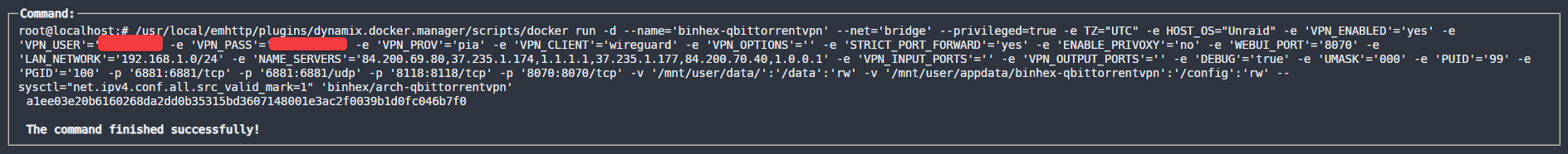

Hi... I'm unable to launch WebUI.
I've changed to port 8070 (Sab was taking default) in all relevant places and using wireguard with pia.
One thing I've noticed is that the port in supervisord.log is not open according to yougetsignaldotcom. I may have something wrong but I checked with the VPN IP & port at the bottom of the log?
I've tried adding the ovpn and cert file from pia website to the wireguard folder (is this relevant as the FAQ mentions OpenVPN folder only?) but the wg0.conf is always written on docker restart.
If there is anything else needed, please let me know, I've been on this for around 4 hours, and can't seem to find my issue in these forums or elsewhere.
Here is my compose and log attached:
Appreciate any support.
supervisord.log
....Whaaaat! So it's just started working with no changes from above... The port is still showing as closed so assuming that was a red herring and I had the wrong IP & Port from the log. Happy and sad at the same time, I like knowing root cause.
