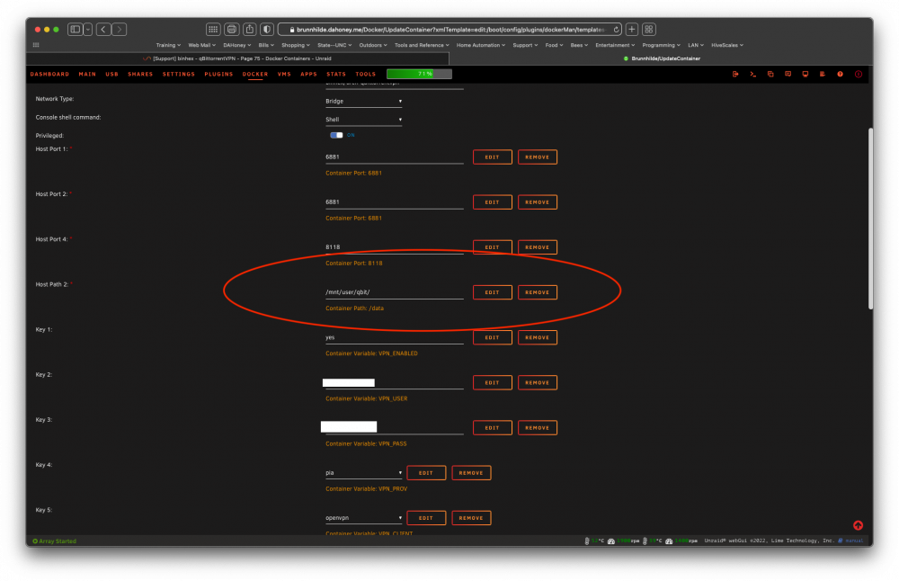

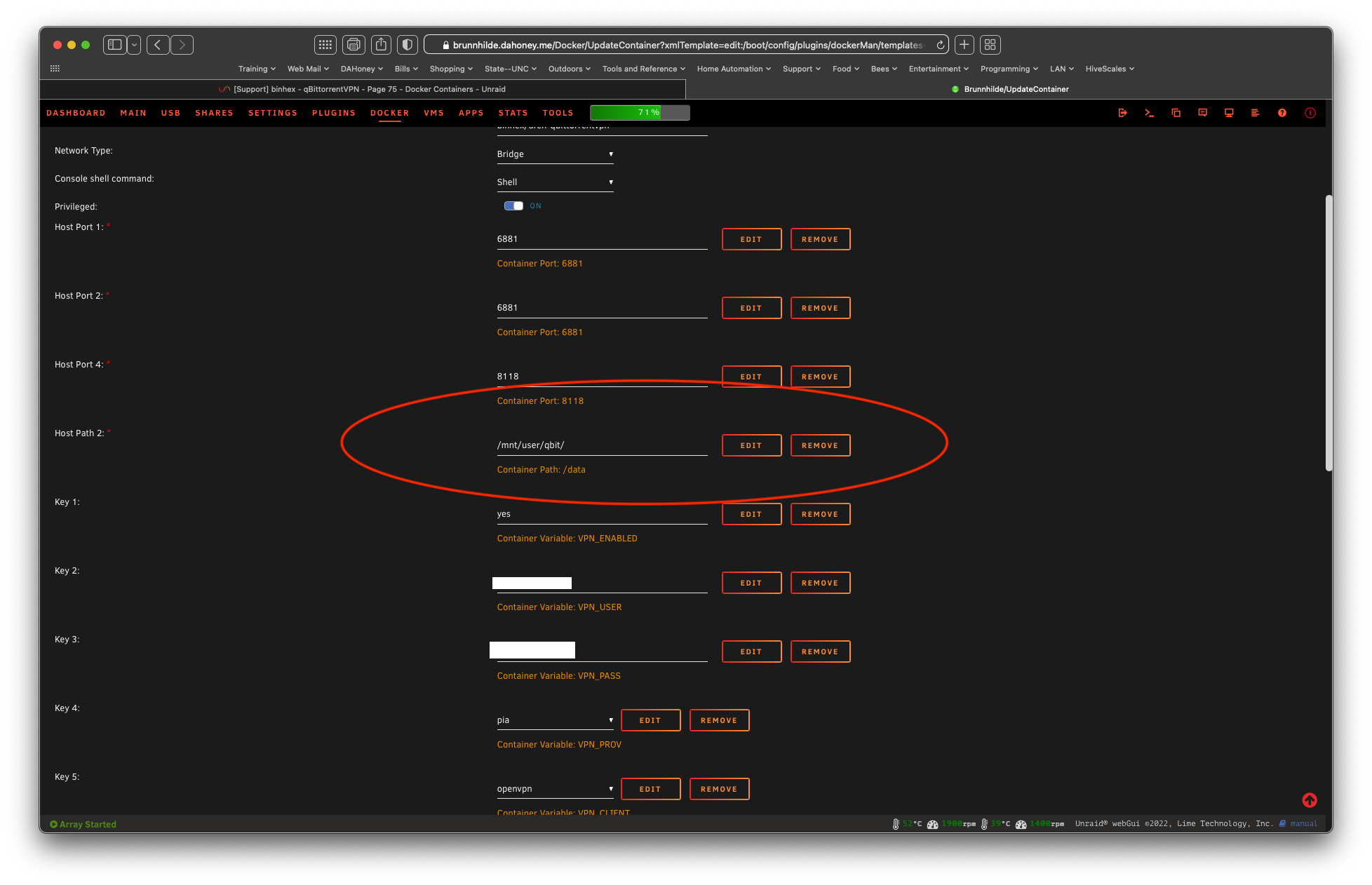

Thanks wgstarks. If want to modify the location can I provide any path? for example: /mnt/user/Downloads/. Or do I have to create "data" folder in the new path? example: /mnt/user/Downloads/data
Thanks again.
It’s /data inside the container. The container path is all the app can see. The host path is the actual location on the server where you want the files downloaded to. You set it for whatever you want.
Example:
Host path=/mnt/user/movies
Container path=/data
If I set the download location to /data on the app all files will be downloaded to /mnt/user/movies.

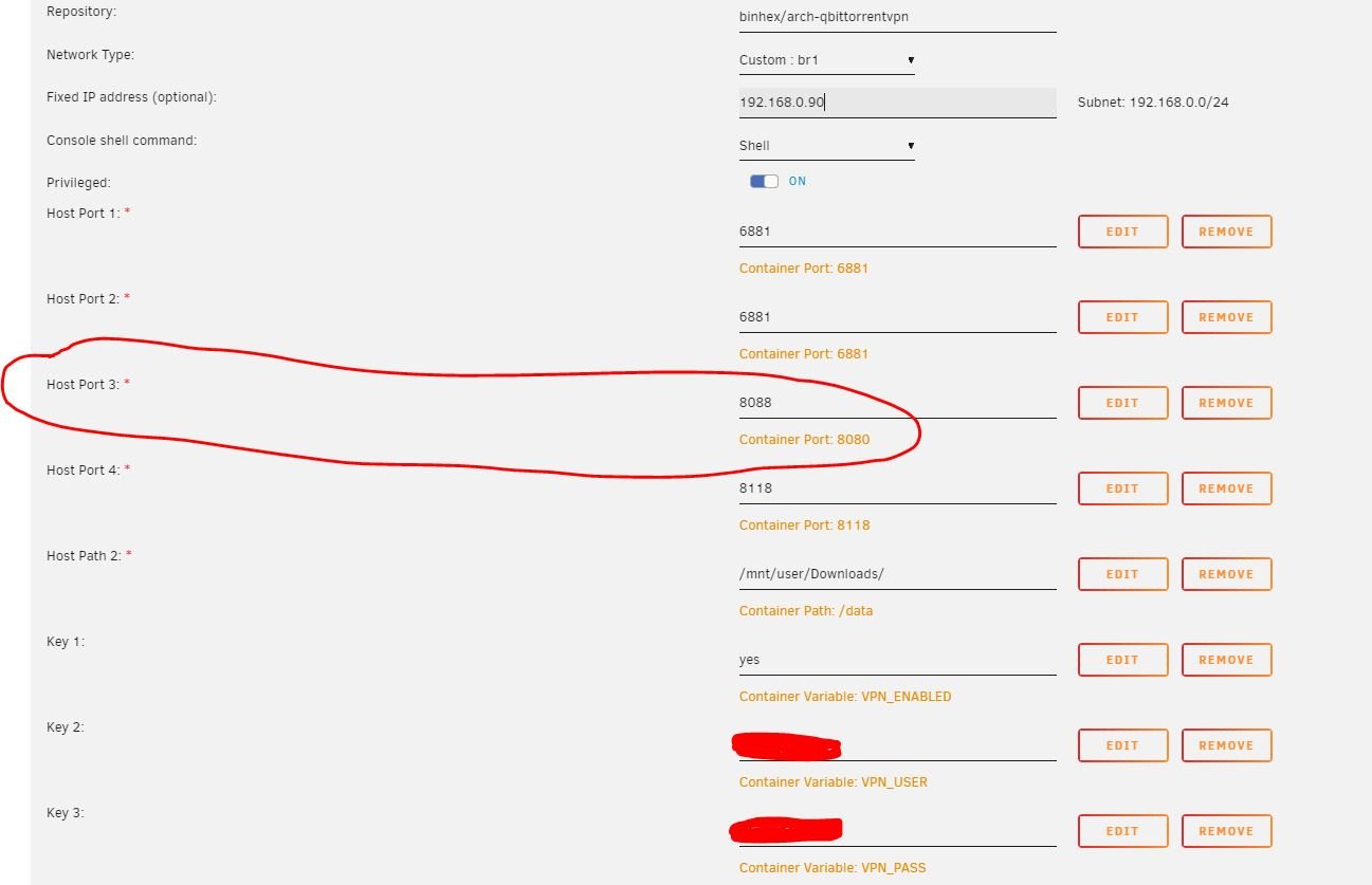

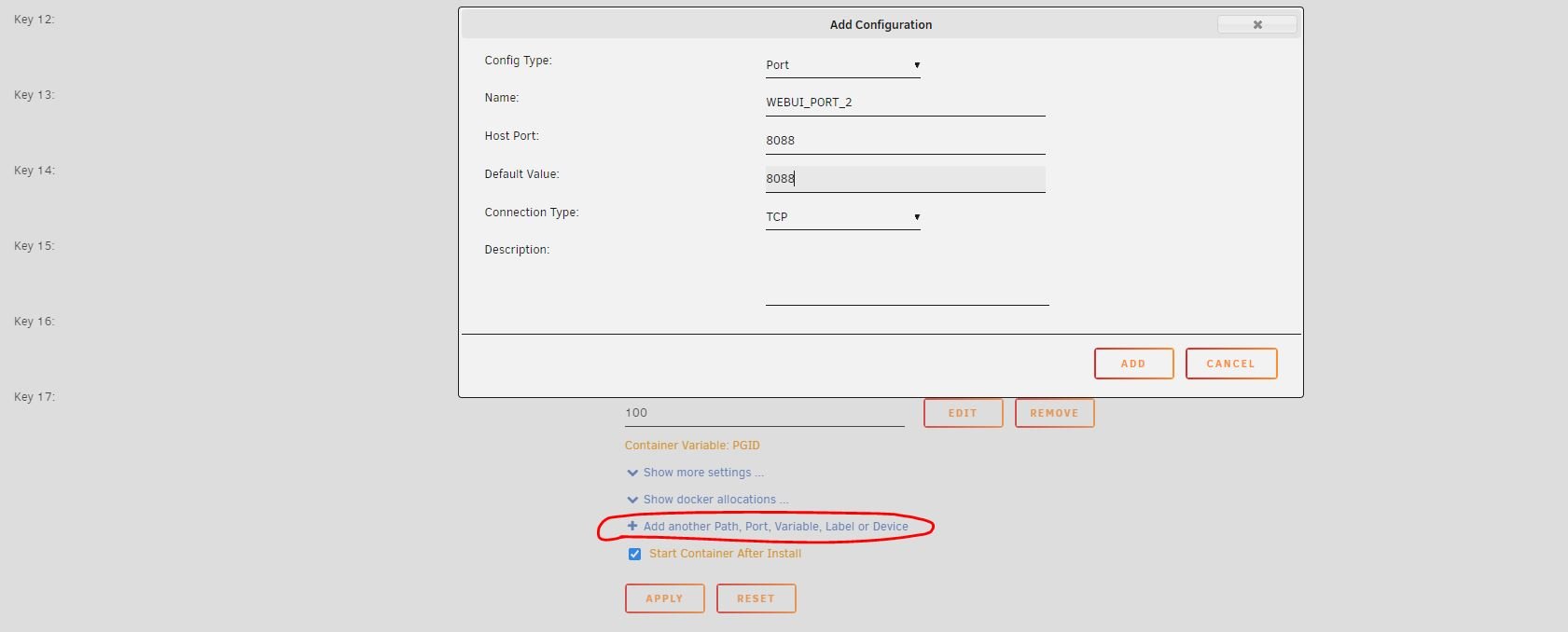

Got it! Now I am obviously having problems starting the container after changing the ports as suggested in the beginning of this thread. Of course the reason for that is my lack of understanding. Can you guide me in the right direction please?
I have done the following:
  • changed port 8080 -> 8088
  • changed port for WEBUI for 8088
  • created an additional entry path "PORT TYPE" with port 8088
I now can not start the docker. Is this something I have to change in CLI?
Thanks,

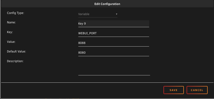

I think it's the webui variable. Should look like this-
Config type=variable
Name is up to you.
Key=WEBUI_PORT
Value=8088 (if that's what you want to use)
Default Value you can leave unchanged.
Description is up to you.
I think I followed to the "T" but still when I start the docker it shows port 8080. I think i don't quite get the directions from binhex on the page #1 where he is saying that you have to add the new port and delete the existing one.
no matter what I do, it doesn't change the default port 8080
I can't see the "Type" for the WEB_UI VARIABLE in your screenshot so check and be sure its set to "variable". Also, network type should be "bridge".

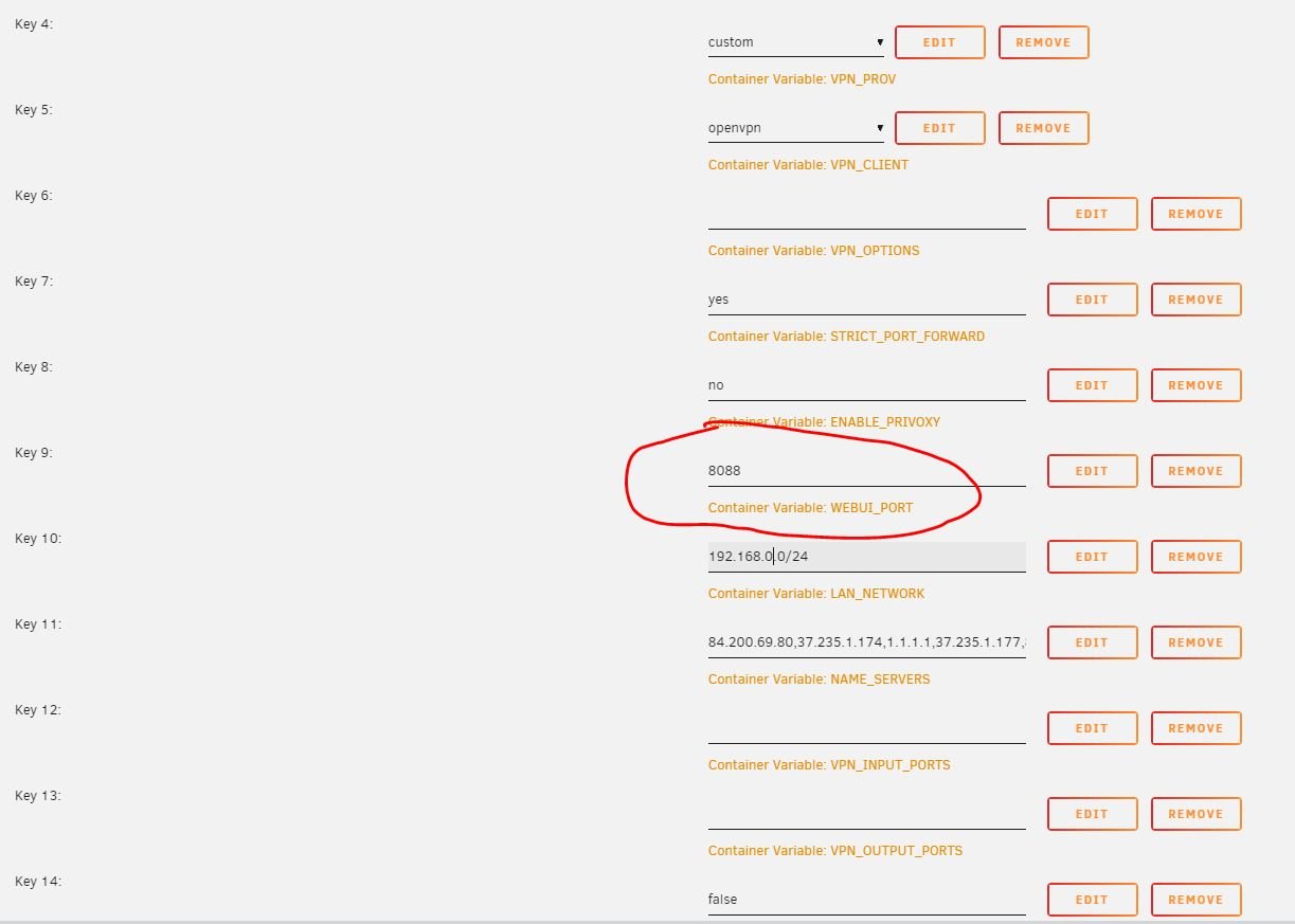

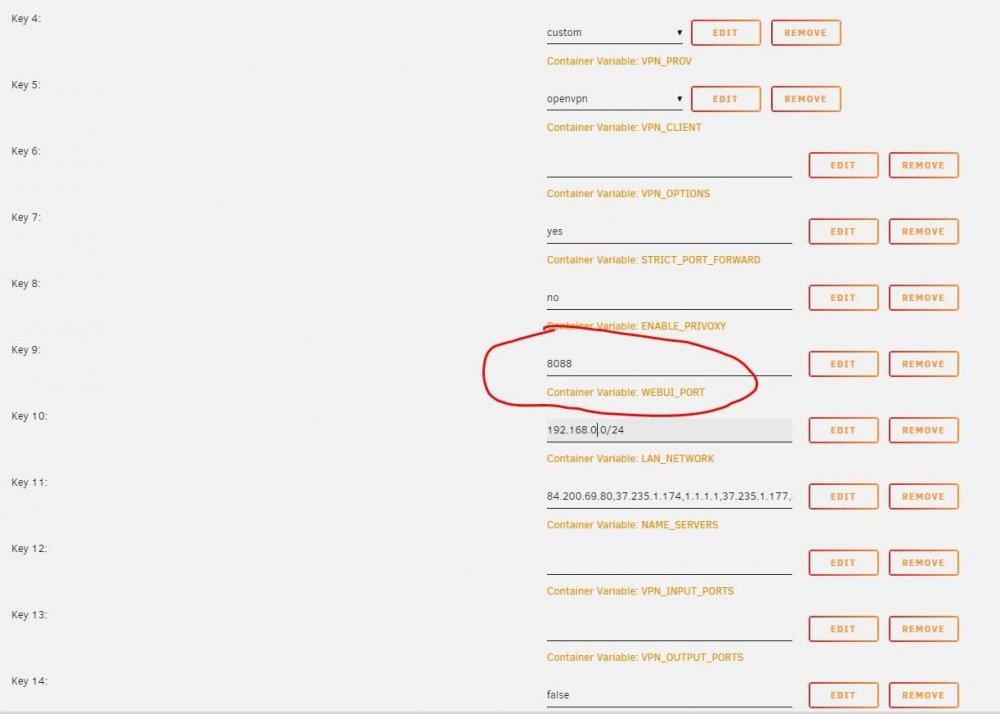

Post your docker run command.
it does change the port when I change network to bridge, but still no webui
here it is with the network set back to br1. I have two NICs on this server eth0 is bridged to br0 and eth1 is bridged to br1. bro is for the system control and VM and br1 is for the dockers. I have other dockers and VM working fine.
root@localhost:# /usr/local/emhttp/plugins/dynamix.docker.manager/scripts/docker create --name='binhex-qbittorrentvpn' --net='br1' --privileged=true -e TZ="America/New_York" -e HOST_OS="Unraid" -e 'TCP_PORT_6881'='6881' -e 'UDP_PORT_6881'='6881' -e 'TCP_PORT_8088'='8088' -e 'TCP_PORT_8118'='8118' -e 'VPN_ENABLED'='yes' -e 'VPN_USER'='vpn username' -e 'VPN_PASS'='vpn password' -e 'VPN_PROV'='pia' -e 'VPN_CLIENT'='openvpn' -e 'VPN_OPTIONS'='' -e 'STRICT_PORT_FORWARD'='yes' -e 'ENABLE_PRIVOXY'='no' -e 'WEBUI_PORT'='8088' -e 'LAN_NETWORK'='192.168.0.0/24' -e 'NAME_SERVERS'='84.200.69.80,37.235.1.174,1.1.1.1,37.235.1.177,84.200.70.40,1.0.0.1' -e 'VPN_INPUT_PORTS'='' -e 'VPN_OUTPUT_PORTS'='' -e 'DEBUG'='false' -e 'UMASK'='000' -e 'PUID'='99' -e 'PGID'='100' -v '/mnt/user/appdata/data':'/data':'rw' -v '/mnt/user/appdata/binhex-qbittorrentvpn':'/config':'rw' --sysctl="net.ipv4.conf.all.src_valid_mark=1" 'binhex/arch-qbittorrentvpn'
a0cbe5f8248e40a706e990a03ba5eaa8109d67e85728b242f09e74f8dd3e1fc1
The command finished successfully!
