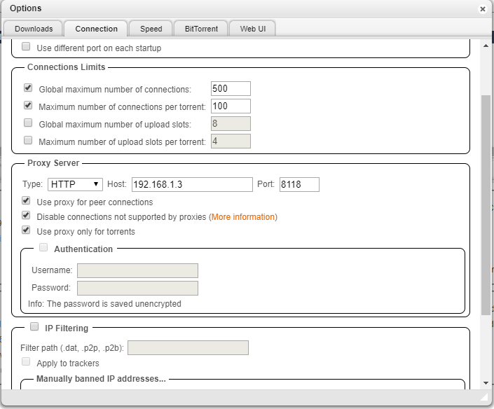

I have tried enabling Proxy Settings in qBit through Tools > Options [Connections] / Proxy Server
But the max download speed I can get is around 2MiB/s
Remove those settings and I can download 45MiB/s

Privoxy is only able to proxy http(s) traffic, it is not a socks proxy, and therefore if you configure a torrent client to use it then you will only be proxying http(s) traffic, all other traffic will be going via your ISP and thus IP leakage will occur.

Just got qbittorrent installed, everything appears to be working, but I'm getting a ton of errors in unraid log.
Jun 24 14:48:42 Tower nginx: 2019/06/24 14:48:42 [error] 4938#4938: *819467 connect() to unix:/var/tmp/binhex-qbittorrentvpn.sock failed (111: Connection refused) while connecting to upstream, client: 192.168.1.217, server: , request: "GET /dockerterminal/binhex-qbittorrentvpn/ws HTTP/1.1", upstream: "http://unix:/var/tmp/binhex-qbittorrentvpn.sock:/ws", host: "192.168.1.6"
I did have to change the host for the webui from 8080 to 9090 as 8080 was already being used.  To do this I deleted the ports that were in the config (the one pointing to 8080), changed the webui container variable to 9090 and created a new TCP port for 9090:9090.
Is that the right way?
This is happening even when I'm not connected to qbittorrent via a web browser in any fashion.
I can post more info if needed.  Thanks.
