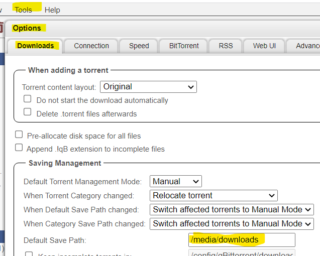

1. How do I know the VPN is working?
2. Do I have change the download location in Qbittorent to /data?
17 hours ago, erfly7 said:
Thanks figured it out
Finally started, had one number in LAN_Network wrong
1. go to check the logg.
   In there you vill have a line like this "[info] Successfully retrieved external IP address 123.123.123.123 "
   thats says your ext ip adress is. it shuld not be the same as your computers external ip adress. EDIT: just rememberd you can che the IPs here http://checkmyip.torrentprivacy.com/
2. If i remember correct you need to change it. Do it here.  Your is probably /data
