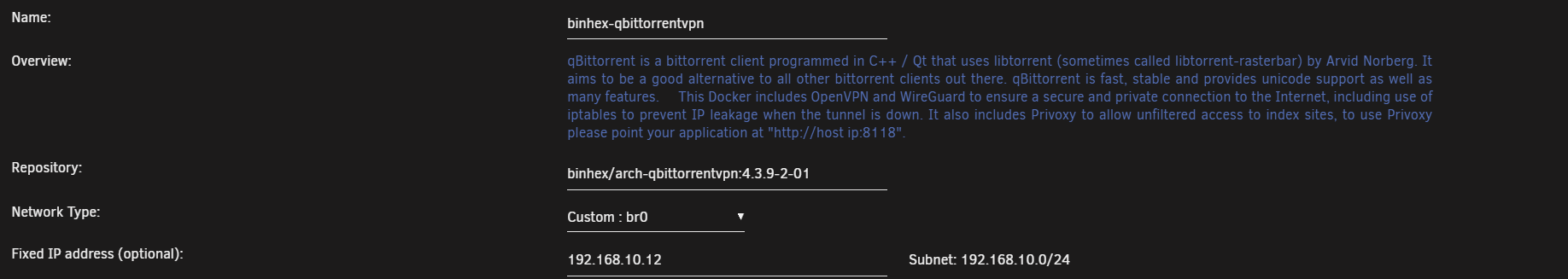

  • I rolled back to tag 5.1.1-1-01 which fixed the issue for me. I guess the new update wasn't tested for wireguard connections. Edit the docker container and change "Repository" from binhex/arch-qbitt

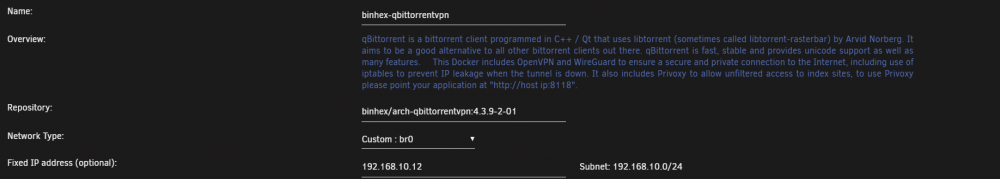

On 6/4/2022 at 11:09 AM, WenzelComputing said:
i gave up on waiting for an official fix. here is my unofficial fix:
go back to 4.3.9 version.
new version is completely broken.
Also was getting this issue when enabling vpn yes on the latest tag.  I loose all access to the gui.
Rolled back as per the previous posts has brought me back up and running.
Obviously not a full solution.

So, I had Qbit configured and we lost power yesterday due to storms and Qbit is now broken. I cannot get the WebUi back up without starting over. Would I need to go to an older version? If so, how do I find older versions?
Thank you.
You can switch versions by typing a colon after the name in the repository field followed by the tag number.
You might start by attaching your supervisord log to your next post though.

99% of the issues seem to be with upstream qbittorrent, the 4.x versions have been a problem outside of docker on windows and linux. I've had endless problems with very large torrent download just throwing an error with nothiing in the logs.
I rolled back to 4.3.9 and its been rock solid since.
