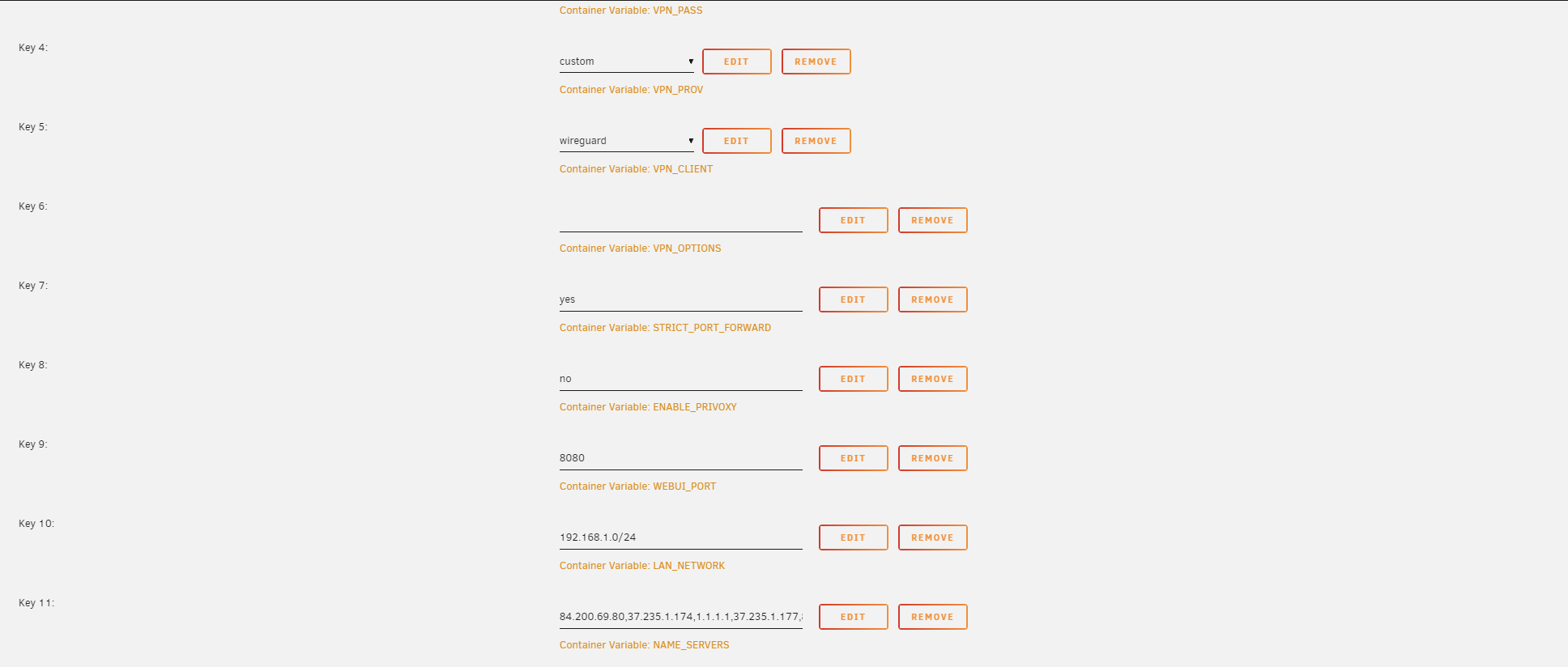

    Hello! I have been using wireguard successfully for a long time with this container, today though when the container restarted I got the following error: 2025-06-27 10:35:26,490 DEBG 'start-script'

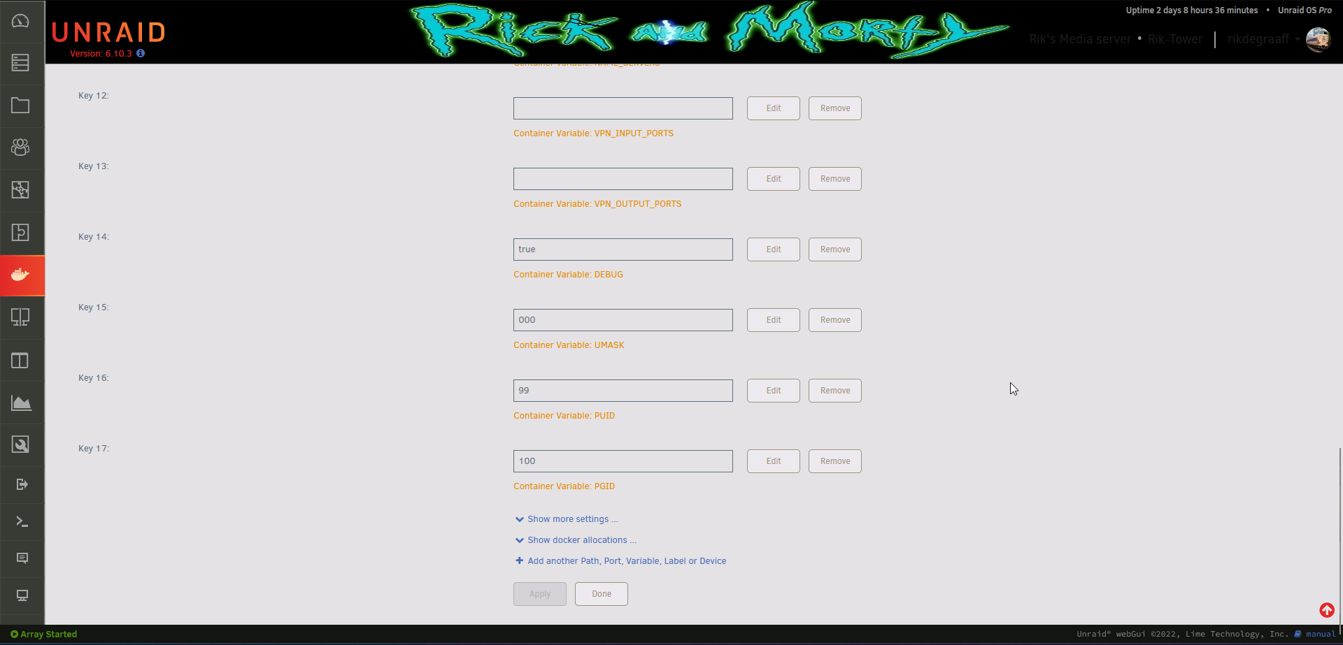

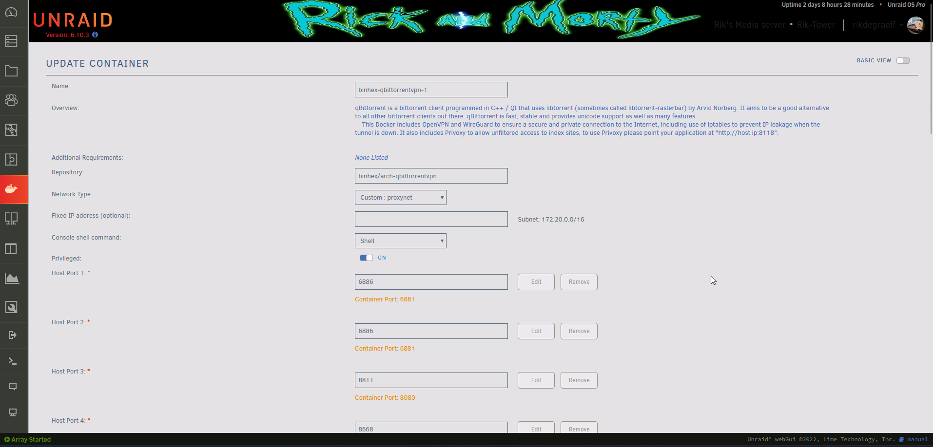

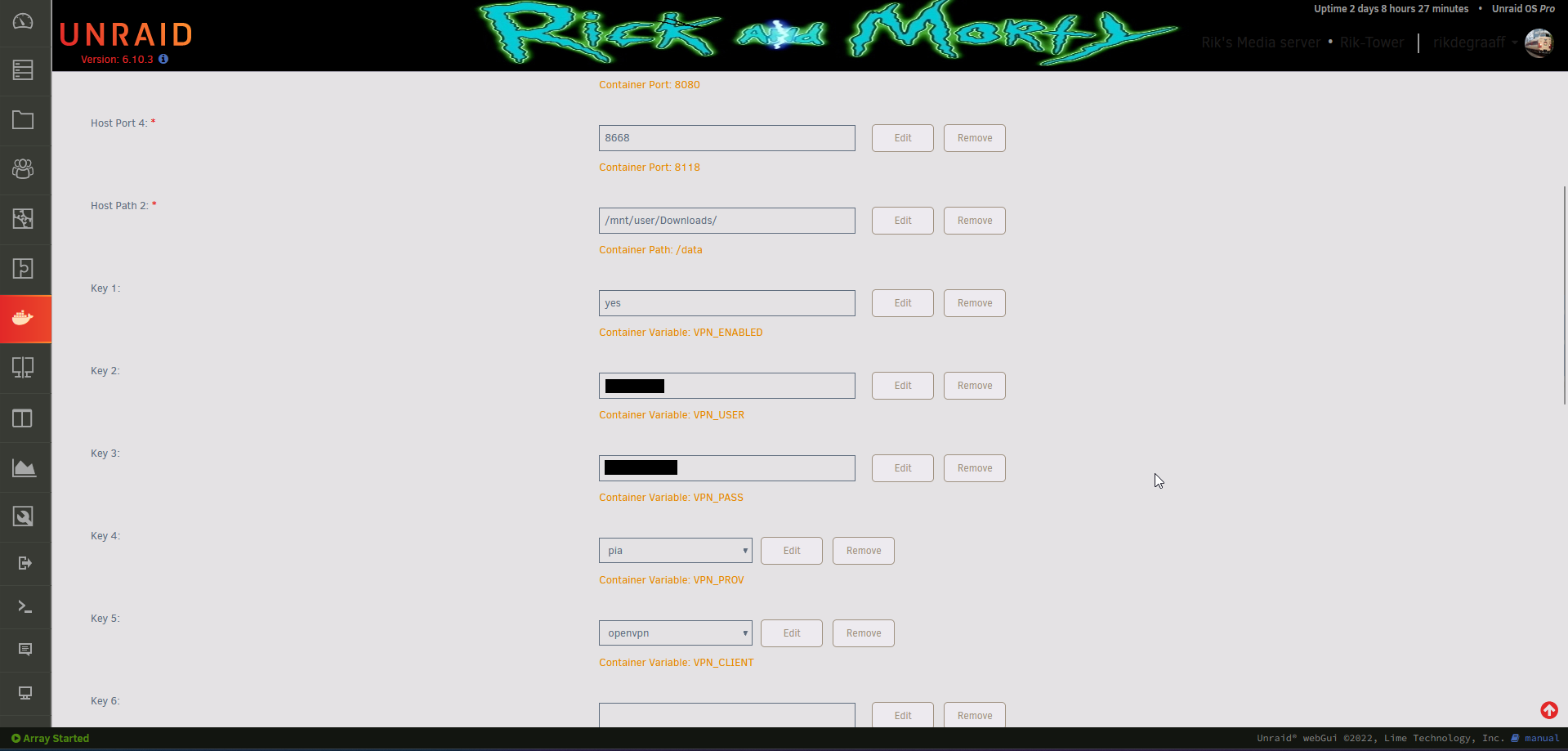

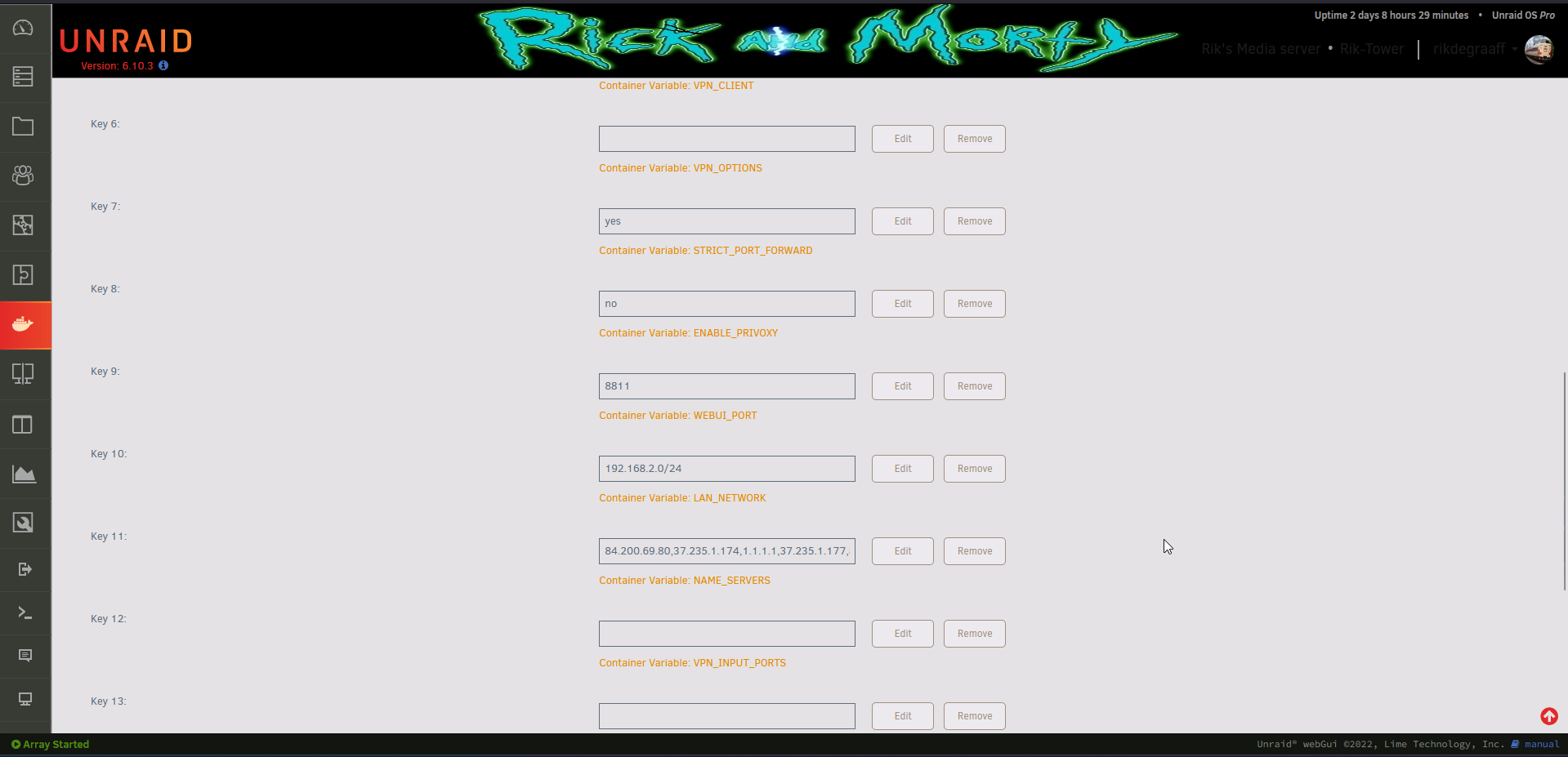

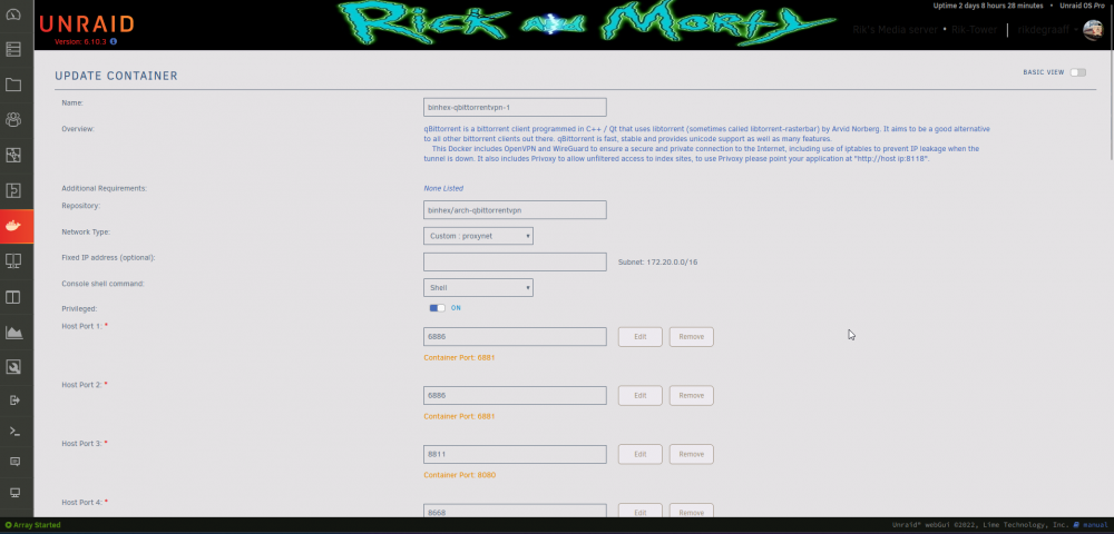

Noob question, but how does one roll back to an older version of an unraid docker?
Click the name of the docker on the docker tab. In the repository field type a colon after the name followed by your desired tag number.
Edited by wgstarks

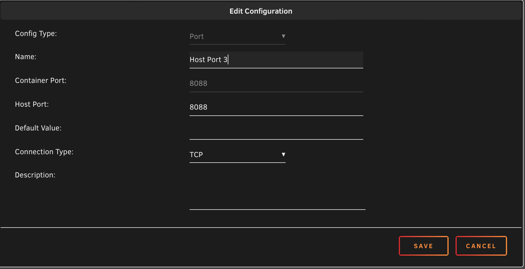

If you change the webui port to a custom port you need to create a new port mapping for that port. For mine I used port 8088 so i created another port mapping shown below-
2137482099_ScreenShot2022-07-06at8_58_19PM.thumb.png.6954cd65c57c3eebdbf61c38e5c5e0d2.png
The name is up to you. Just change 8088 to whatever port you're using.
Edit: Actually, its been a while since I set this up but IIRC you need to delete the existing 8080:8080 port configuration (you can't edit it) and then create the new port configuration.
Edited by wgstarks

I am migrating from your Deluge VPN to this qBittorrent VPN docker, and when I do that, I can't get Jackett to use the proxy successfully, all searches result in the indexer reporting all sites are in error. I switch Jackett back to Deluge, and it works.
My IP address is in the format 192.168.0.*
My LAN_NETWORK for Deluge is 192.168.1.0/24 and I tried this on qBittorrent however this seems wrong, I think it should be 192.168.0.0/24 but neither works for qBittorrent. I am able to successfully use qBittorrent to make downloads, so I know the container works to some degree at least.
What info would you like to see here? Or ideas on the issue?

Already posted this question here, but @JonathanM told me to ask it here also:
Hello all,
I am the whole afternoon/evening busy with getting a second image of the same docker template, binhex-qbittorrentvpn, up and running.
I did change all the standard ports to different ports, all folder associations also to new folders, but I still cannot reach my webUI.
Here are the template settings, adjusted by me:
firefox_YvXQjxgkna_cropped.thumb.png.2ad05bf74b71fb836d54ef549bb0a0fa.pngfirefox_ndUwZ9Y5Gl_cropped.thumb.png.4b3d6b5efa934a3ac86939924529bf5b.png
The image is running, openvpn configuration files are supplied in the new folder, and the only thing that doesn't work is the webUI.
I put in <server-ip>:8811 as that is set to the new webUI port.
The docker log of that new image also says "[info] qBittorrent process listening on port 8811".
So what is it that I cannot reach the qBittorent webUI on above ip address and port.
FYI; the 1st docker image of qbittorrent does work like a charm...
Some help is much appreciated. Thanks!
