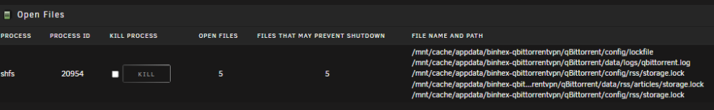

After upgrading to unraid 6.11 i notice for the first time I run into some problems with my qbittorrent (4.4.5-1-01). The VPN is disable.
For the first i couldn't login to the webgui. Then I try to stop the container from the unraid. But it fails big time.
This is the error i found:
Sep 25 08:44:56 Tower root: Error response from daemon: cannot stop container: binhex-qbittorrentvpn: tried to kill container, but did not receive an exit event
Sep 25 08:44:56 Tower root: Error response from daemon: error while removing network: network br0 id f564b69135e76d78b145214998f5739d7ec44224c468282466b2c9f4702a8b3b has active endpoints
I also was trying to KILL it, but it didn't help.
And this also prevent me for stopping the Array.
Found this info:
Sep 25 08:49:20 Tower root: umount: /mnt/cache: target is busy.
Sep 25 08:49:20 Tower emhttpd: shcmd (471): exit status: 32
Sep 25 08:49:20 Tower emhttpd: Retry unmounting disk share(s)...
Sep 25 08:49:25 Tower emhttpd: Unmounting disks...
Sep 25 08:49:25 Tower emhttpd: shcmd (472): umount /mnt/cache
Sep 25 08:49:25 Tower root: umount: /mnt/cache: target is busy.
Sep 25 08:49:25 Tower emhttpd: shcmd (472): exit status: 32
Sep 25 08:49:25 Tower emhttpd: Retry unmounting disk share(s)...
Sep 25 08:49:30 Tower emhttpd: Unmounting disks...
Sep 25 08:49:30 Tower emhttpd: shcmd (473): umount /mnt/cache
Sep 25 08:49:30 Tower root: umount: /mnt/cache: target is busy.
Sep 25 08:49:30 Tower emhttpd: shcmd (473): exit status: 32
Sep 25 08:49:30 Tower emhttpd: Retry unmounting disk share(s)...
I ended up to reboot my unraid server. :(
