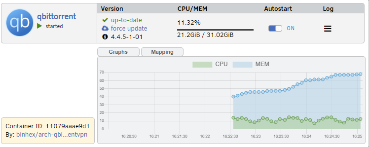

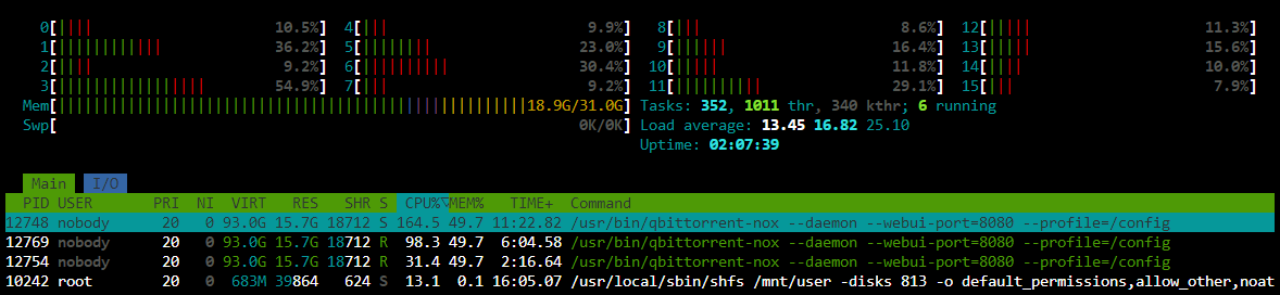

I was wondering if there's a way to run a custom postup script. There's already one defined and overrides any changes made, so is there currently a way to add a custom script along side the pre-defined one?
I just rolled back to 4.4.5-1-01, what is going on here? If Qbittorrent runs for more than 5-10mins, its using up all my RAM and CPU? I updated to Unraid 6.11.1 (just did 6.11.2 now) today too, is it trying to download my files to RAM now???
Edited by Linguafoeda
What are you using to get those graphs for the CPU and RAM usage of the container?
