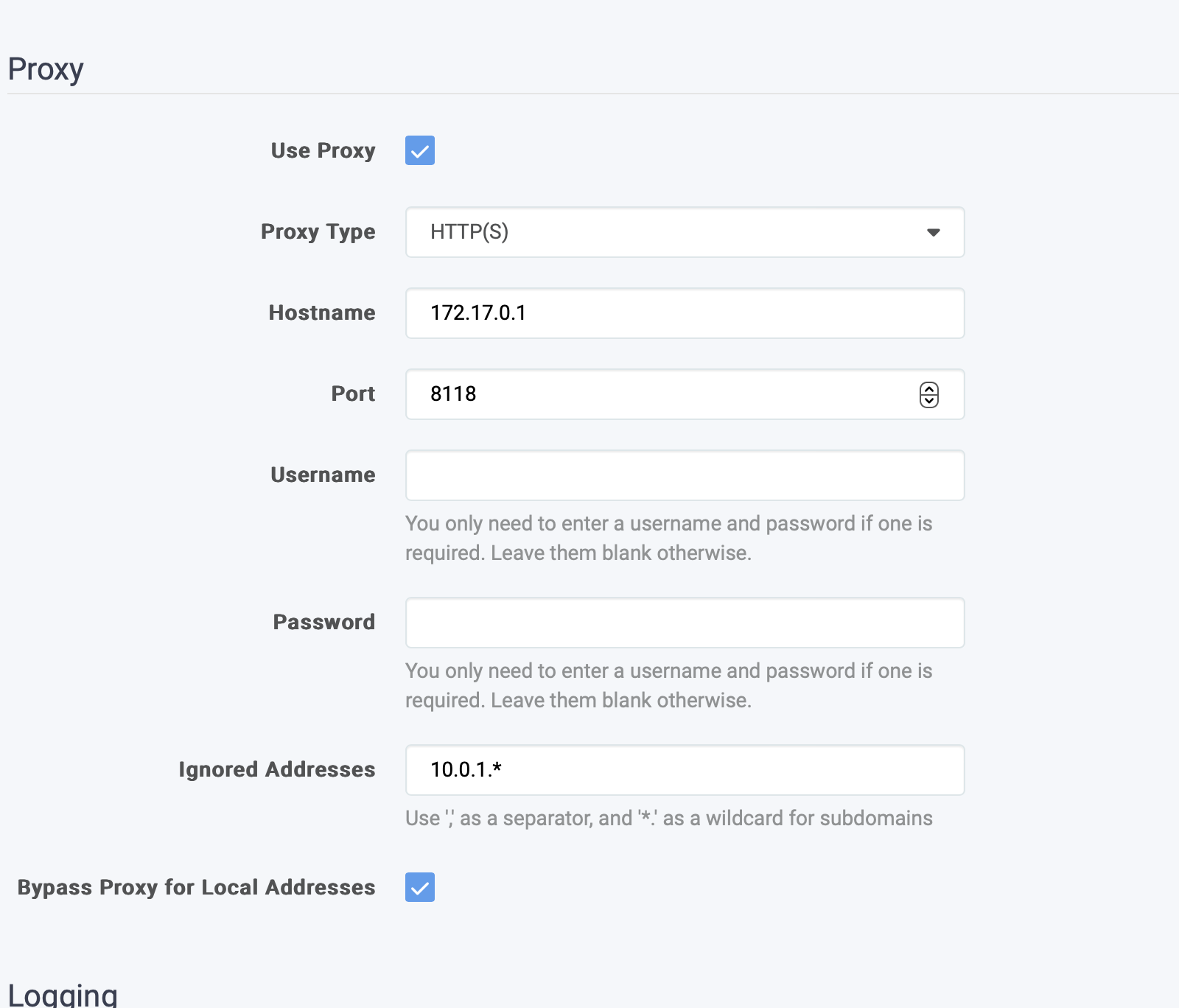

Ok. There isn't really any special configuration other than the proxy setting in the *arr. Here is a screenshot from my Radarr app Settings>General.
1498324937_Screenshot2022-12-26at10_30_46PM.thumb.png.efe0b9ca3039458f22f164f8eb41a7bb.png
Yours should be set the same. This will route all searches through the vpn. You will need to use the same settings for Sonarr, Prowlarr, Jacket, etc.
Adjust the ignored addresses to fit your network. My LAN is 10.0.1.xxx.
You should also use the same IP when setting Qbit as your download client. Just a different port number.
172.17.0.1:8088

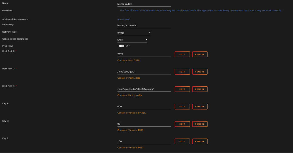

I guess I'm dumber and noober than I thought. How do I get to the WebUI at all for an arrr in order to make these changes?  Am I following the spaceinvader video to a certain point, .ie, still listing None for network and adding the extra parameter?  Or am I installing it as is with a Bridge network setting to get to the UI temporarily?

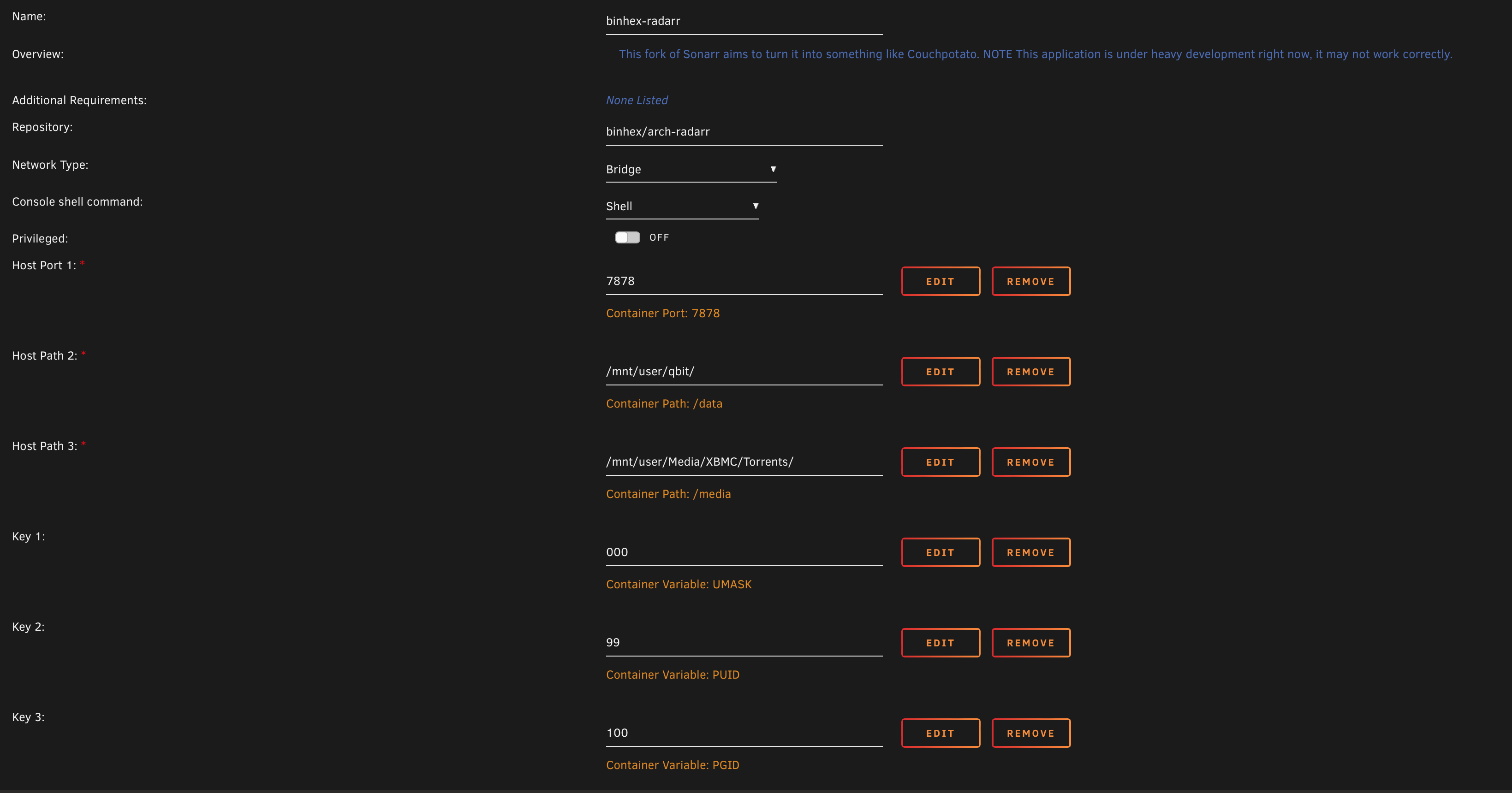

Here are the settings for Radarr-
698897808_Screenshot2022-12-26at10_58_02PM.thumb.png.491ee9ae6493c8e247a2211ffd54e661.png
Use your own host paths of course. These are NOT temporary settings. You won't need to change them later. You'll be able to access Radarr using the webUI link from the docker tab.
Also, no extra parameters.
