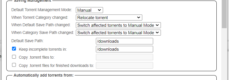

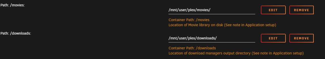

11 hours ago, Elmojo said:
It's nesting the folders for some reason.
Sounds like you missed the opening / when you changed the path to /data
I don't think I did. Please take a look at the screenshots I posted, if you have a moment. Do they look correct to you?  This whole thing is just baffling, and super frustrating.  It was all working so well, and now it's a hot mess.

21 hours ago, Elmojo said:
This appears correct, is it still identical? Problem is, I don't use this app, so I'm not familiar with all the possible locations for paths in the config. Your nested paths would be what would happen if the app appended data to the end of the config path instead of referencing it literally as /data
Does the format of the file names match files that are being downloaded or is it a match for the file renaming being used by Radarr or Sonarr?
Yep, looks just like that.

2 hours ago, Elmojo said:
sure enough, it's pointing to /downloads and /downloads/incomplete.
There's your problem. It's got to be /data in both containers. The mapping from /mnt/user/... to /data has to be identical in both containers.
Ok, so I fixed that, I think, but that didn't remove the error msg from Radarr, and Sonarr is still refusing to import any files downloaded. It still just says "no files found are eligible for import in /data/downloads/..."   If I try to manual import, I get "No video files were found in the selected folder".  *sigh*
Holy crap, I think I have it fixed!!!
I found a guide by TRaSH that explained it with pictures in a way my dumb self could understand. :)
I had to add back in the remote path mapping, and change it a bit from what I had previously, to match the new "/data/" schema were using now, but once I did that it started importing the files and clearing out the backlog!
Oh man, what an ordeal.  I hope I have enough notes and screenshots now that if this happens again, I can fix it myself without having to hassle you kind folks.  Thanks so much for you all your help.
