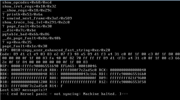

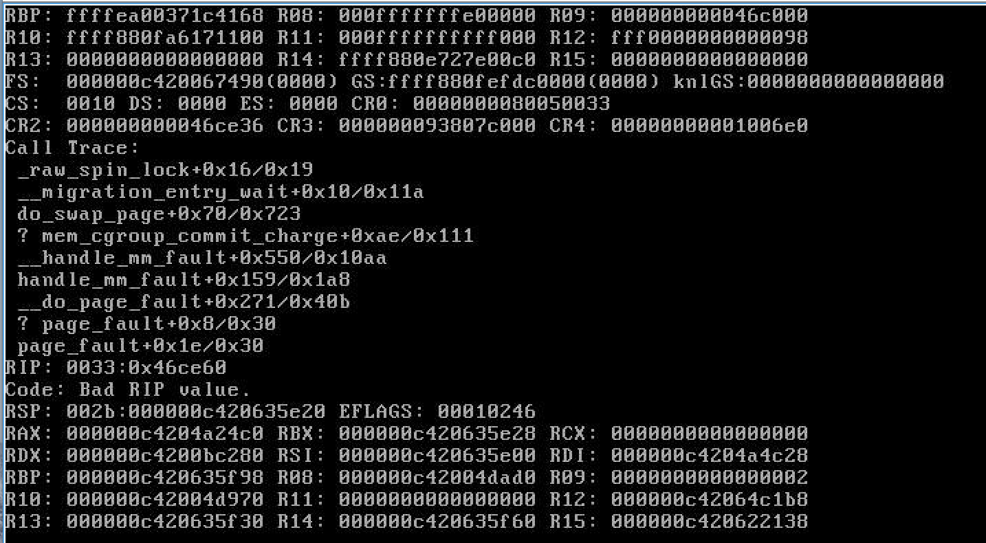

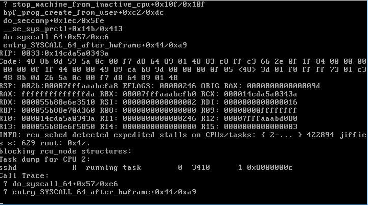

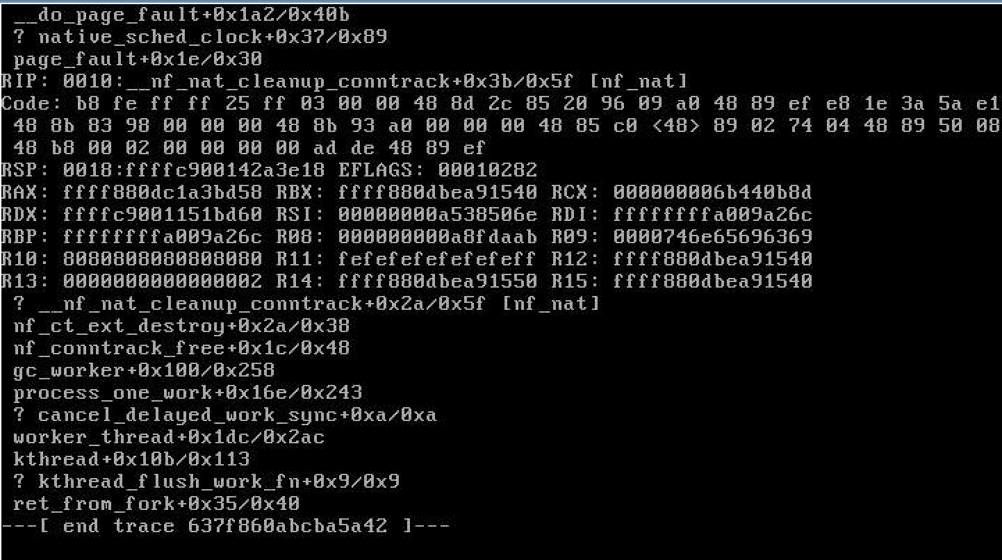

Regular Kernel Panics UNRAID v6.6.3
I've had a few, fairly consistent Kernel panics on most version of UNRAID v6.6.x, I can't say exactly when it started because I didn't always notice them, and I think I blamed a couple initially due to some power loss we had.
Hardware is a Supermicro MBD-A1SRi-2758F-O Mini ITX Server Motherboard. It's been running just fine previously with Proxmox and previous versions of UNRAID. I also have all drives connected to an LSISAS2008 : FWVersion(18.00.00.00), ChipRevision(0x03), BiosVersion(07.35.00.00) (SAS9211-8I 8PORT Int 6GB Sata+sas Pcie 2.0) which I believe is used by a few people here. Additionally I have 64GB of ECC ram. All of this has been running solid for a few months (since at least December of last year to maybe a month or so ago). I've got 4 1-GB NICs aggregated together to a Unifi switch which is configured for aggregation.
I have IPMI on this device, but I can only see the last bits of the console, what I've captured is attached, but i fear the useful information will be above those screens from what I can tell.
I was using AFP on this server, I saw an article saying this might cause some issues so I've disabled AFP altogether (was using for TimeMachine backups). Only a few docker containers binhex-jenkins, duckdns, letsencrypt (not running), Netdata (not runing), unifi. And all up to date.
I enabled the mcelog, or thought i did, with nerdtools but I don't see if running, I may need to something else. I also setup the CA Fix Common Problems and did everything it said to do. The usage on this system is pretty light. Right now its mostly just used for backups from a couple of Proxmox servers and their backup schedules don't seem to correlate with the panics...that I can tell.
Is there a correct way to make sure mcelog is running and logging? What else can I do here to troubleshoot this? I just no updated to 6.6.5, would like to make any other settings changes now that I have a reboot and try and see if I can catch this thing and get some usable data.
