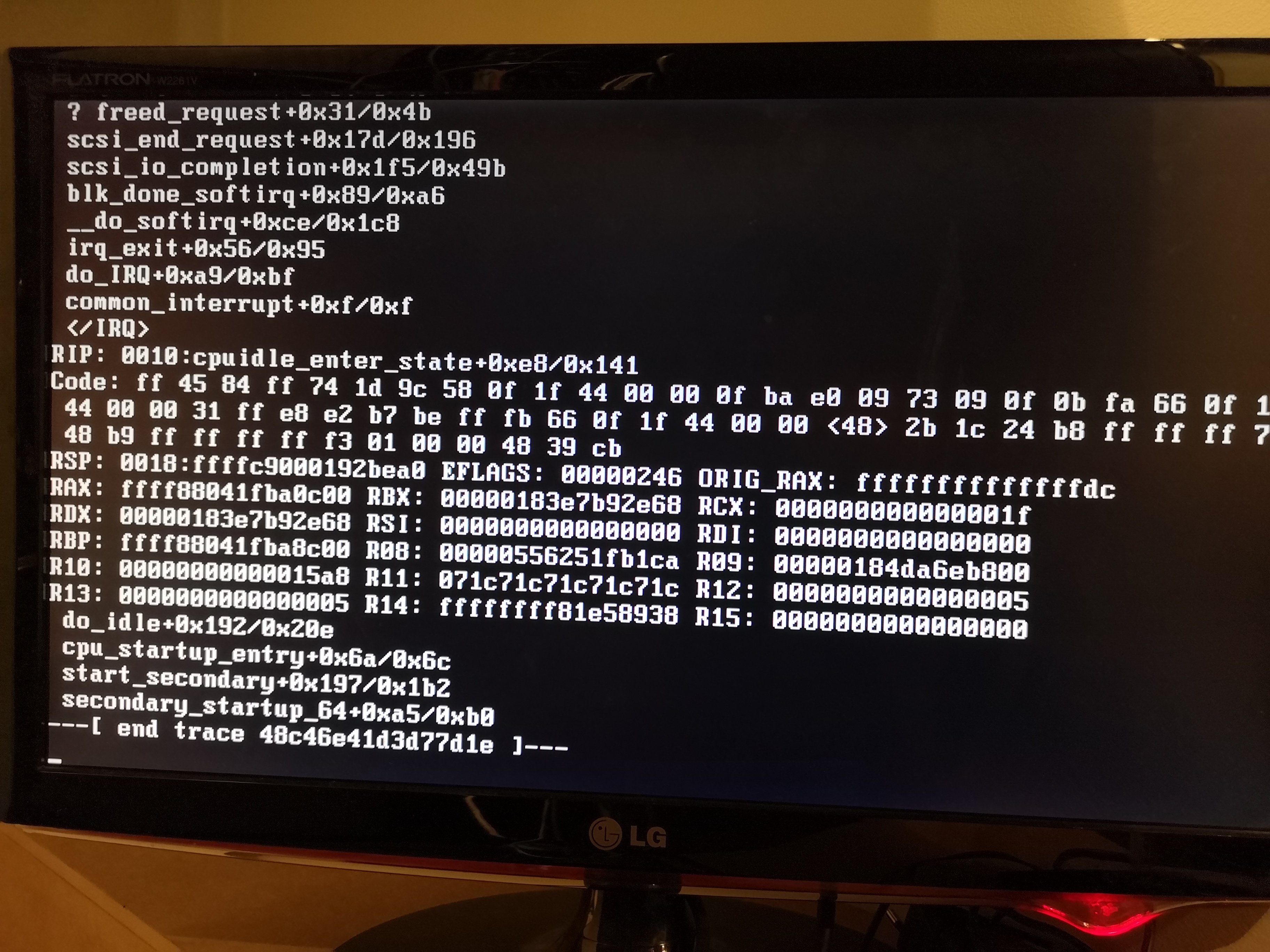

Yesterday a 2tb drive failed, i was going to replace it anyways but was waiting until black friday. So I went and bought a new drive today, 8tb WD red. My initial plan was to first change parity in a couple of weeks, then replace the old drive, but since it failed two weeks prior to my plan I now need to do something different. I read in the wiki about the parity swap procedure and have followed all the steps. Everything is fine until it isn't, i cannot get a log but took a picture of the monitor that is attached to the server atm.
I've tried three times now with the same result.
I am now in the process of pre-clearing the new drive just to see if the server will stay alive long enough. Any advice would be very helpful at this point.

In addition, while the picture is helpful to see, logs are even more vital.  You can actually get the logs to show up on the screen by typing the following command after logging in as root:
tail /var/log/syslog -f > /boot/syslog.txt
This will do two things:
 - Put the log as it's growing directly on the screen
 - Save the contents as it's written to your USB flash
If the server crashes again and the message appears the same on screen, shut down, remove the flash, plug it into your PC, and post the syslog.txt file you find there here on the forums so we can review.

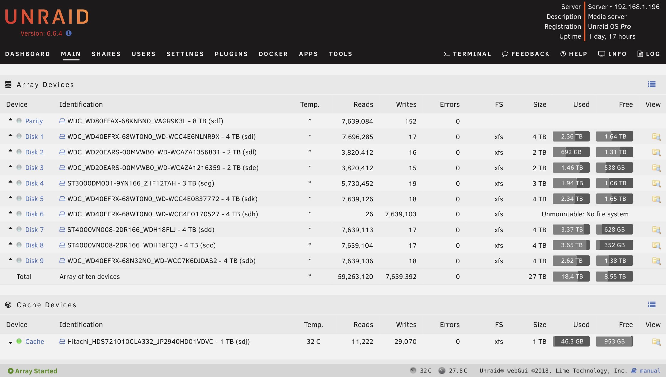

Copying went fine, and also parity rebuild. But now i have a problem, the old parity, which i used to replace the broken disc according to the parity swap procedure, doesn’t seem to be included.
So how do i proceed from here in order to not loose any data from the broken disk?
these are my options, feels like something is missing

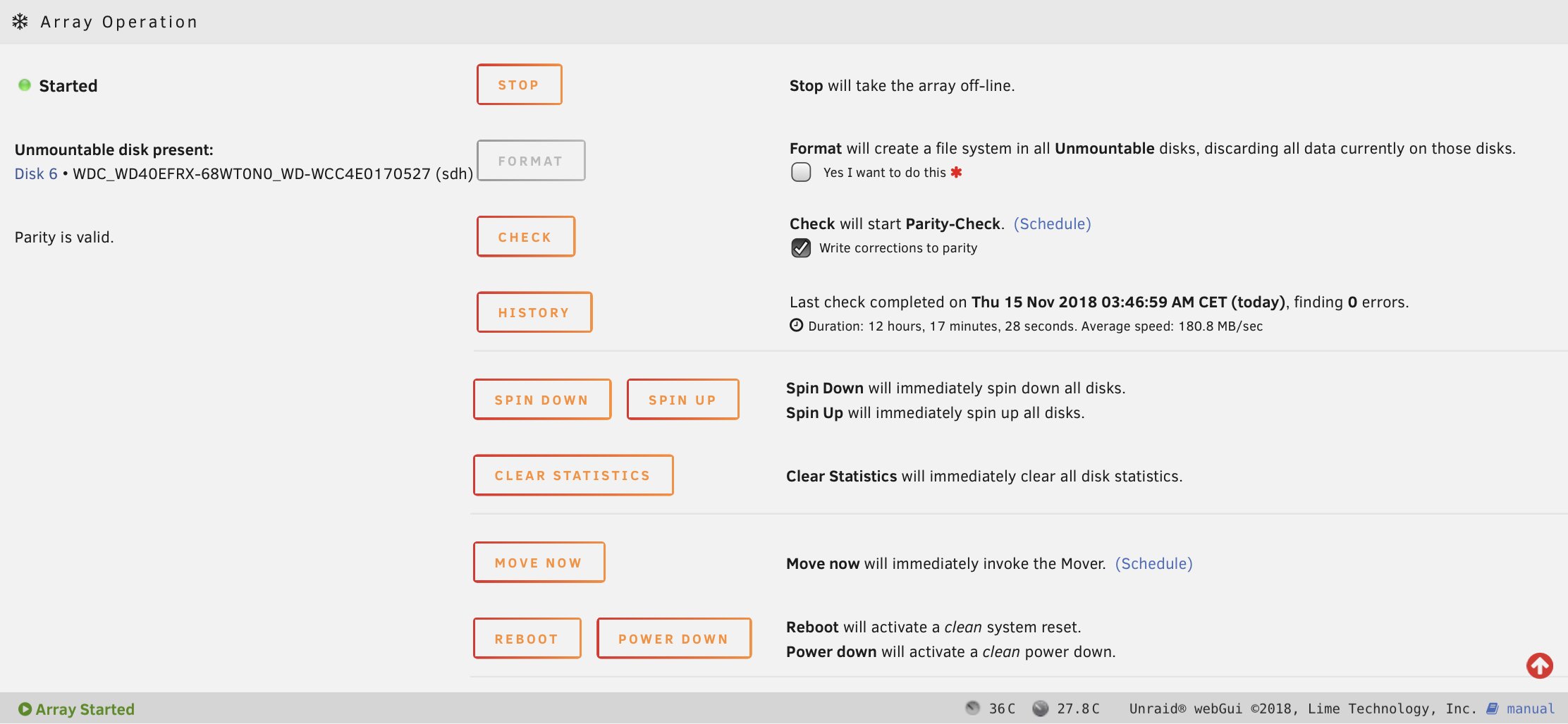

Just to clarify in which order everything happened and why i want to be sure it’s correct before i format the drive.
1. disc 6 died a few days ago.
i wanted a bigger parity so followed this guide:
https://wiki.unraid.net/index.php/The_parity_swap_procedure
2. Bought a new 8tb drive and put that in.
3. After disabling disc 6, starting the array i proceeded to do the parity swap.
4. The old parity is kow disc 6, but first it gets copied to the new parity.
5. New parity copy complete. Data rebuild started i thiught, but maybe it was a parity check instead?
the old parity should have no filesystem, so that is correct, but i thought the process of rebuilding the array was complete.
Log only shows disk6 rebuild, it should also show the parity swap, so something is missing from your description, the rebuild should have been done immediately after the parity copy and without rebooting, perhaps there was some issue with the server during the rebuild and you rebooted and it would start from the beginning, in that case it might be OK.
Well i do have an 8tb parity now, it was 4tb before.
Yes you do, but the log doesn't show the parity swap, i.e., the server was rebooted after doing it, but it does show disk6 rebuild, and that should have been done right after parity swap, not after rebooting.

Afaik i have not rebooted.
uptime on server is 1 day 18 hours 39mins
the parity check or rebuild whichever it did, was completed 03.46 so approx 12 hours ago, it lasted for 12 hours 37 mins. Before that the server was copying the parity.
just checked timestamps in forum and i wrote 4% copying on tuesday 09.30, which corresponds with uptime.
Edited by chiz

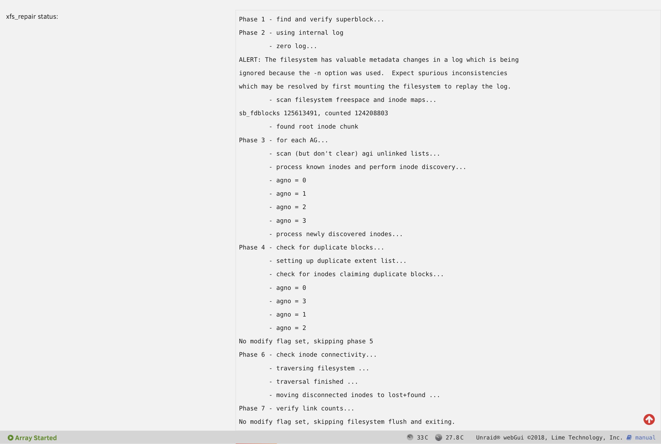

Sorry, you're right, I don't know how but I missed the parity copy part, just check filesystem on disk6.
P.S. there was a CRC error on disk8, just one so far so not a big deal, but if there are more in the future replace the SATA cable.
You need to remove the -n (no modify) flag or nothing will be done.
