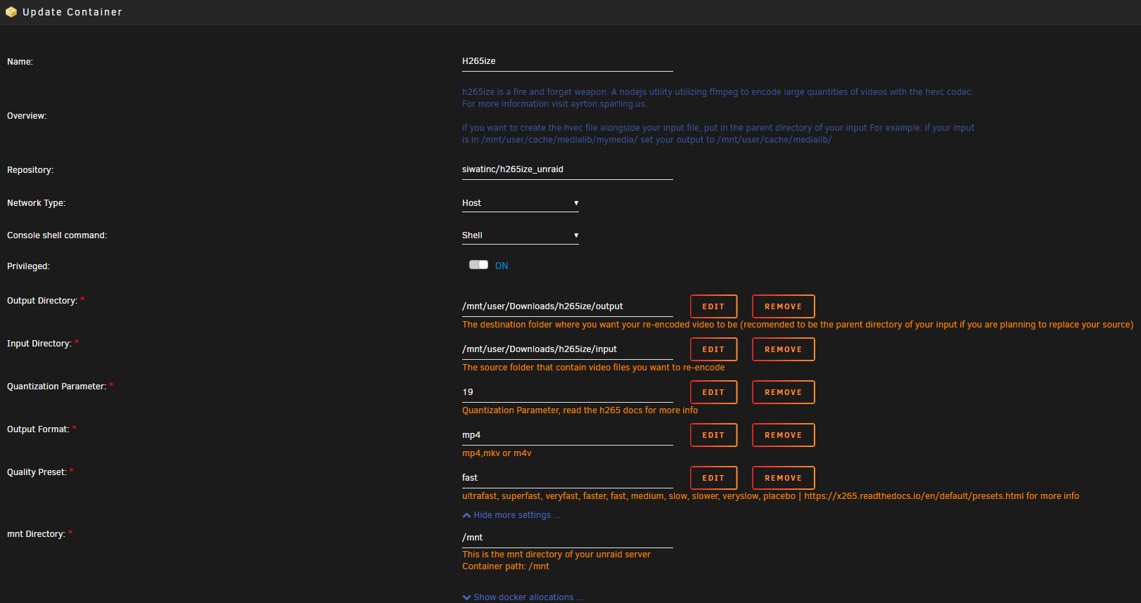

On 12/3/2018 at 11:57 AM, Eggman1414 said:

Can I have a screen shot of your configuration? (the webui container config) and Can you try enabling Privileged mode

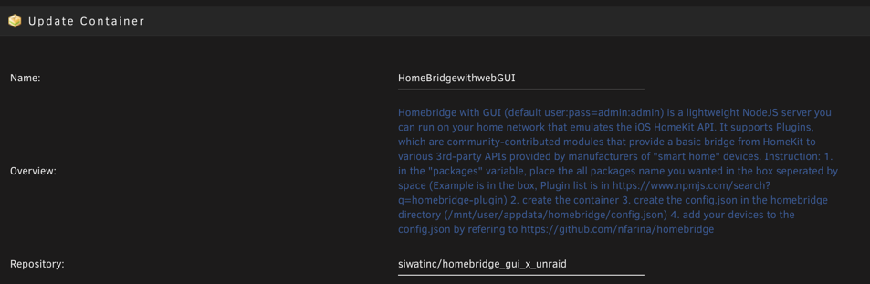

When trying to use the HomeBridge GUI version I'm getting the following error.
root@localhost:# /usr/local/emhttp/plugins/dynamix.docker.manager/scripts/docker run -d --name='HomeBridgewithwebGUI' --net='host' -e TZ="America/Chicago" -e HOST_OS="Unraid" -e 'aptpackages'='ffmpeg' -e 'packages'='homebridge-pilight homebridge-info homebridge-wemo' -v '/mnt/user/appdata/homebridge':'/root/.homebridge':'rw' 'siwatinc/homebridge_gui_x_unraid'
Unable to find image 'siwatinc/homebridge_gui_x_unraid:latest' locally
/usr/bin/docker: Error response from daemon: pull access denied for siwatinc/homebridge_gui_x_unraid, repository does not exist or may require 'docker login'.
See '/usr/bin/docker run --help'.
Is there a login for this repo now? Everything was working.
I have attached the screenshot. Privileged Mode was already enabled.
Can you try it with other files?

2 hours ago, Siwat2545 said:
I migrated to autobuild please download it from the app page again or change the repository to siwatinc/homebridge_gui_unraid
Sent from my Pixel 3 using Tapatalk
I have tried through the app page. I checked the Docker Hub URL and it gets a 404 error.
https://hub.docker.com/r/siwatinc/homebridge_gui_x_unraid/
I then went to https://hub.docker.com/r/siwatinc then clicked to homebridge_gui link and tried again and get the following error.
The command failed.
Edited by ryan8382
Yep here is the error log from the docker screen.
[h265ize]: [verbose] Cleaning up temp files...
[h265ize]: Process exited.
Script done, file is /dev/null
Script started, file is /dev/null
[h265ize]: [verbose] Handling keypresses...
[h265ize]: [verbose] Setting as-preset options...
[h265ize]: [verbose] Folder encoding started at Friday, December 7th 2018, 3:09:34 AM
[h265ize]: Processing Titans (2018) - 1x01 - Titans.mkv...
[h265ize]: [verbose] Encoding started at Fri, 3:09 AM
[h265ize]: [verbose] Getting metadata...
[h265ize]: [verbose] Resolving video streams...
[h265ize]: [verbose] Upconverting...
[h265ize]: [verbose] Setting video bit depth...
[h265ize]: [verbose] Mapping streams...
[h265ize]: [alert] Audio does not have a title. Title set to "English AAC LC (Stereo)".
[h265ize]: English
[h265ize]: [verbose] Detecting auto crop...
[h265ize]: Crop Detection: 1/12
[1000D[1A[2K[h265ize]: Crop Detection: 2/12
[1000D[1A[2K[h265ize]: Crop Detection: 3/12
[1000D[1A[2K[h265ize]: Crop Detection: 4/12
[1000D[1A[2K[h265ize]: Crop Detection: 5/12
[1000D[1A[2K[h265ize]: Crop Detection: 6/12
[1000D[1A[2K[h265ize]: Crop Detection: 7/12
[1000D[1A[2K[h265ize]: Crop Detection: 8/12
[1000D[1A[2K[h265ize]: Crop Detection: 9/12
[1000D[1A[2K[h265ize]: Crop Detection: 10/12
[1000D[1A[2K[h265ize]: Crop Detection: 11/12
[1000D[1A[2K[h265ize]: Crop Detection: 12/12
[h265ize]: [alert] Output will be cropped to 1920x960. Originally 1920x1080
[h265ize]: [verbose] Mapping HE Audio streams...
[h265ize]: [verbose] Setting ffmpeg settings...
[h265ize]: [verbose] Encoding video...
[h265ize]: ffmpeg exited with code 1: Could not write header for output file #0 (incorrect codec parameters ?): Invalid argument
Error initializing output stream 0:0 --
encoded 0 frames
Conversion failed!
[h265ize]: [verbose] Finished encoding at Fri, 3:09 AM (a few seconds)
[h265ize]: Folder encoding finished at Friday, December 7th 2018, 3:09:37 AM
[h265ize]: [alert] The following videos (1) were not encoded:
- /mnt/user/Downloads/h265ize/input/Titans (2018) - 1x01 - Titans.mkv: ffmpeg exited with code 1: Could not write header for output file #0 (incorrect codec parameters ?): Invalid argument
encoded 0 frames
Conversion failed!
encoded 0 frames
Conversion failed!
encoded 0 frames
Conversion failed!
What is the codec of your source file?
9 hours ago, jbrown705 said:
change it to "siwatinc/homebridge_gui_unraid" as I already deleted "homebridge_gui_x_unraid"
Edited by Siwat2545
I had the upgrade issue for HomeBridge with GUI, so I updated the repository and was able to get the latest version.  However, after updating it crashes pretty quickly, with the error "Error: The requested accessory 'Chamberlain' was not registered by any plugin.".  My garage door was working fine before the update...could something have deleted my settings?
Solved by removing the accessory from the config.json file in a text editor, then i was able to get HomeBridge running to the GUI.  I reinstalled the plugin and it worked again.  Odd that my plugin was removed during the update...it was likely due to the failed update to the non-existent repository.
This appears to have fixed it.  I don't know if I will get any errors when prompted for an upgrade, but I'll report back if I do.  Thanks for your help!
-Jason
The you need to change your repository in the docker advanced view
The command failed.
You need to update the templates to reflect the change
Sent via telekinesis
I already updated my template to use the new repository, but the user who already installed it aren't having the new repository updated to replace their old one.
edit: ohhh I updated the alpha branch sorry everyone, changing it now
Edited by Siwat2545
This is a snip from VLC.
H264 Video and AAC Audio
Can you try wrapping the I/O field with ' (putting ' around the text in the input and output field)
Also can you send me a link to your media in pm
