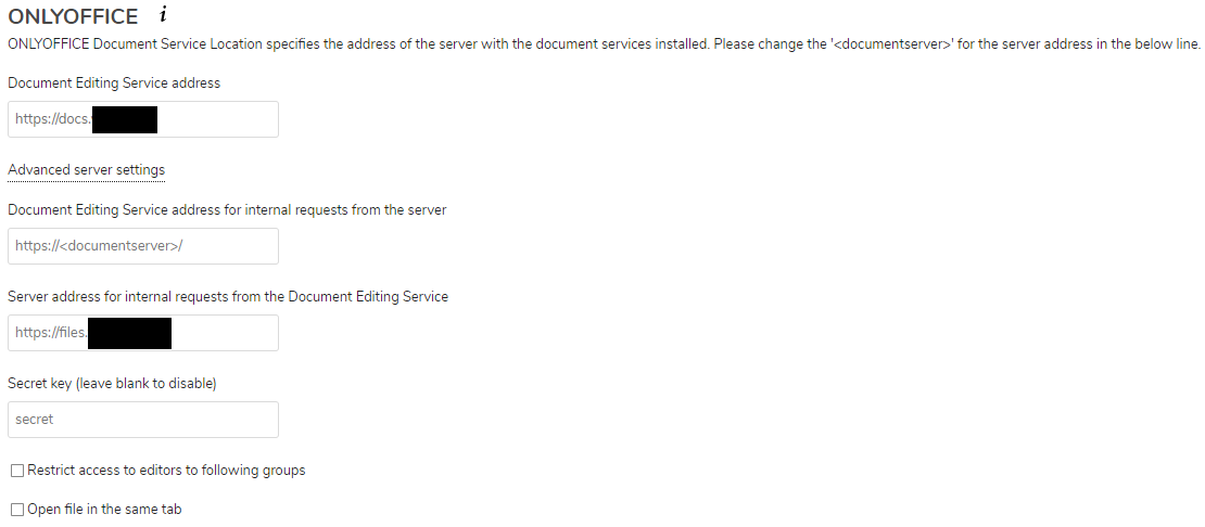

I installed "onlyoffice" app in the NextCloud UI, and I'm confused as to what should go here: image.thumb.png.2265fcd043b771a61bbef85996d45035.png
I tried to port forward the docs server, but I'm not sure if I did it correctly.  If you have an example proxy.conf (or just the nginx config for onlyoffice) that would help me double check.
Are these supposed to be my internal IP addresses? Or should they be the public-facing web addresses?
Or is this not  the way I'm supposed to configure the integration between NextCloud and OnlyOffice?
Onlyoffice must be exposed to the public address, if your nextcloud use https, onlyoffice must also have https, all field must be point to your document server
When you say onlyoffice must also have https, is it sufficient to have it behind the same reverse proxy (i.e. letsencrypt container) or do I need to set up https in the onlyoffice config itself?  I didn't see any sample proxy config files for onlyoffice in the letsencrypt container, so I made a basic one, but it's not working - is there any trick to getting it working?
Also, I keep seeing references to running "set_configuration.sh" bash script in other guides - do you need to do that here?
You need to set https in onlyoffice itself then you can proxy it through nginx because if you do not set up https in onlyoffice, onlyoffice will rewrite https to http and that will fail

Apologies for bugging you about this, I'm just trying to get this set up, and there's no rush as I'm sure you're still busy.  I don't know if the issue is my reverse proxy config, which is based off of how I saw how the other containers were connecting:
# only office doc server
server {
    listen 443 ssl;
    listen [::]:443 ssl;
    server_name docs.*;
    include /config/nginx/ssl.conf;
    client_max_body_size 0;
    location / {
        include /config/nginx/proxy.conf;
        resolver 127.0.0.11 valid=30s;
        set $upstream_docs OnlyofficeDocumentServer;
        proxy_pass http://$upstream_docs:443;
or some issue with the config of the OnlyOfficeDocumentServer config.
When I access via the internal IP, I get a Cert error for both the http (tells me my certs are only for my sub-domains) and https (shows as "self-signed") WebUIs URLs, but I can add an exception and get to the page.  When I attempt to access the docs server via the external subdomain, I get a 502 error (I'm not sure what I'm supposed to get - perhaps a "document server is running" page?).
Any advice? Is there a better example of how I should be proxying the doc server?
