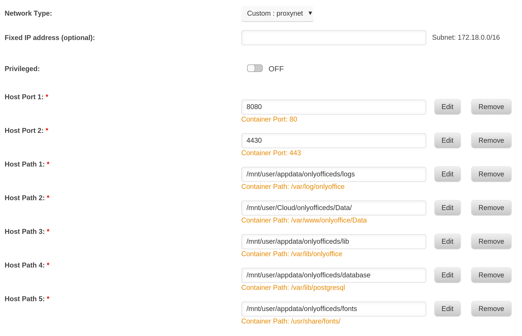

This is what I have on OnlyOffice Document Server: (see attached file)

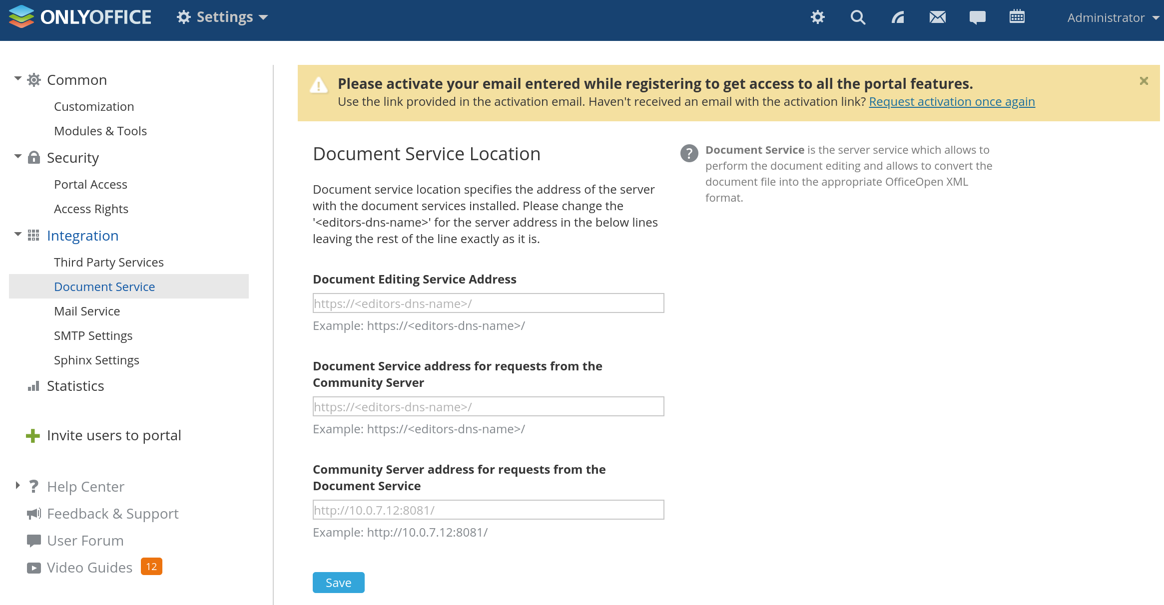

Also, I installed the OnlyOffice Community Server and what exactly goes to the Document Editing Service AddressDocument Service address for requests from the Community Server and Community Server address for requests from the Document Service fields?
When I opened the Document Server webUI, I get the page "cannot get /"

You actually need to proxy pass it to port 4430 if you are using the ssl certificate, both documents server and community server need to be proxypassed to using ssl port (4430 And 4431 respectively)
