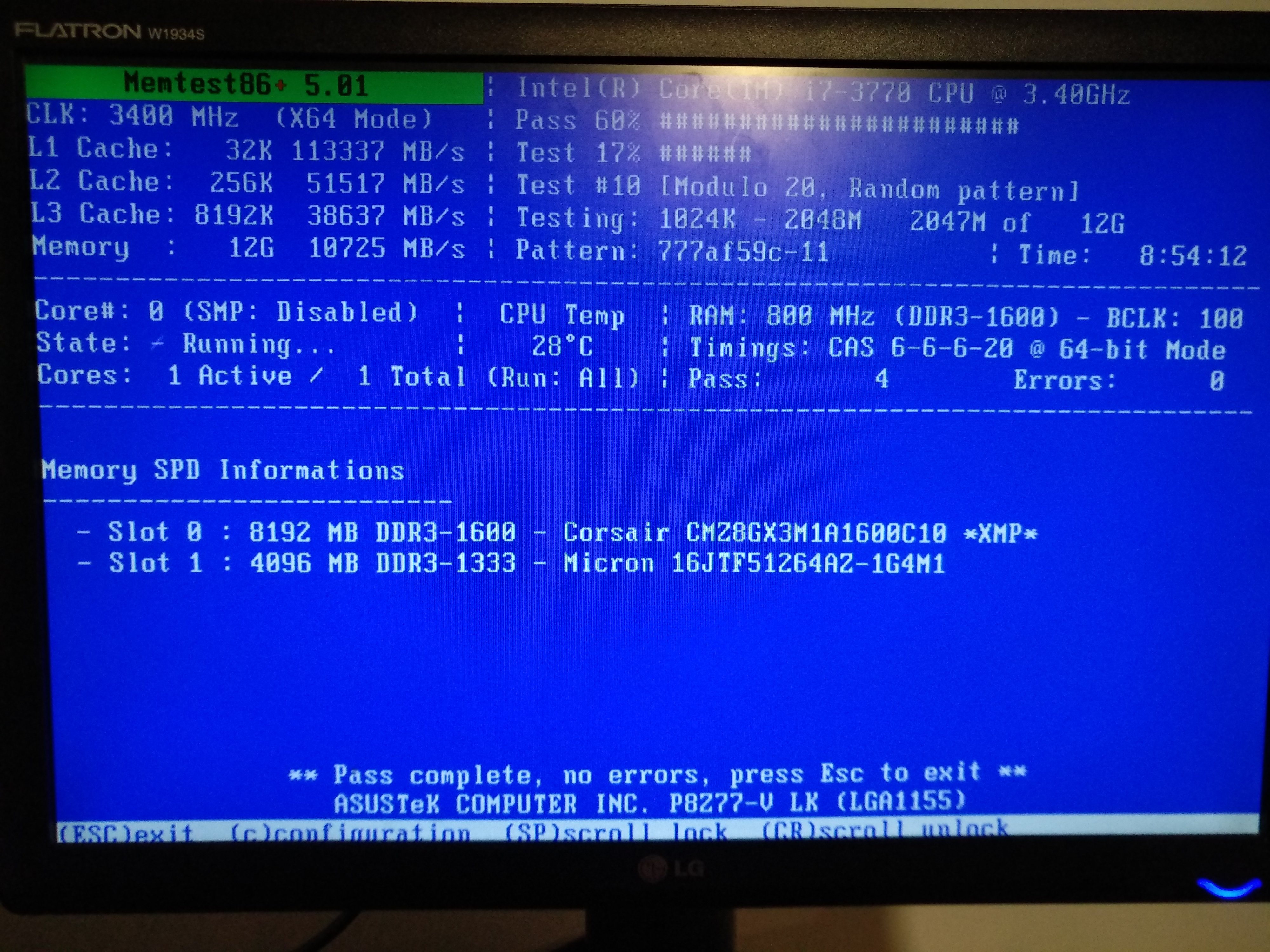

Hopefully I'm running the right memtest, pic of the run after 8 hr's is attached. It doesn't look like anything's failing though I am not fully certain that I know what I'm looking at. Note the ram modules are set at different frequency's. I went into the bios and manually set the frequency to 1333 now.
If this memtest is indeed ok, what should be my next troubleshooting steps?
Seeing that mismatched pair of DIMMs made me cringe! It might be ok but I'd try running with just one of them for a while, or replace with a matching pair.
