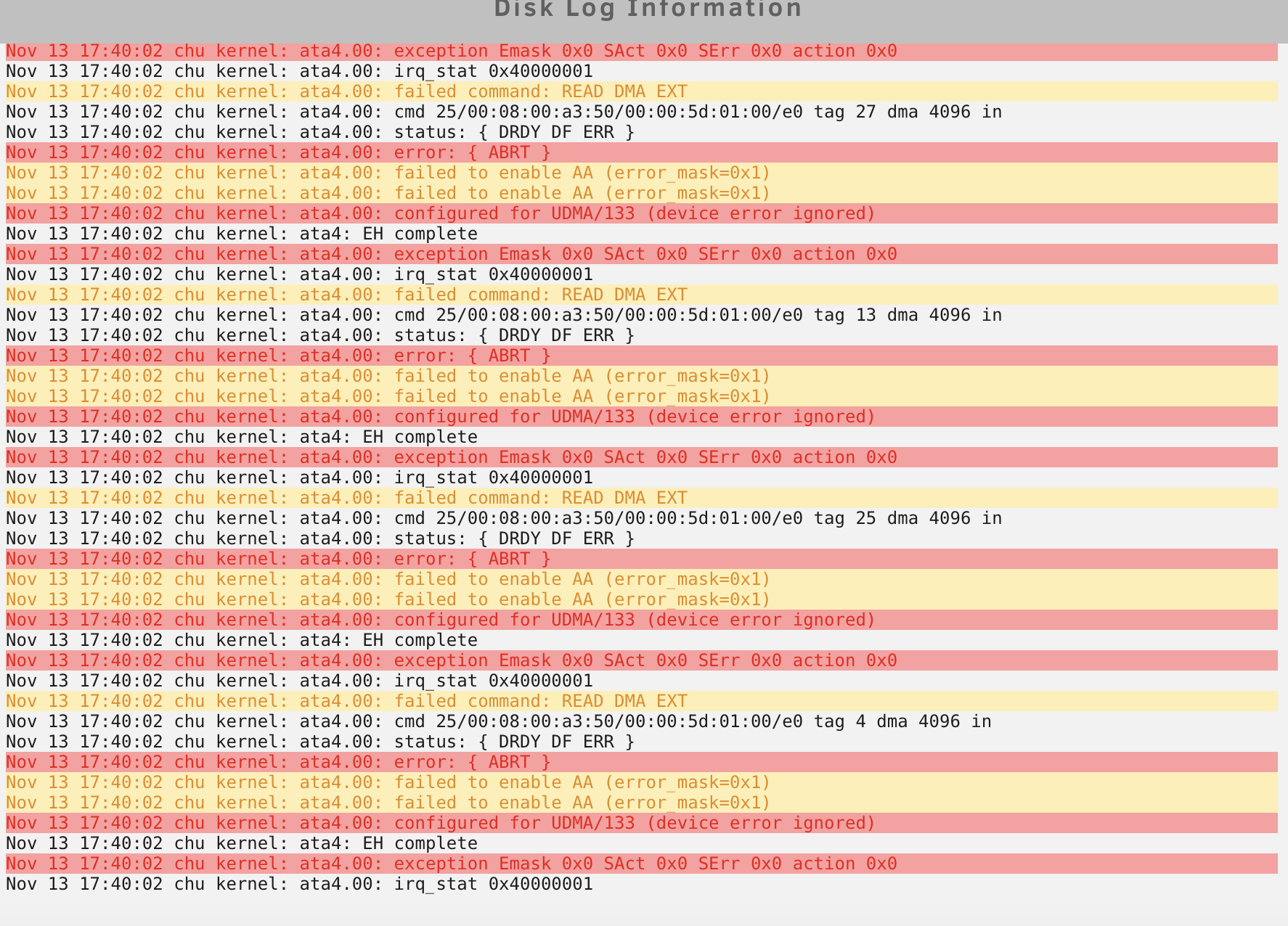

Can I request some help in reading why a drive that was newly replaced failed again after only a few days

After swapping the sata cable with another working drive (to isolate), I powered on the nas.  I stopped the array, and selected no device in it's place.  The drive was delegated to unassigned.  I started the array.  I stopped the array once again, tried to select the drive and reassign it back in it's place without formatting or preclearing the drive.  I cannot reassign it since it's not in the selection.  Instead, I get this error message when I click on disk log information under unassigned drives, I captured it in screenshot.

You should also replace/swap the power cable, if still issues then it's likely the disk despite the healthy looking SMART.
noted.  For a second, the drive was assignable under it's old position, disk5.  In a few seconds, it vanished, and was not even seen on unassigned drive.  Will try swap the power cable with the same drive where I got the sata cable from.  If the problem transferred there, it should be power cable issue.  If it stayed with this drive, then it's the drive's problem.
Do I need to preclear or format, or delete it's existing partition when I temporarily assign it to unassigned drive?  Not that I want to, but want to make sure when I reassign it to the array, it will start rebuilding.

So, the power cable where the drive was having problems, I moved it to a working drive, and now, the working drive is missing.  I guess that's it.  Thanks @johnnie.black
