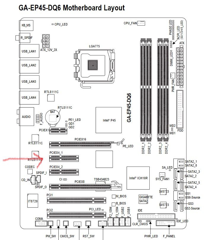

I connected the adapter card to one of the PCIEx4 slots on the motherboard, connected a hard drive to it, and boot up stopped when it read the hard drive connected to the adapter card and wouldn't continue to boot all the way up to Windows.  I disconnected the hard drive and tried several others and the same thing happened.  The hard drives are good.  They work when I have them connected to ports on the motherboard.

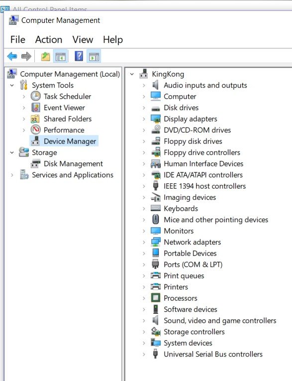

My system (DOS?) recognizes the adapter card at boot but when I disconnect the hard drive connected to it and boot to Windows, it's not listed in Device Manager.

In Device Manager > IDE ATA/ATAPI controllers > Standard SATA AHCI Controllers, it says that the best drivers for your device are already installed.
The adapter card isn't listed in Device Manager.
I have the card seated in the PCIeX4 slot of my motherboard.

EDIT:  I unzipped SI-PEX40071.  It says at the website that it's for Windows 7, 8, 10 but the options it offers is for 1. Widows 2003_XP and 2. Windows Vista_2008_7_8.  It doesn't contain a driver for Windows 10.

Can you try a different slot? Maybe the 16x or 8x slot?
Edited by whipdancer
The 16x slot is only for video cards.  I just tried the 8x slot and it did the same thing, plus my network connection was lost until I shut down, removed the card, and booted back up.  I don't know why it did that.
I can't find anything that designates the 16x slot as video card only.
According to the specification page for your motherboard the 4x slots are not designated as PCI-E 2.0 compliant.
The 16x slot and 8x slot are supposed to be 2.0 compliant.

I have only one x16 slot and I need it for the video card.
