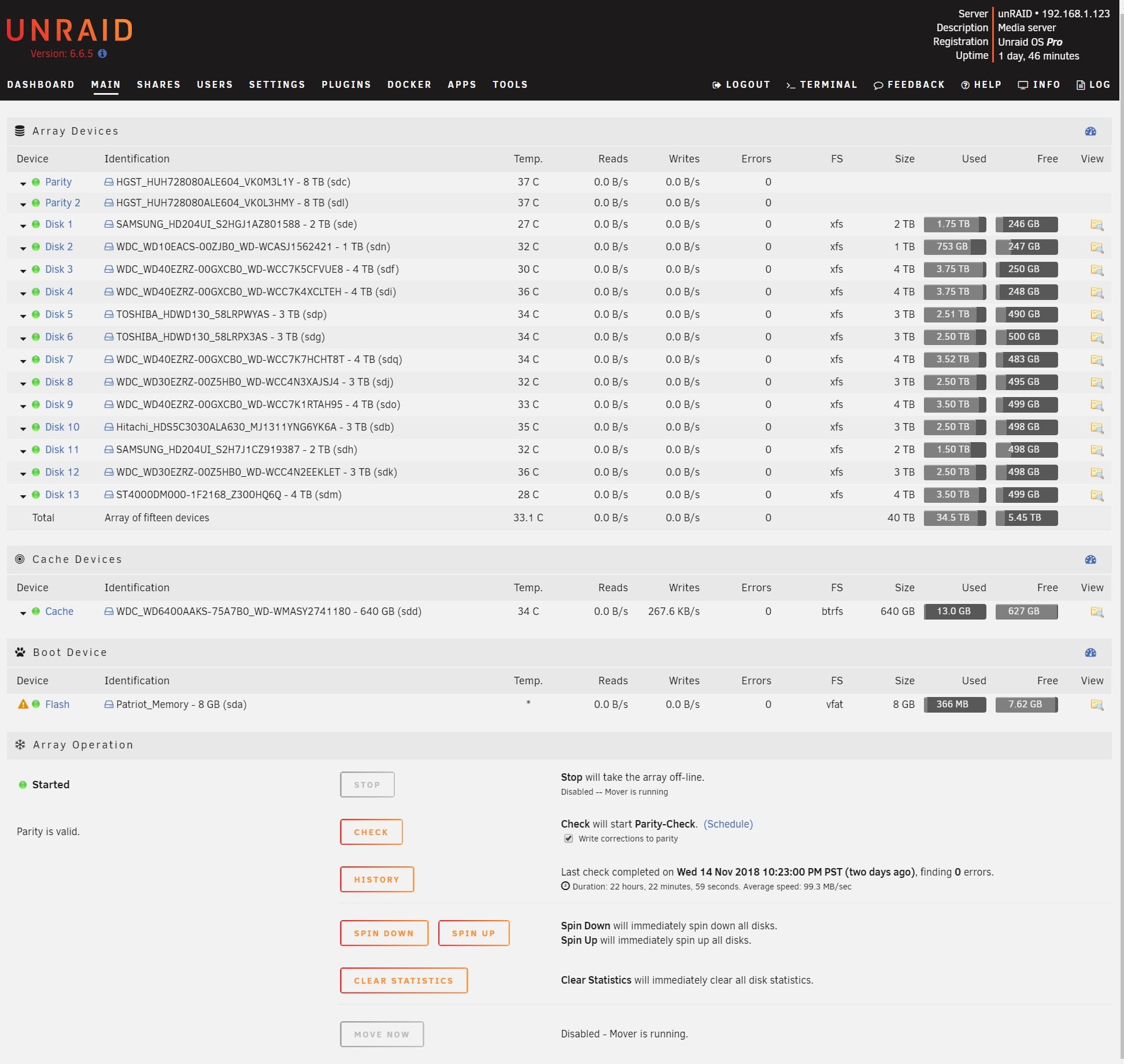

Ok, has this OS gone full retard?  It's doing it again.
Johnnie, yeah there was only one.
So... last night after I thought it was fixed and the Mover was done I moved around 3-400gb of files around which were already on the server, some may have been on the cache disk - I can't be sure - and it seemed ok.  Then I copied around 200gb to the server and went to bed.  The cache disk is a 640gb drive.  Now it is doing this BS again somehow.
'Close all notifications'... yeah right.  It just took me literally 35 minutes of clicking that to close all the dumb notifications so I could take the screenshot below.  It seems Disk4 is near full too and unraid seems bent on jamming it with more.  Is there some other dumb thing going on here that has been causing all this?  It seems like everything, stuff already on the server even, is being run through the cache disk when moved around between shares...?

In that screenshot it shows docker service is still enabled. When docker service is disabled, there will no longer be a docker item on the main GUI.
Do you want the system share and appdata share on the array or the cache drive? Are they set to cache:prefer?
I need Docker for CrashplanPro and Plex.  Have I missed something where I have to now choose between Docker and cache functionality?
