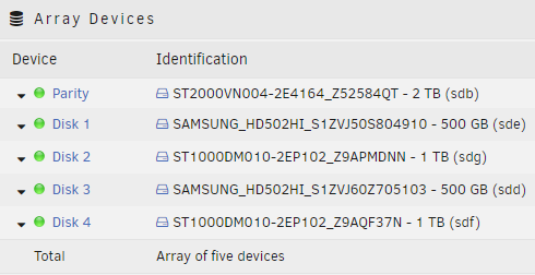

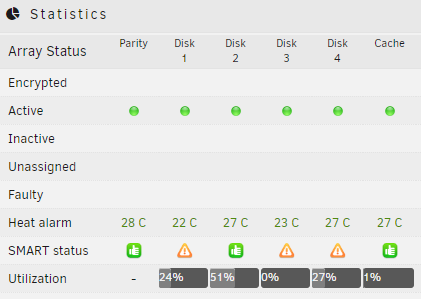

Please, consider this situation:
image.png.e74102ba0bccce92dc96115cad81e89f.png image.png.9ddc09a429957417c5eb350d608629f6.png
To be safe, should I replace the 500GB disks + 1TB disk (smart issues) with one 2TB, or should I add the 2TB Disk as a second parity disk?
Note: I just can afford one 2TB disk.
Thanks in advance!
Eduardo
With only 4 data drives, my opinion is that 2 parity drives isn't of that much value.  I'd replace the 1x500 for sure, debateable if you'd also want to replace the other 500 and the 1TB.
Not a super straightforward procedure to replace multiple drives simultaneously, but its not particularly complicated.  Just ask for help when you're ready to go.

Should post your free storage? You could move data off the 500gb then replace a different drive.
Sent from my Pixel 2 XL using Tapatalk
From the picture posted in the OP, I see about 1TB used. He could easily ditch the bad drives and still have plenty of free space, even without buying a new drive right now.
@EDalcin, I would seriously consider moving the data to the healthy drives and just removing all the questionable ones. It's not worth the headache trying to keep up with marginal drives playing russian roulette with which drive failure is going to cause data loss.
[mention=83556]EDalcin[/mention], I would seriously consider moving the data to the healthy drives and just removing all the questionable ones. It's not worth the headache trying to keep up with marginal drives playing russian roulette with which drive failure is going to cause data loss.
