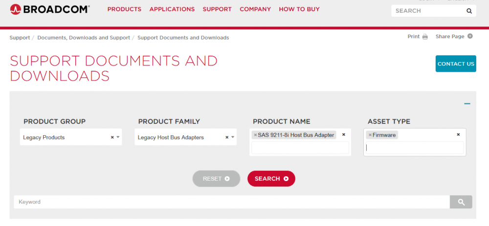

You can find it on Broadcom's support site, under legacy

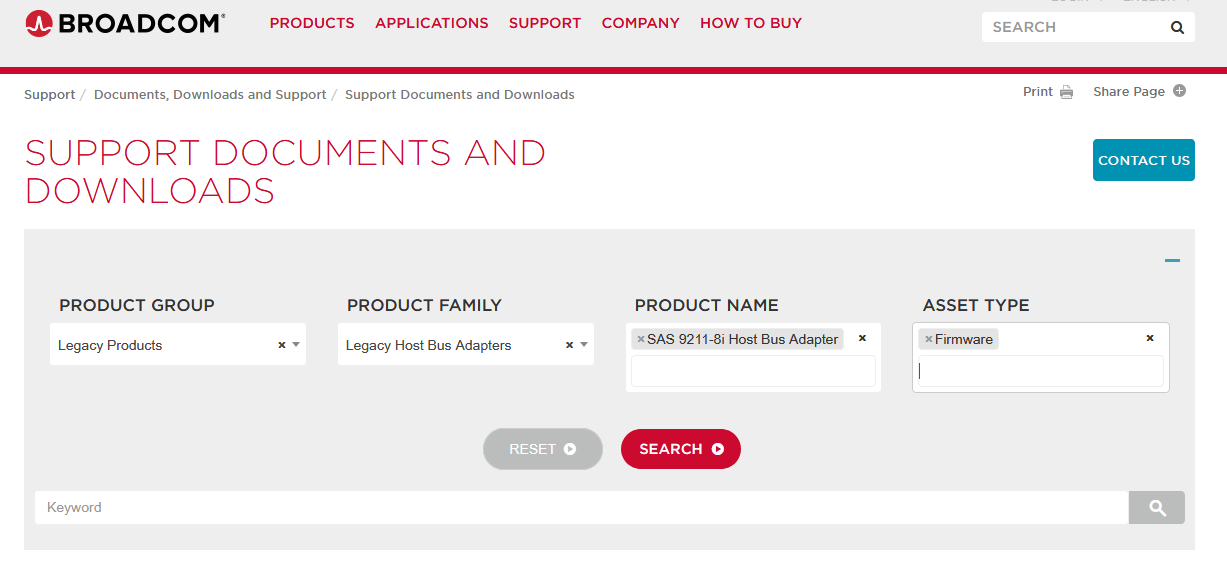

picture attached upload not working on the phone. I will do it in a sec.
Picture link: https://imgur.com/a/jQuXHd6
Edited by DJay
removed pic again. replaced by link.
46 minutes ago, DJay said:
Hi again,
i was searching for a new FW quite a while.
Unfortunately I don't find any new one for a LSI SAS2008
LSI SAS2008 is the controller chipset.  It is used on many HBAs from many manufacturers, such as LSI 9210-8i/9211-8i, IBM M2015, Dell Perc H200/H310 and others.
You should look for the latest firmware for your make and model of HBA.
Your motherboard manual will be no help since the HBA is a PCIe add-in card.  Your cache drive(s) are apparently connected to it.  What is it?
As @johnnie.black mentioned, you need to search for legacy drivers on on the Broadcom site.  For example I found the 9211-8i 20.00.07.00 firmware there.
The 20.00.07.00 firmware is available for flashing in Windows or DOS
20.00.00.00 firmware is available for installation via UEFI, Linux and various other OSes
You want to make sure you are flashing in IT mode.
IT mode firmware flashing instructions are available in these forums and various other websites.
I am sorry for all this questions, this is all very new to me.
So what confuses me is this: "You should look for the latest firmware for your make and model of HBA."
I am reading in parallel these two threads, just to understand a bit more:
https://wiki.unraid.net/index.php/Crossflashing_Controllers#Tools
But I still feel puzzled. This means, I can just download the "unbranded" broadcom FW and flash it to my SAS2008 chipset.
Correct?
