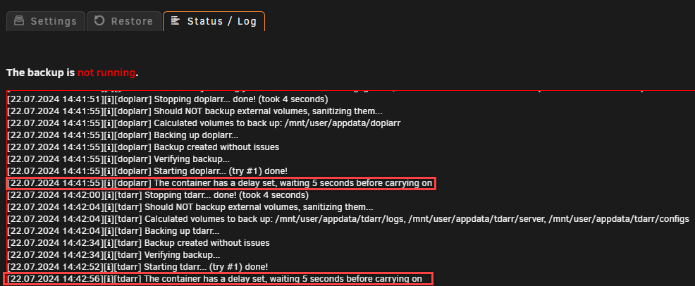

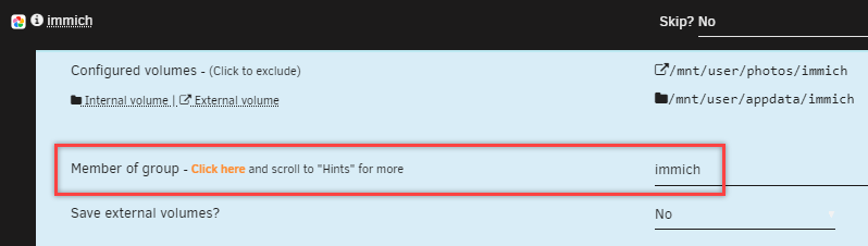

July 24, 20242 yr On 1/24/2024 at 9:24 PM, knights_of_pine said: is this the same way to delay a docker from starting up after the plugin AppData backup runs? i have a docker of JellyStats and it really does not like starting until Jellyfin is started and running for at least like 2 minutes. Right now Jellystat just tries to stop then dies and have to manually start it. thank you for the help! Correct, the Wait/Delay set in the Docker tab is utilized by the Backup/Restore Appdata plugin as well. You can verify this in the logs (see below). Also - groups can be defined in the Backup/Restore Appdata plugin to ensure container dependencies are cared for (discovered this recently). Which can be set by clicking on the docker container when on the settings tab of the Backup/Restore Appdata plugin. Just set the Member of group to the same value for all related docker containers and save (then they will show up like my immich ones above). Edited July 24, 20242 yr by groot-stuff
